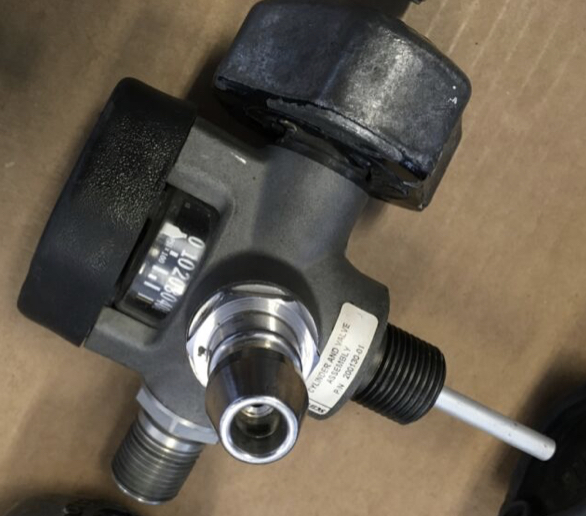

Hi, I just purchased a used 60 min Scott SCBA tank with 2 years left....very good price. It comes with an NxG2 valve with a quick disconnect. My question is this: Does the valve use DIN300 G5/8 standard fittings? If not, what type of connection is this? I would like to remove the quick disconnect and connect up a fill station.

Option 1: Determine the native Female fitting, If its DIN300 (G5/8) I can just direct connect up a fill station...If anyone knows let me know.
Option 2: Remove the quick connect adapter and turn it in my lathe to have a 1/4 NPT fitting, and get 1/4 to CGA347 Adapter
Option 3: Your path, order a standard valve with DIN300 output fitting.

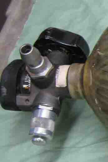

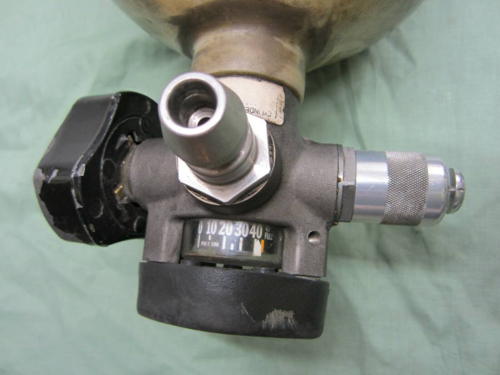

Like your tank, attached to mine is a NXG2 gauge/valve.
I'm hoping you found a solution to what type of attachments can be hooked up to it to fill your air guns and you'll share that info with me (and interested others).
OF CONCERN TO ME: is the "Snap/Change" nipple/probe—I know it was designed to connect the air breathing apparatus that firefighters use, but for filling airguns, that nipple/probe looks problematic.
Any suggestions of types of connections that you found for this type of valve/gauge (or any knowledge) you can impart on me would be greatly appreciated.

In regards to the NXG2 valve (and using it to fill an air gun or connecting it to a compressor) I'm not sure how the quick release nipple works.
Yes, there is a connection (on the NXG2 valve) with threads in which a CGA 347 valve can be connected. That still still doesn't answer how ( the quick release nipple) would work in conjunction with all of it.
In my opinion, nipple on the NXG2 valve should be unscrewed and a plug inserted (so no air could not get in or out).
Since I'm unsure about all of it, I decided to chuck the NXG2 valve all together.
