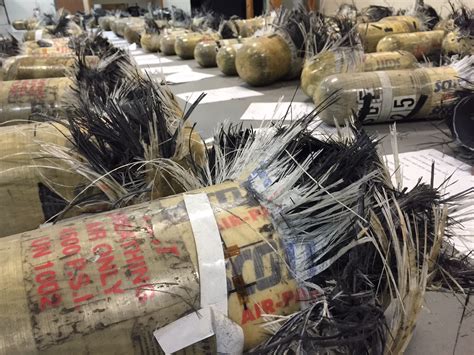

I don't like people showing a tank that was intentionally damaged and then grossly overpressurized and pretending that is a reason to only use hydro tested tanks. Not honest at all. Unless a tank showed no visible sign of damage and failed at 300 bar or less, I don't care what the picture looks like. I don't think such pictures exist. It could happen, however, if enough moisture got into the tank. But I am pretty confident it still wouldn't be ripped apart, it just would have a leak. Might not even show damage. The carbon fiber will not hold air. If the aluminum liner gets a hole it will leak. Probably slowly and a picture would be quite boring.

Well it's not like micro cracks are going to stick out and say here i am ..lol
My thing is is it worth the risk that one day at 3000+ psi it cuts loose and takes out you standing there or anything in proximity? .. not me id prefer to just go with a tank that can be hydroed / us dot and filled at any shop if needed .
Then some feel it's well worth the risk .. idk. Just hope i aint standing there when it bursts.. ouch.
