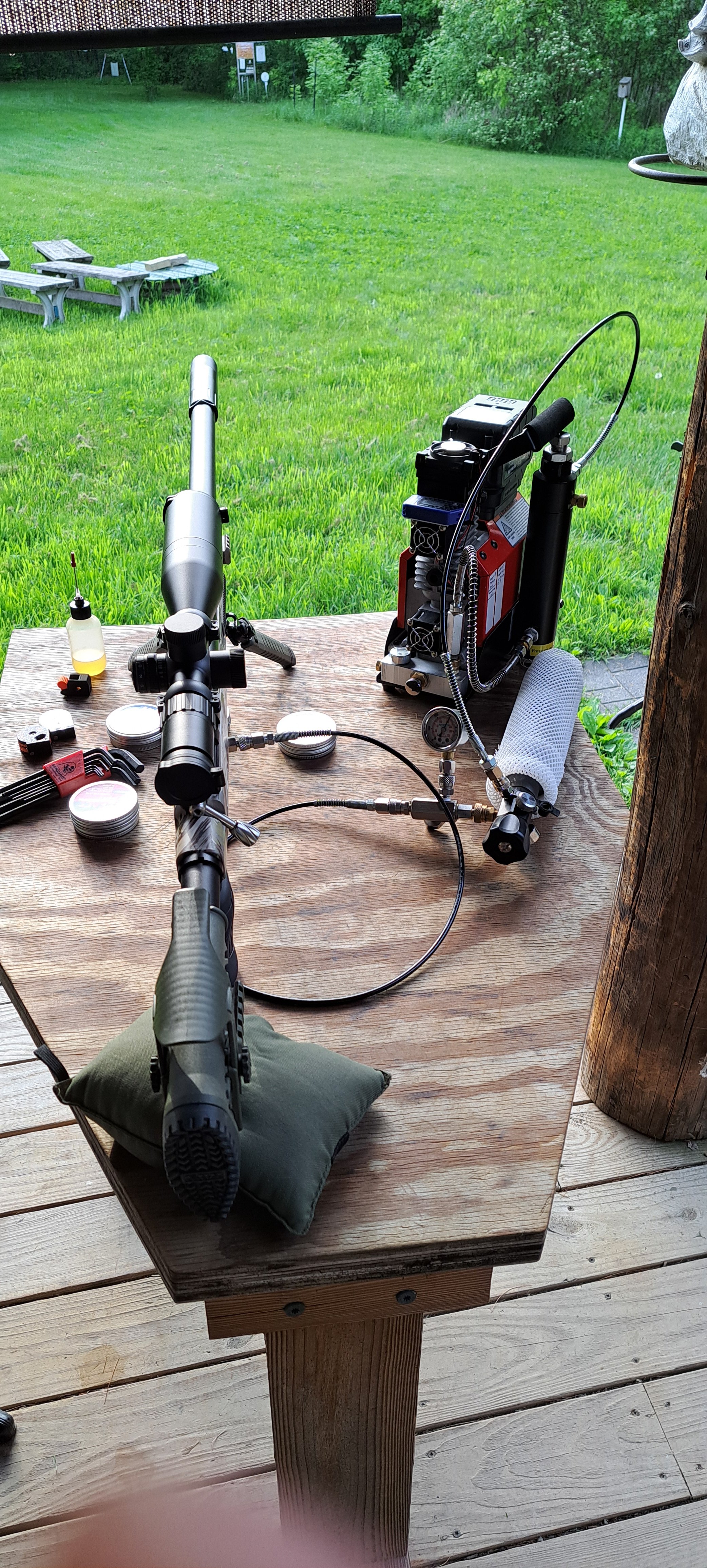

I tether to the compressor and a .48l bottle.
After tons of shots, it takes 8 minutes to get the gun and bottle back to 250bar when shooting my 250z. There is a check valve on the filter inlet, to isolate the compressor from the rest of the train. Filter stays pressurized...

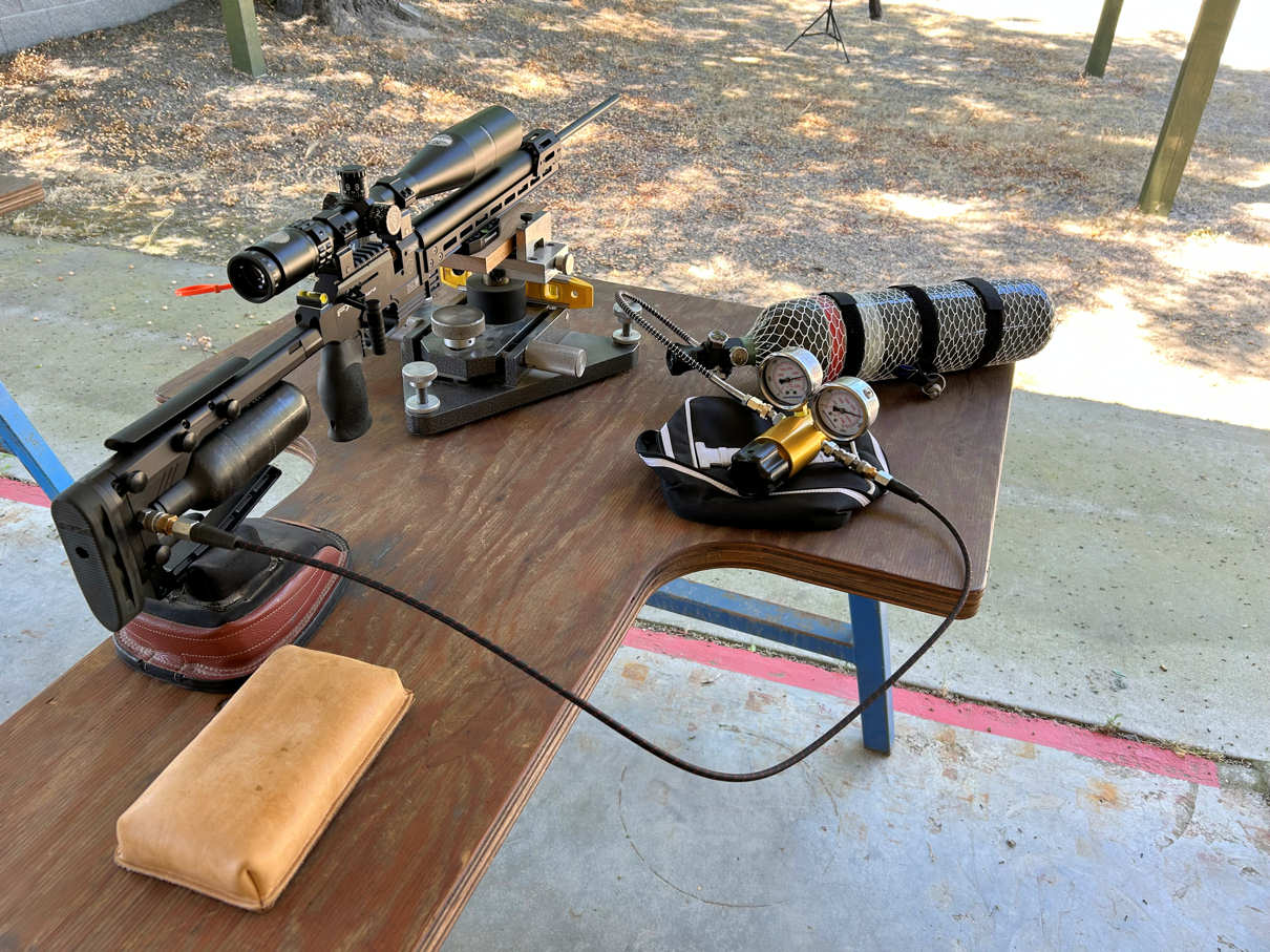

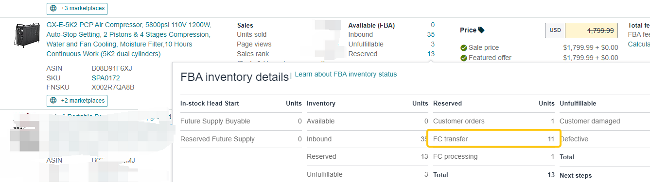

They should have a nice shipment soon. They sent me this recently:
