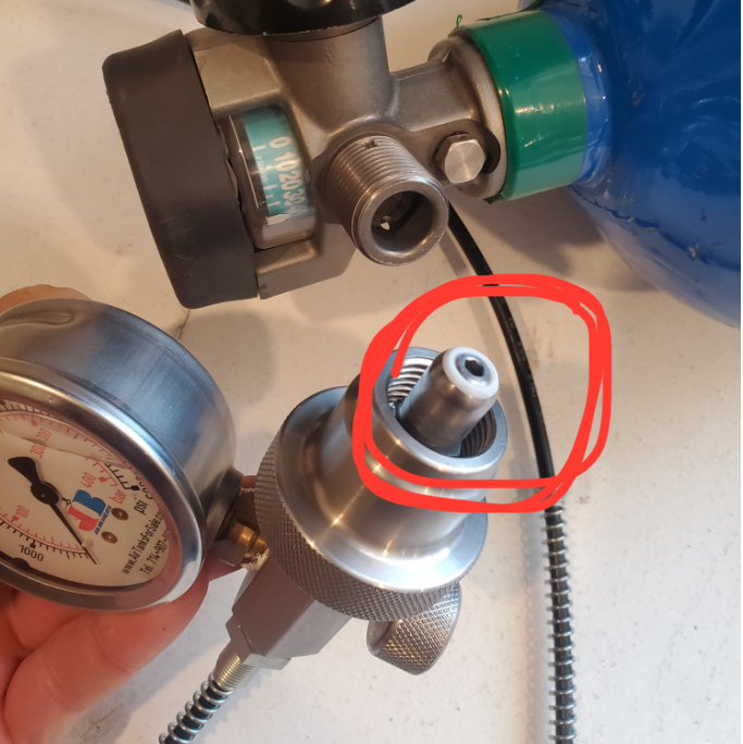

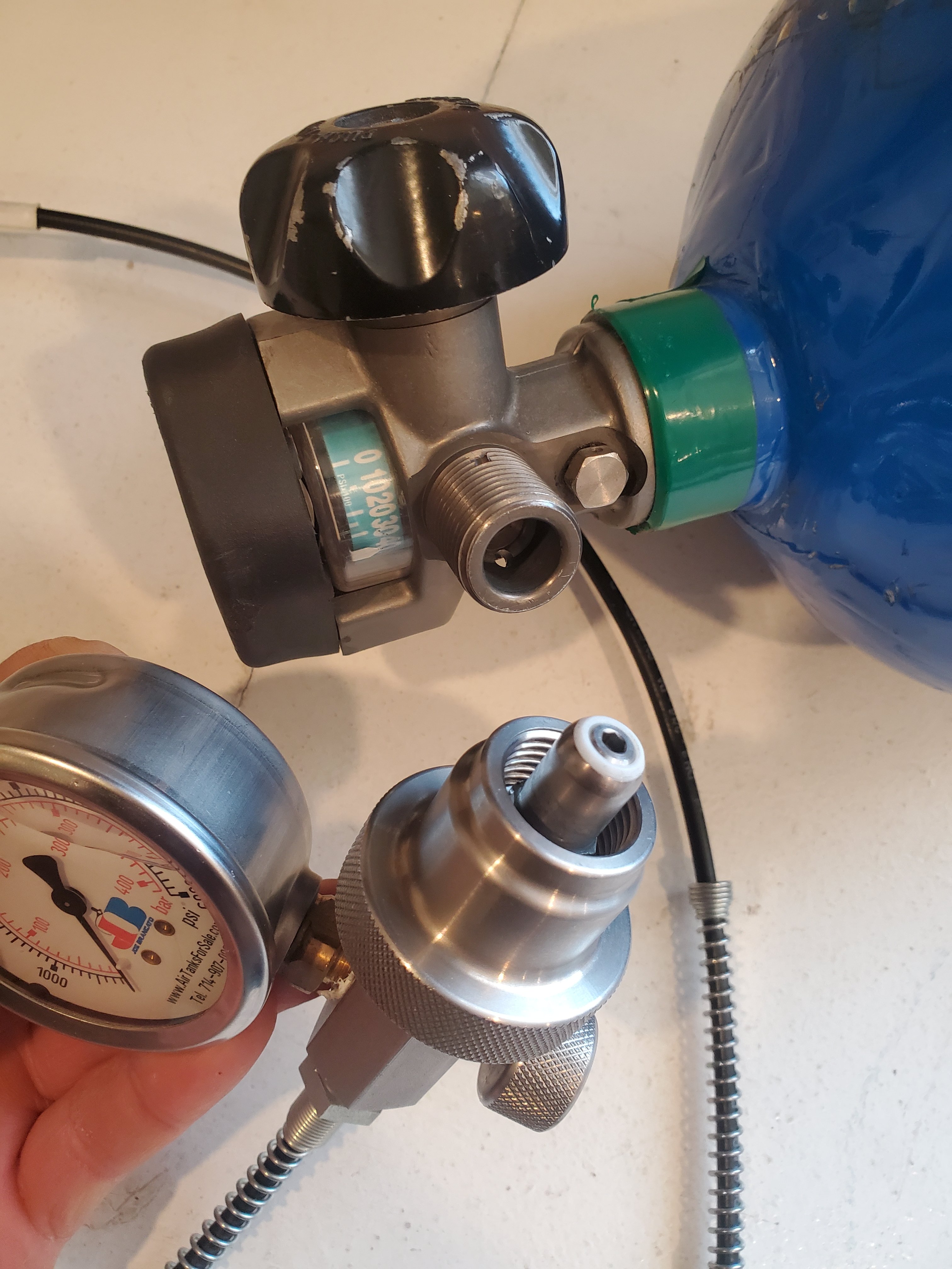

This is my fill setup and I'm leaking at the tank connection, is the problem that white washer and where can I find a replacement? Thanks Steve.
I suppose it’s possible there’s a nick in the seat inside your tank valve, so you might take a peak into it with a flashlight. If it’s nicked you would need a new valve. Hopefully it’s just the teflon nipple is damaged, although what’s able to be seen in your photo, it looks pretty good. But the photo doesn’t show 360° of nipple.
Hopefully Brancato sells replacement teflon nipple because his replacement nut and nipple is $89. I saw one that “looks” identical on ebay for $26.
