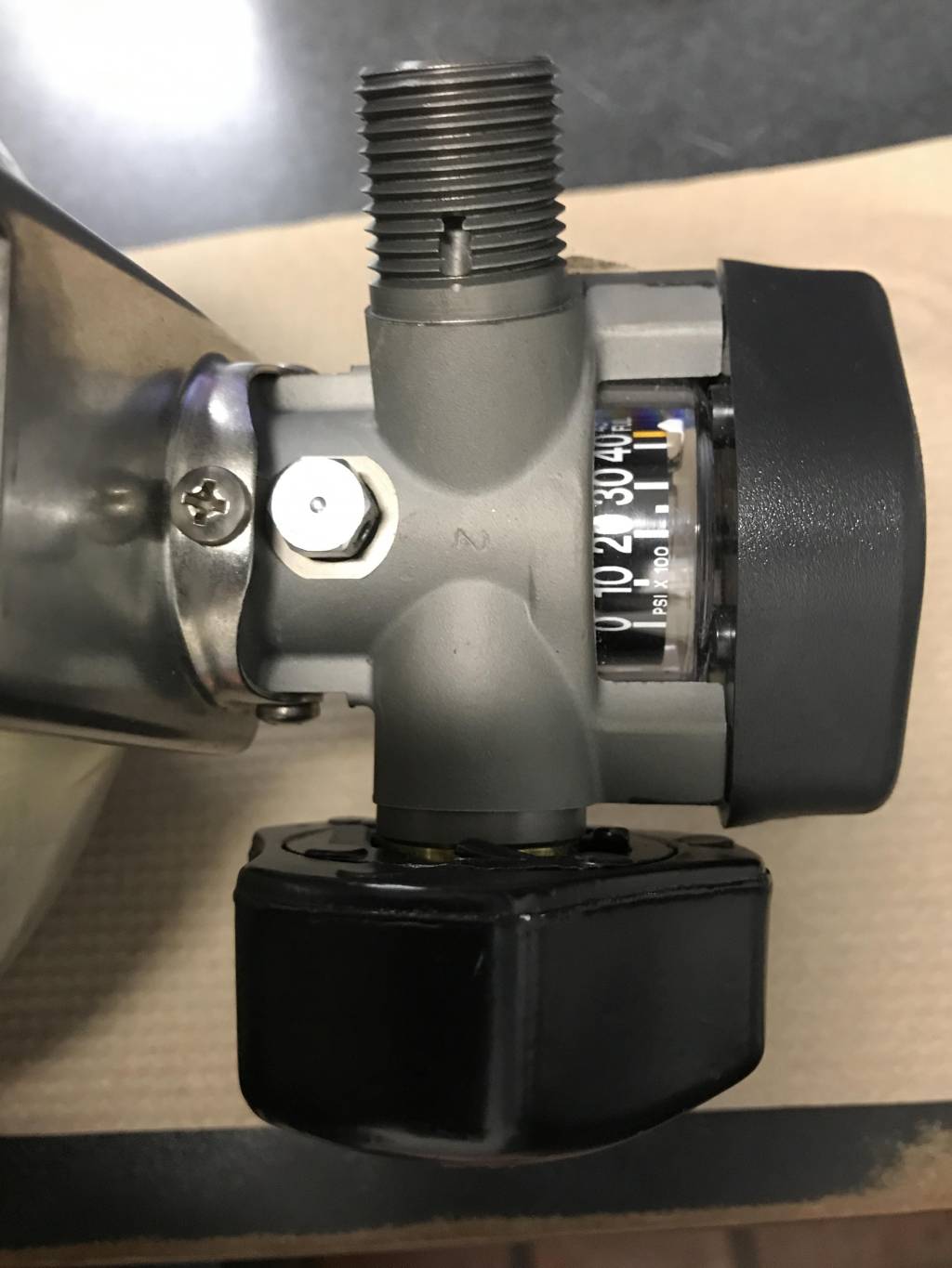

I have access to 6 scba 4500psi tanks but need a coupling to enable me to use these for filling my airguns if possible? I do not want to replace valve because they are already filled and will be destroyed at end of yr.

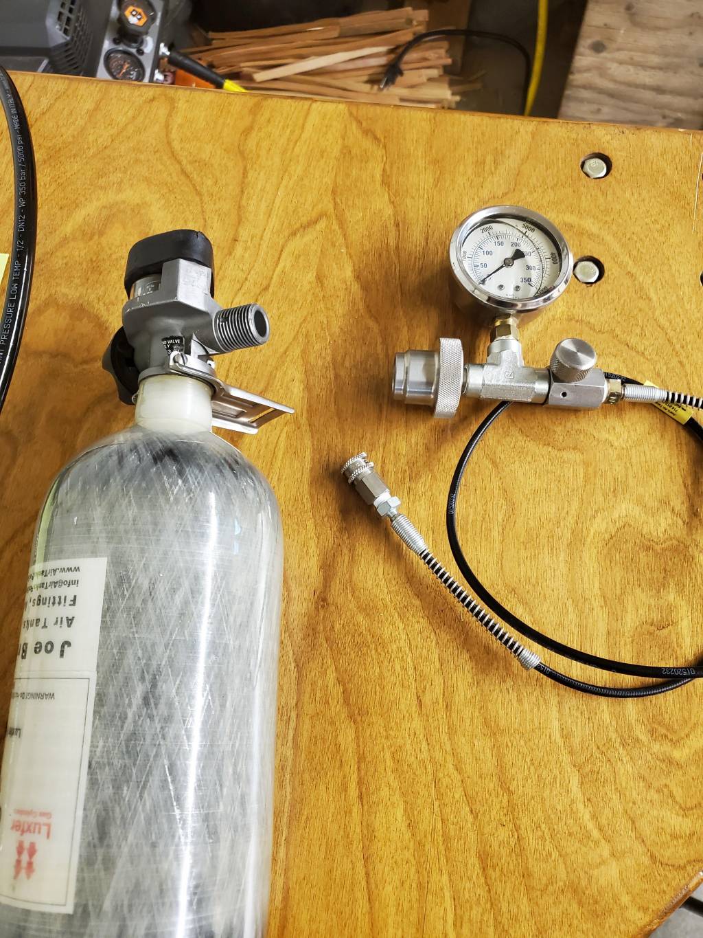

Here's my set up,
SCBA HOSE ASSEMBLY
This set up can be found on Joe Brancato's site: Air Tanks For Sale.
Edit: As for Safety Measures:
If you decide to make up your own set up just beware your filling from a 4500 psi vessel and all parts used should be of the same psi rating or greater.
Edit was not directed to you personally but to anyone new to this sport/hobby
Cheers

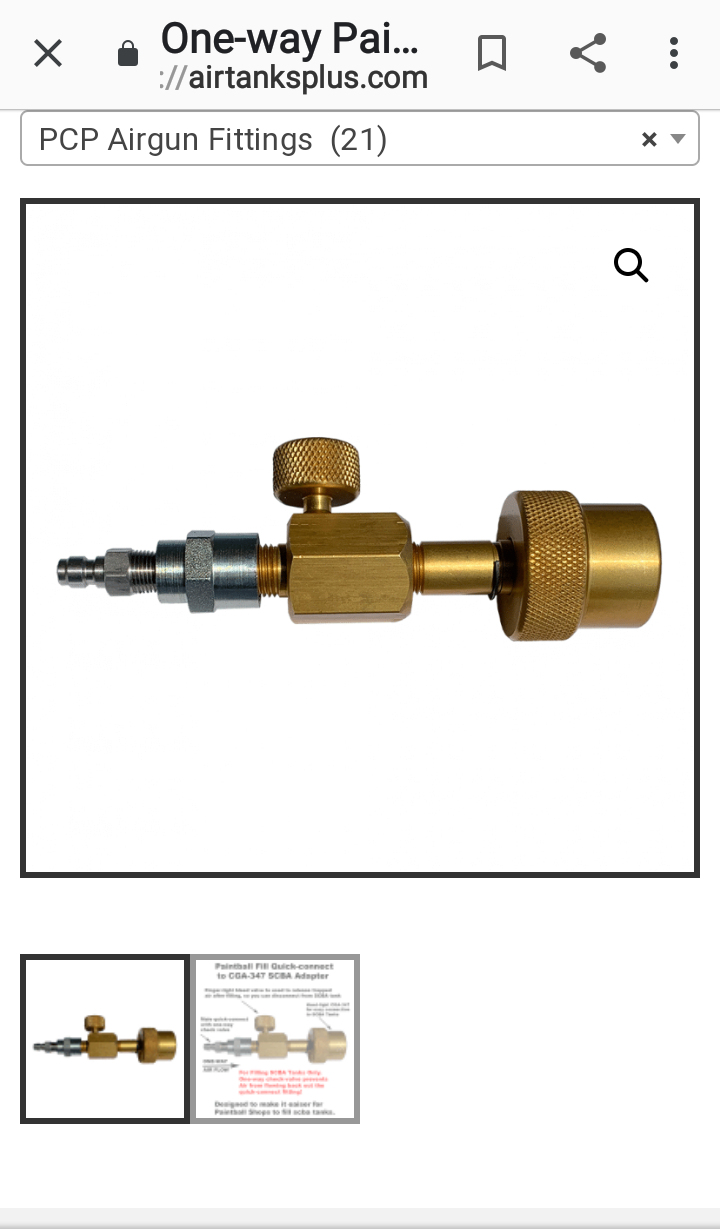

I Called these guys to ask if theirs thread into yours. Yup but doesn't have a gauge not a big deal your gun manometer works?
One-way Paintball Quick-connect to CGA-347 SCBA Adapter with Bleed Valve
$79.95
https://airtanksplus.com/product/one-way-paintball-quick-connect-to-cga-347-scba-adapter-with-bleed-valve/
With this one above you solely rely on your gun gauge or manometer when to stop filling. You need a Double Female Foster adaptor or a hose with Female Foster quick disconnects on both ends.
I have purchased 1 like unit with gauge from China and 2 from USA but I would bet they are from China to. 1 Alibaba and 2 Ebay all you need is a male to male Forster to fill at a dive shop or paintball shop or from your compressor. The gauges work fine and you back fill thru the fill system with the male to male. Cost is Like $30 each. I did pick up a better female foster from Donny because it's longer and EZer to use on some guns. When I got a new SCBA I did splurge on a better fill setup and it is smoother but does the same job.
