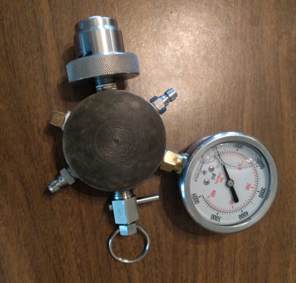

1543035299_18647323165bf8d9a372d1d6.09529532_DIY SCBA Fill adapter n cascade.jpg
The Foster male between the SCBA 'handtight' fitting at the top and the gauge is a check valve inlet for cascade filling.
The Foster male between the bleed valve (at bottom, clockwise from the gauge) and the brass 'extra port' plug is the OUT to the gun or in reverse is the IN to the bottle.
The manifold block is 4140 steel and the intersecting cross passages leaving the bottom of each NPT hole is 1/8" to act as a flow restriction "just in case" of a hose blowout.
I made this over a decade ago as an original idea, so NO it is not a copy of anyone else!
