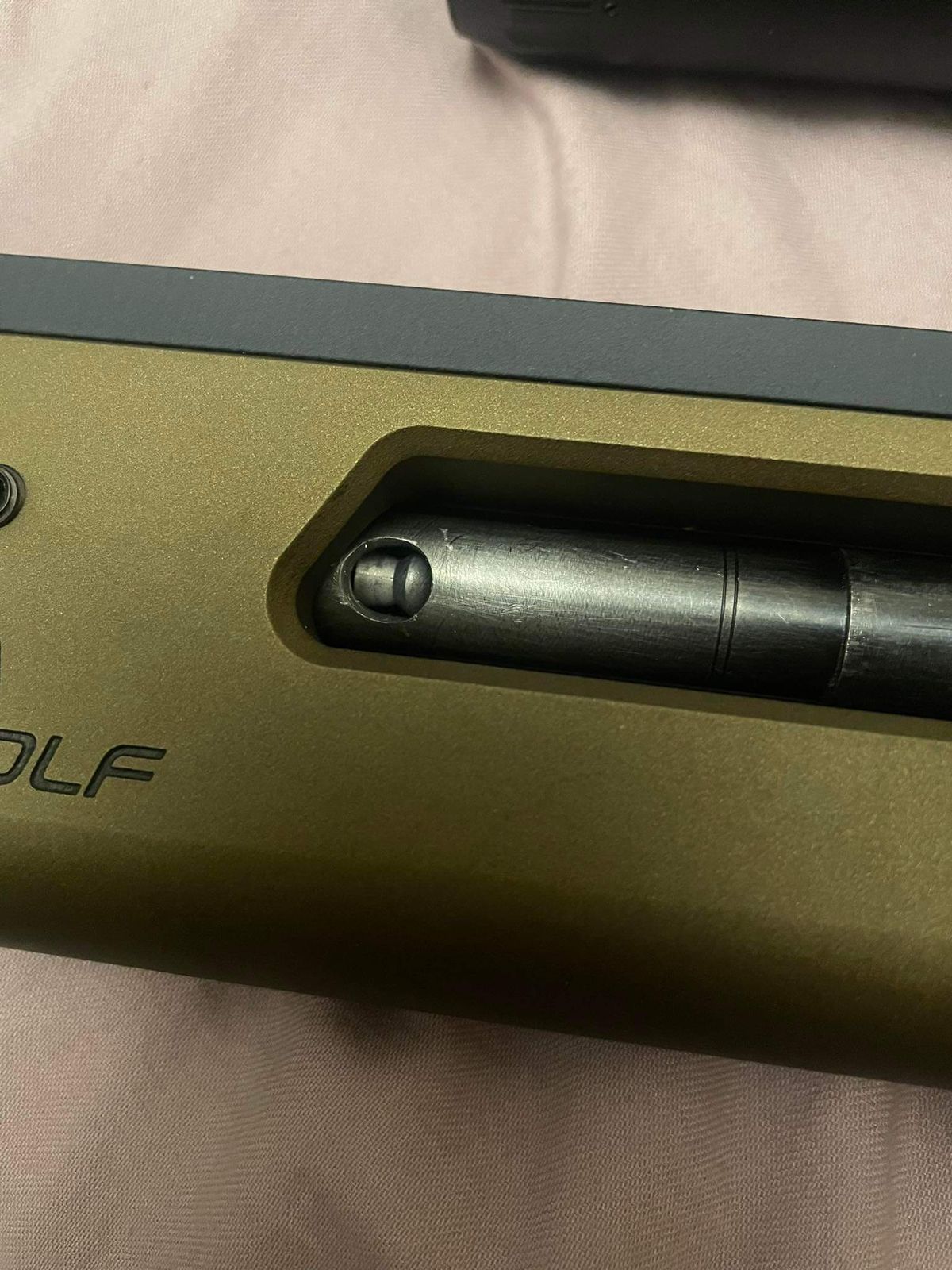

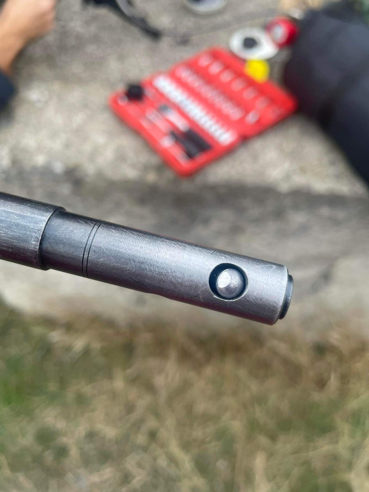

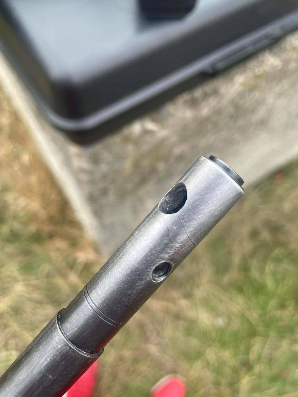

But all what i wrote thats nothing compared to the problem which i noticed when i charged gun fully and took it to test accuracy. shot 1 pellet, then i reloaded and pellet is stuck somewhere in the barrel. Lever is stuck and wont move forward. Luckily we had Key set and removed the barrel and the surprice. Some idiot drilled the transferport with a dremel or something even worse. He was hoping to shoot slugs from it and he made a hole bigger that 25 cal JSB king. We were shocked when we saw how the pellet got stuck into the transfer port. I will attach pictures of the barrel in what condition i receved the gun.
It is fixed now, barrel is machined like from the factory. yes its shorter now because we had to cut off the transfer port and make new one.
