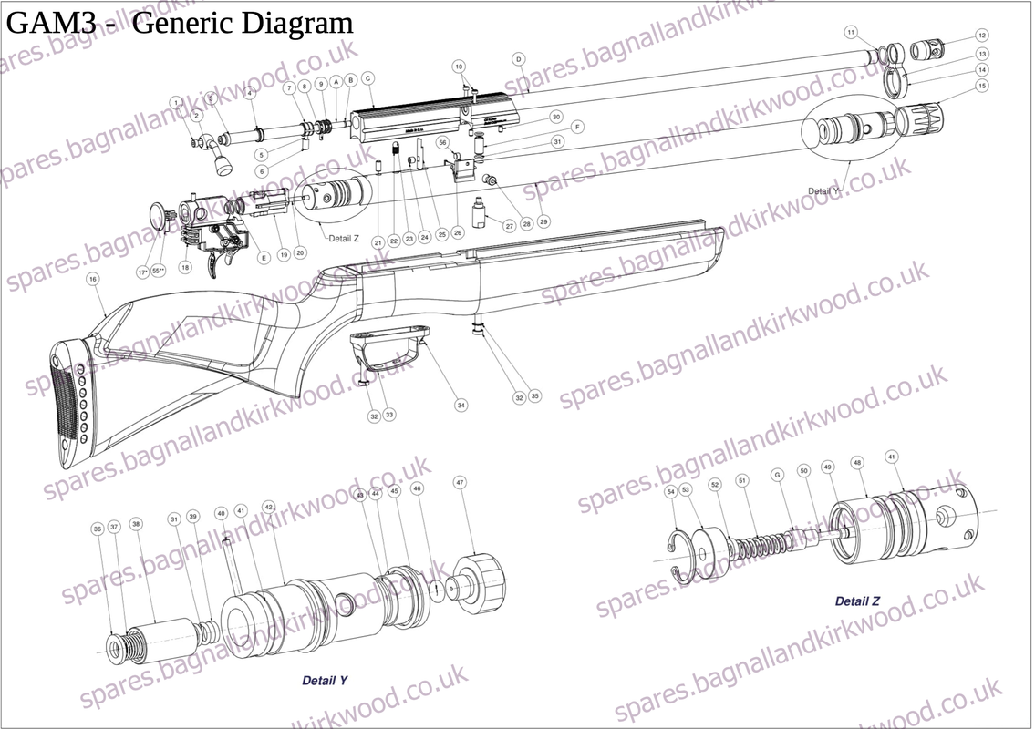

I got a Gamo Coyote (similar to BSA Buccaneer and some other Gamo's) to fix with pellets stuck in the barrel. The bolt and magazine are also stuck, I think because of the pellets.
I want to remove the breech and barrel but I want to depressurize the rifle first. Since the bolt mechanism is stuck, I cannot shoot the air out. I tried loosening the pressure gauge but after a few turns, there is no air coming out and I'm afraid too loosening it too much.
Does anyone know a safe way to depressurize this rifle? Thanks for the help.

There is no need to depressurise anyway if you just want to remove the barrel and action.
This is probably true. Can’t remember 100%. That gun is a bit tricky to split apart. There is a hidden screw somewhere that I can’t remember exactly where it is. I think trigger guard somewhere. YouTube or google was how I figured it out.
