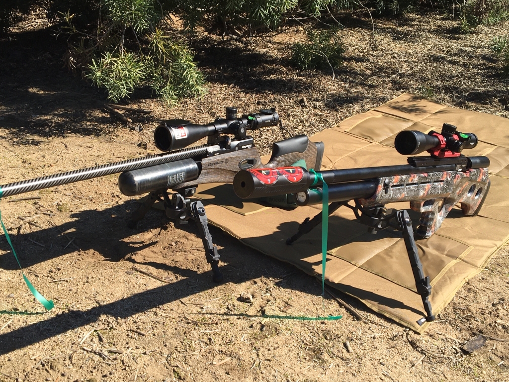

.30 FX Bobcat Mk2, Athlon Ares BTR 4.5-27x50, 44.75 JSB at 875 FPS
.30 Daystate Safari, Hawke Sidewinder 6-24x56, 50.1 JSB at 855 FPS.
Truth in lending, this Safari is not mine and is on loan to me from Airguns of Arizona, but it is BONE STOCK off the shelf, nothing has been done to this gun other than charge the battery and clean the barrel.
My Bobcat, on the other hand, is the same one I won EBR with in October, and it is as far from stock off the shelf as a Bobcat can get. Tuned over the past couple of years, it has the barrel polished to a mirror finish, all firing valve and hammer internals polished, Huma reg. with internals polished, larger valve and valve seat, Wika pressure gauge, custom hydro dip stock, the gun is tuned to shoot over 40 shots per 250 bar fill using 44.75 JSB at 875 FPS, with an ES of approximately 6 to 7 for the 40 shot string, Trigger adjusted to approx. 6 ounces to break like glass on second stage.

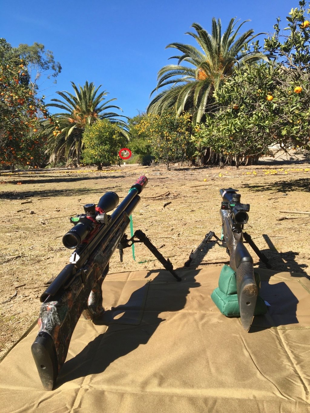

The guns:
1577056832_10470716645dfffa40703d26.03198762_Guns and target El Cajon Dec2019.jpg
The range in a friend's front yard, El Cajon (Rancho San Diego) California, 70 degrees, winds 2 to 3 mph with gusts to 5 to 6 mph.

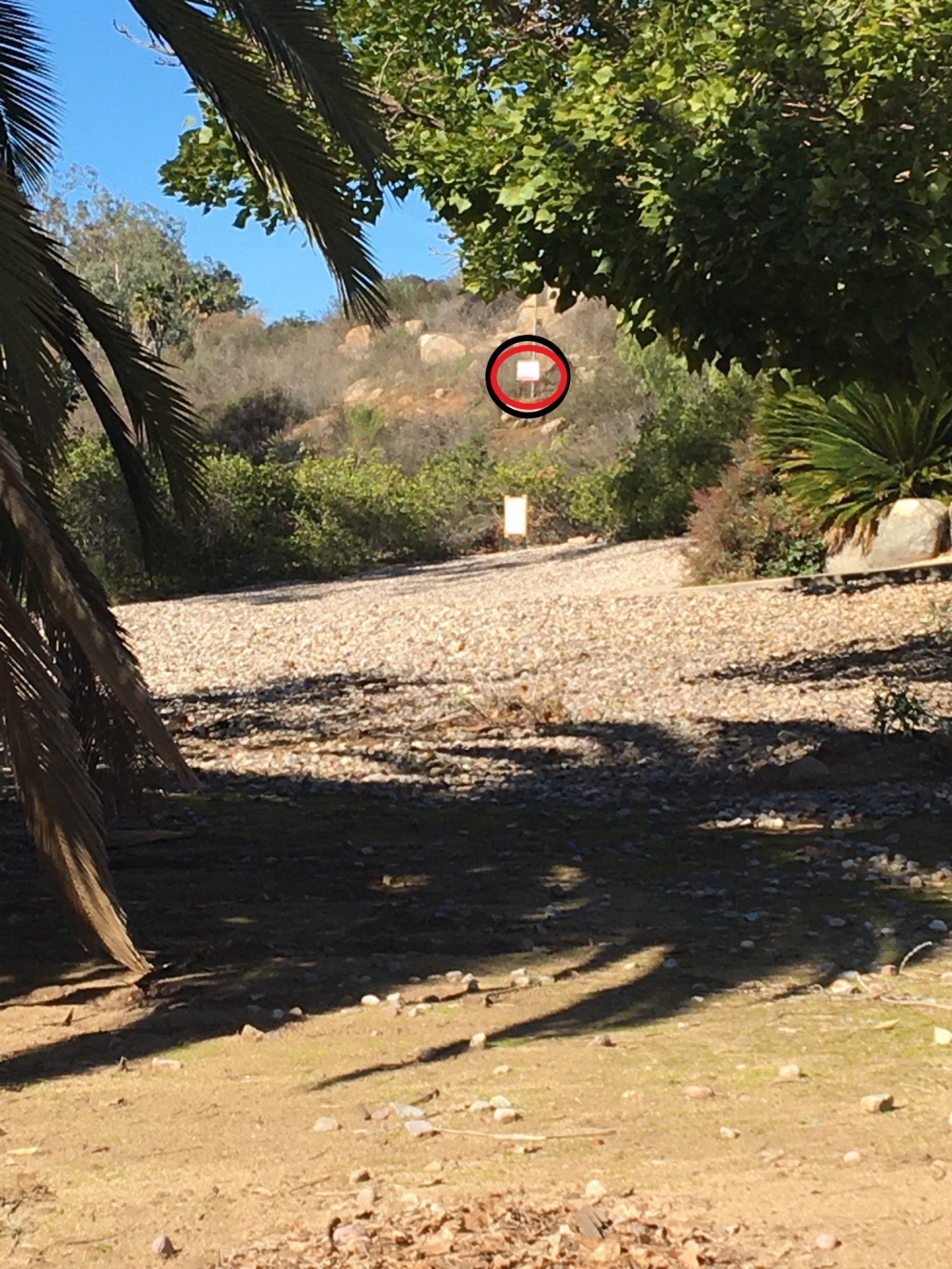

The lower target is 96 yards, the one I used today is above that at 110 yards, shot from a prone position with bipod and rear bag.
