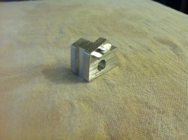

Nobody sells a single loading adapter that I know of so I made my own.
Took me about 6 hours. I think I could cut that in half if I made another.

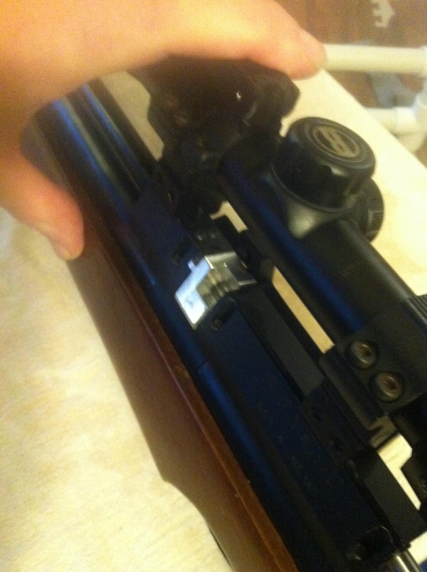

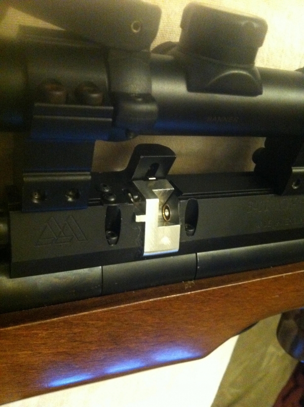

It clips in nice and firm. I milled a channel for the indexing spring to run in so it doesn't get damaged.

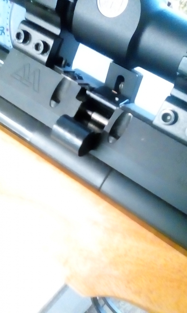

Very nice. The old rcmachine single shot tray used a bit less metal ( maybe less machine work?) . The pic wont mean much to most but you know where the index notch is.

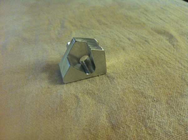

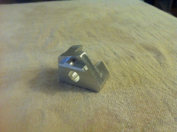

When I started machining mine I hadn't really thought it out. No drawings, I just started cutting. I thought I'd try to follow the outline of the gun and cut a slot in it.
Then I realized that if a pellet flips over the wrong way I couldn't get to it and it was hard to pull the adapter out so I widened the groove into the V shape it's in now.
I stick my pinky in it to pull it out. From a shooting position it's not bad. From other positions it's a PITA. :)
