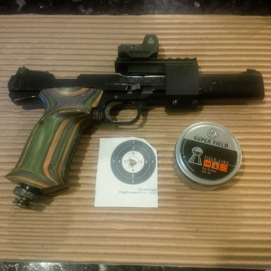

I don't know the velocity, but my SW78G gets about 80 shots per cartridge with a Mac1 valve. It can be pretty accurate if the shooter doe their part. Here is 5 shots at 5 meters, 2 hand standing.
