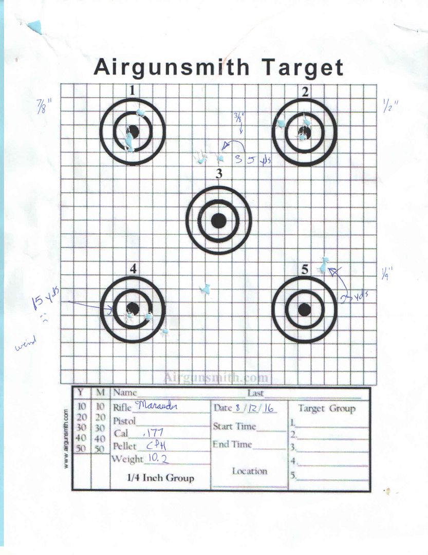

I have a .177 Marauder, but I don't know what 's rod' means, either. Here are a few of my targets. Top 3 targets were shot at 35 yards. They were shot seated, from the field target position. (not benchrest) so the gun will do better. They're not one hole, but they're "kill shot on a squirrel accurate." What are your expectations?
