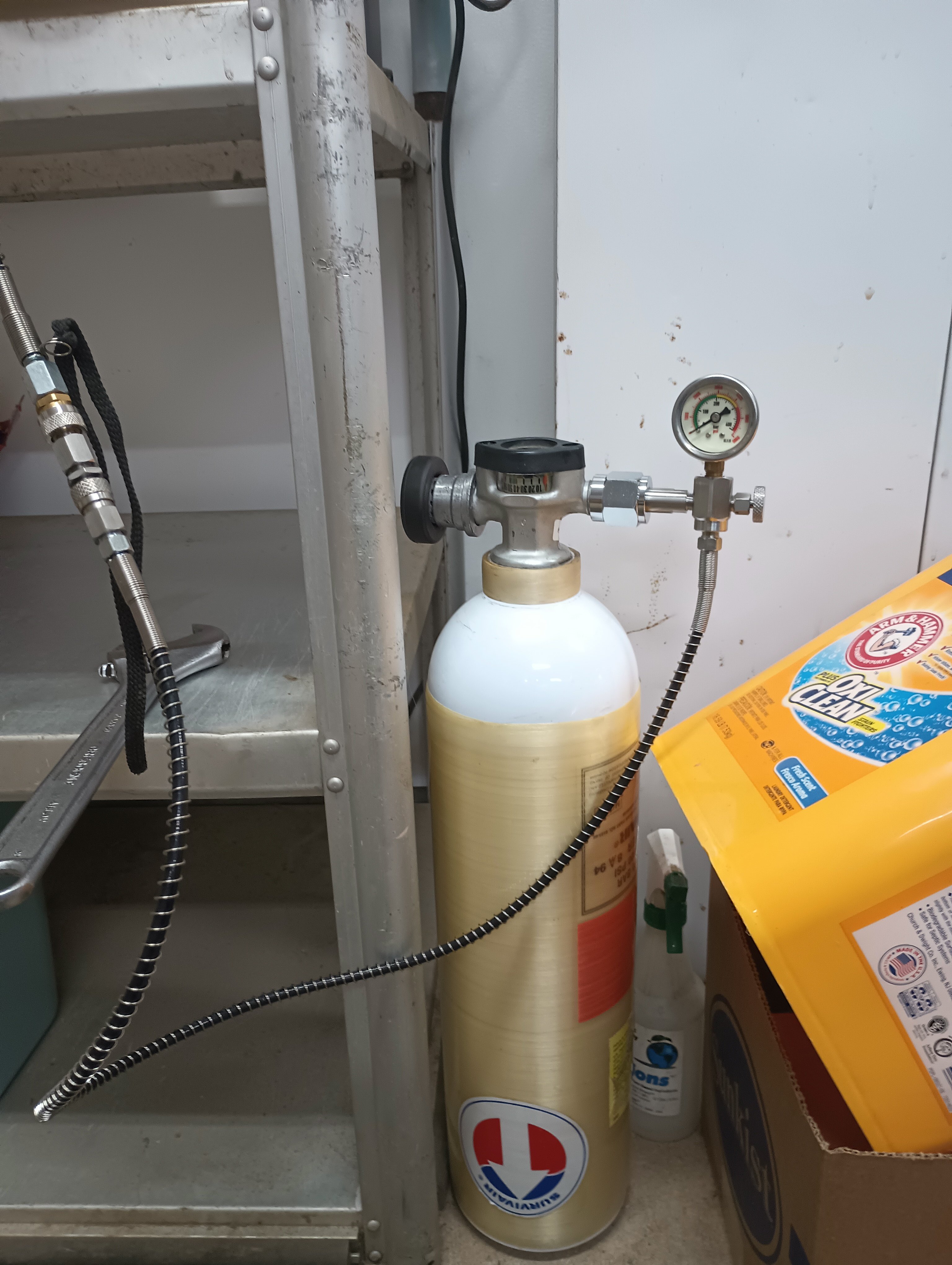

Anybody got a good scba setup idea? I'm looking at getting a SCBA tank for my big bores
I got a scba tank and it was leaking from the o ring between the valve and tank.. so I went to the local dive center and got a new o ring and put it in myself.. but I aired up to 1000 PSI and it went halfway down overnight.. so another soap water spray check and it is leaking from the gauge area, so tomorrow I will call the dive shop and see if they have a valve and gauge rebuild kit or a rebuilt valve.. or if they will rebuild it because the new scba valve I found wes around around $300.. I got the fill set up from Wes at airgun archery fun in Canada.. and it has the fill gauge and bleeder and hose with the foster fill and the back to back to hook up to your compressor.. if you don't have access to a cheap scba tank id recommend getting it from Wes since he sells them with the fill station..
by the way. I have the survive air brand 30 minute tank.. it from what I can tell has the tank thread of 7/8.. there's 3 different size valves I have found.. 7/8" is most common on them, I guess a few were 5/8" and the standard fill station that most people think screw into the tank is metric 18 mm if I remember correctly.. but the metric threading is for airgun type tanks and doesn't fit scba tanks, so it is not as simple as buying the metric fill station and changing the whole valve assembly..
note.. there's another thread on here somewhere about the valve and fill station on here, sorry I don't have the link, just use the search like I did.. it has a link to a pyramid air fill station with the 7/8 threads but if you follow it, it says out of stock and yet if you search pyramid air it's no where to be found.. myself I plan on contacting pyramid air and seeing if it was discontinued or if it is available elsewhere.. but I didn't like the gauges on it because just bar reading..
if you find out a place to get a complete replacement fill station valve combo, please let me know..
thank you
Mark

Just get one off Amazon or eBay there called cga-347 scba fill stations what compressor are you using to fill your tanks with?

You don't need a "fill station". Since you already have an Omega compressor, all you need is a valve that has a Foster fitting.
An Omega trail is better for filling gins directly, not a tank, IMO.

Here is the link TBVECHI Adaptor 4500PSI Paintball SCBA Fill Station Charging Adapter with 60cm Microbore Hose Diving Cylinder Inflation Valve (CGA320) https://a.co/d/0PUqr6J

That may work for YOUR tank, but not all of us do it that way. There are MANY different ways to fill a SCBA tank, and it all boils down to what your local air supplier can adapt to.
I use Foster at home, and so does my SCBA supplier.

that's a similar one to the one that I got from Wes at airgun archery fun in Canada.. however my problem is not the compressor or that part.. first time I tried filling the tank the o ring was leaking where it's valve is attached to the tank.. after a new o ring I now have a leak on the built in gauge on the tank valve..
while I agree with you that the Omega trail charger is best for filling guns, I figured it was fine for filling the tank as long as it was staying cool.. the minute I feel warm air coming off the water radiator I figured it was best to stop compressing and let the water system circulate until cold and then give it a break..
it's a very well built compressor and I figured that as long as it doesn't get hot it will be fine..
Mark

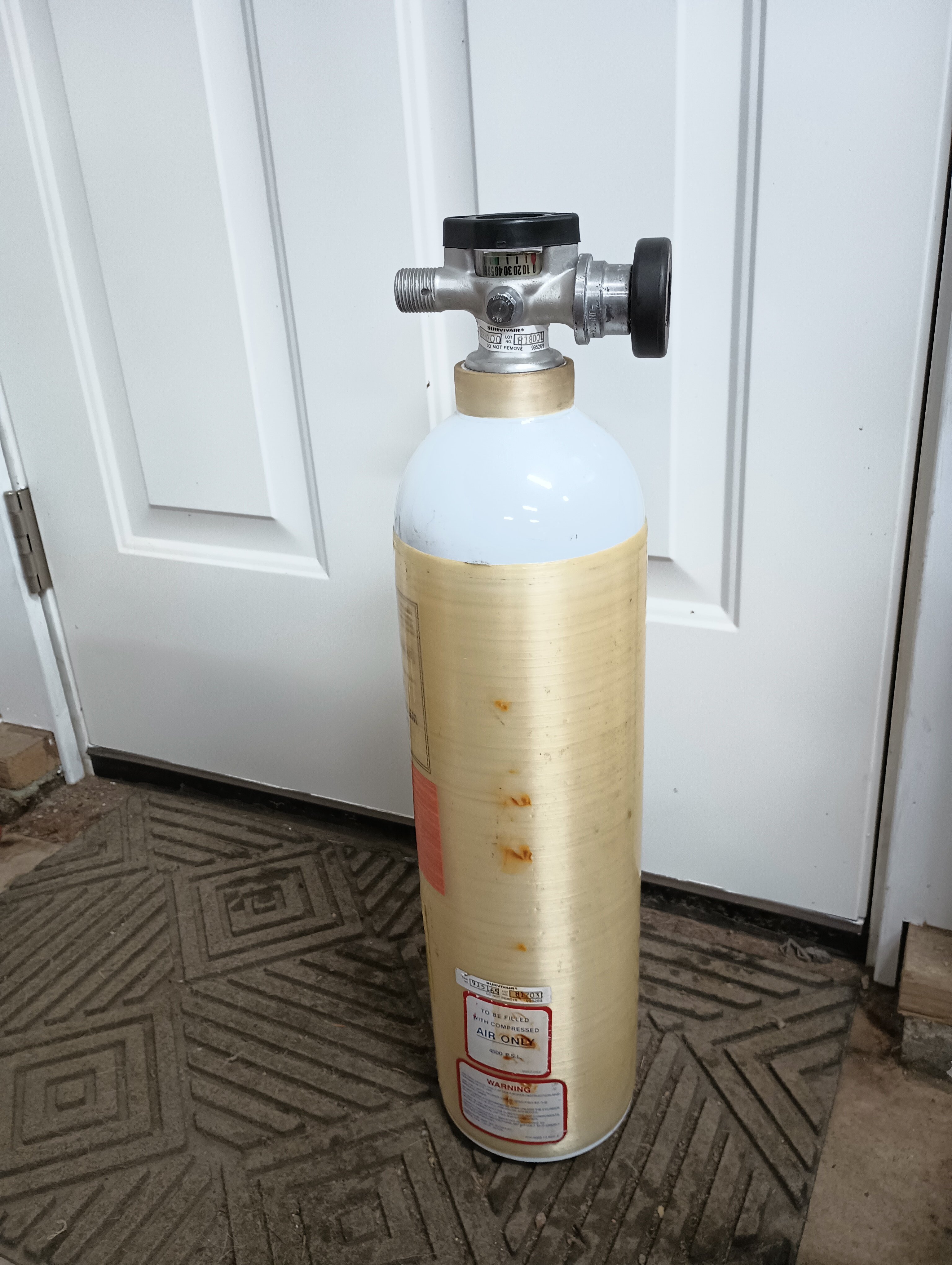

so the factory valve and factory gauge on the scba tank is where I'm dealing with the leak.. so it's leaking out the top center of the gauge area. . hopefully I can find a solution for it that is not too expensive.. second picture is the fill station from airgun archery fun attached to the tank
Mark
