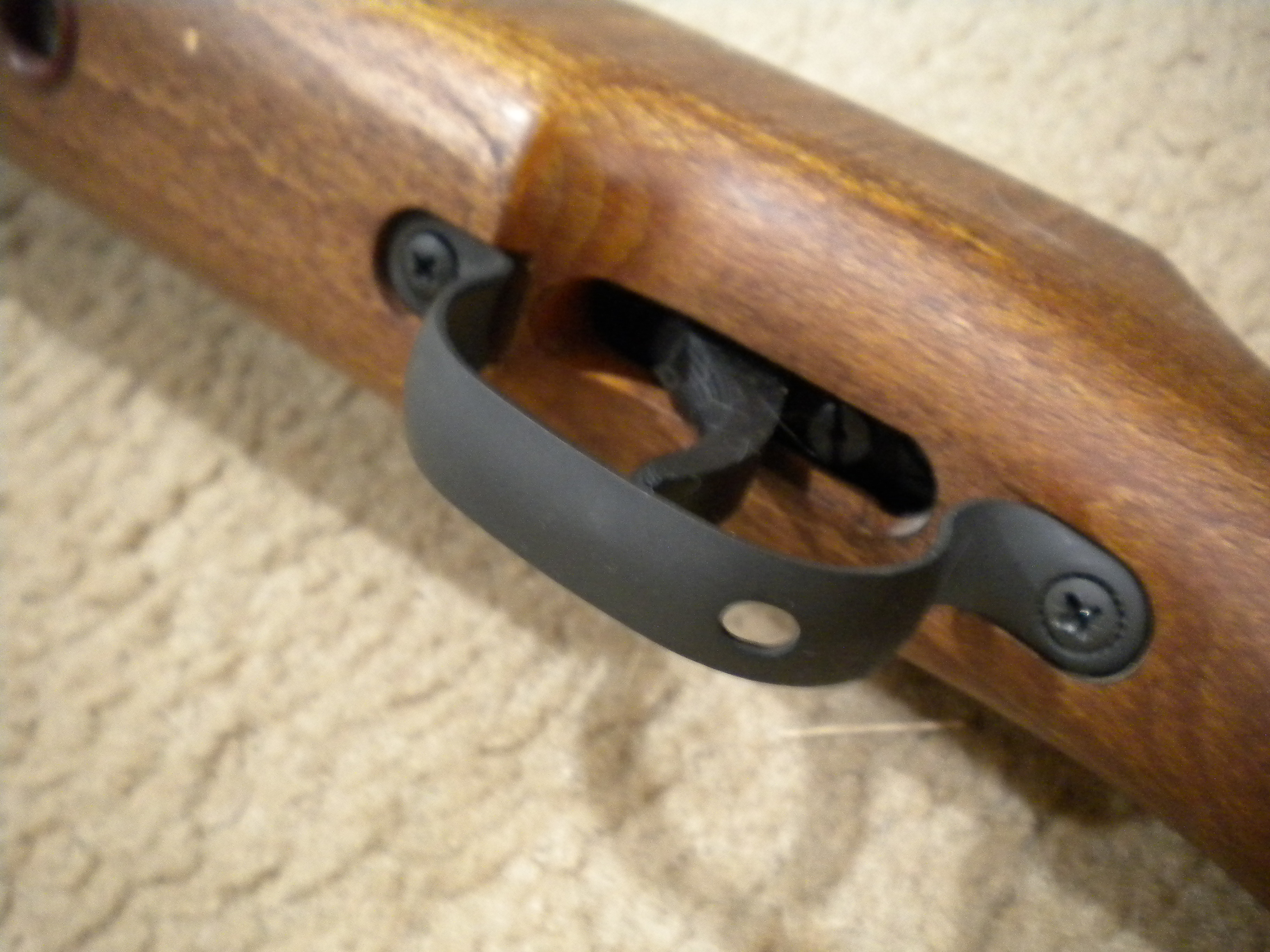

Yes, my Diana has a safety and it's definitely not T01 or T05 trigger. I heard the opinion that in my photo is an early (prototype) T06. This is Diana 30 (1974-2023) with Lothar Walther barrel (MSRP $1400).
That’s one of the gallery guns? I don’t know anything about those. Couple guys on here with the Oktoberfest but I don’t know if the triggers are similar. Possible MDriskill on here would know. Best bet might be to post on GTA and see if Hector Medina has any info.
