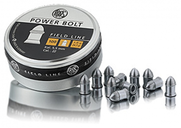

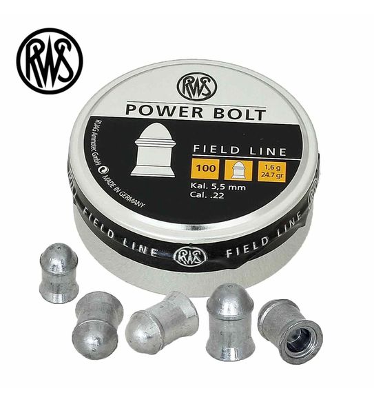

• Extremely Heavy: Power Bolt, 24.7gr –– and in an extensive search I haven’t found any BC.... Anybody got a number for me?
It’s torpedo-shaped, 9.1mm long, and looks like it could do some “good” damage. Could it be a competition for the JSB Monster?
Here’re a couple of links to German websites with photos of this pellet:
https://www.4komma5.de/RWS-Power-Bolt-55-mm-fuer-Luftgewehre
https://www.versandhaus-schneider.de/product_info.php/cPath/49_242_0_40_95_157_1330/products_id/34797
1545179190_20106047895c199036437a43.92102987_RWS. 5.5mm. Power Bolt. #02.jpg
What do you make of this?
