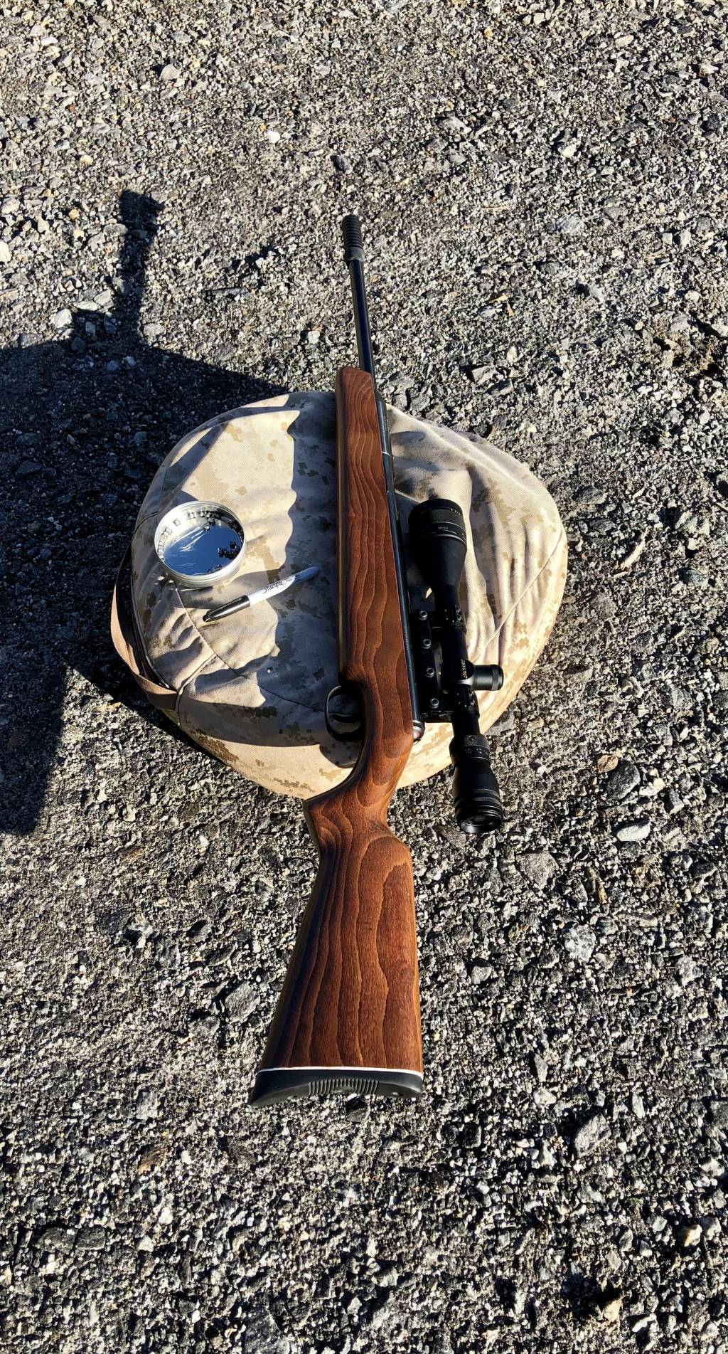

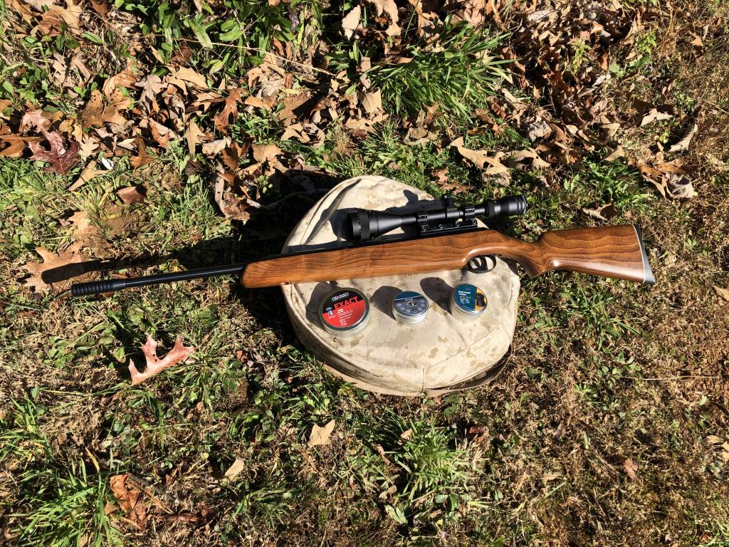

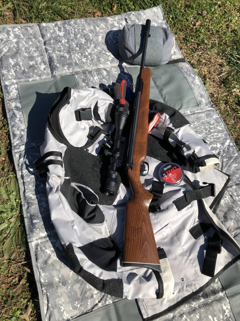

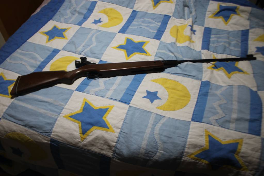

Another lucky grail find this year, the rare and discontinued RWS Diana 48 .20 cal (let's just call this D48 .20 #1😉) with T01 trigger unit. The inspiration comes from the possibilities of
1. having a magnum, fixed barrel platform
2. bore, stroke & piston weight designed to make power
3. sidelever cocking which means finally I can take on the challenge of long range prone springer shooting
4. shooting JSB 13.73 with its outstanding BC, having enough impact energy to ring 3" and 4" steel gong targets at distances of 65 yards + (I actually made some heavy duty targets purpose built for this rifle! 🤓 more on this later)
5. hunting, of course. The Roman Goddess Diana (Artemis in Ancient Greece) was not only the Goddess of the moon, but also the Goddess of the hunt, known for her extremely short temper and fits of rage to punish mortals who offended her. Poor Actaeon! So I find it fitting that THIS Diana will serve to not only hunt but punish intruding or unwelcome critters! LOL

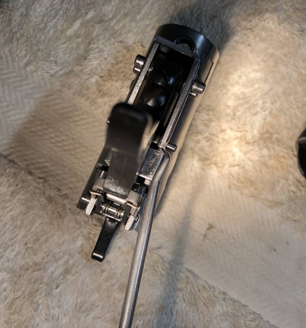

I've had the rifle for a short time and it took a little while to accustom to the sidelever cocking dynamics. Decocking this rifle for the first time was...interesting🤓. Accuracy seemed decent but I knew it was early days and the trigger definitely needed work for precision target shooting. Heavy pull, and stiff break point without a crisp, discernible wall. Lots of sideplay in both the sear pin that secures the bottom sear and the trigger blade.
Long story short, the trigger is now sorted and is very responsive, breaks cleanly with a glassy smooth take up & lighter pull. The sideplay tolerances have been addressed with shims and the blade now has as little sideplay as the T06 blade on my RWS 54 Air King. A drastic improvement!

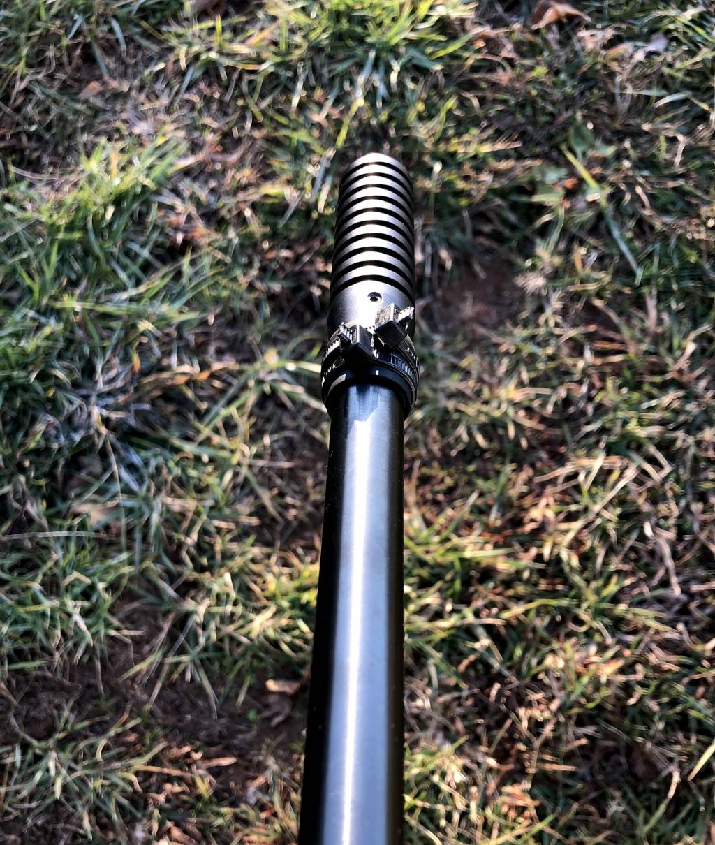

Last night I decided to take a look at the Beeman muzzle brake and the set screw was just 2 threads away from coming out. 🤦🏻‍♂️ My bad, this was totally overlooked! In the beginning I imagine it was tighter, but accuracy started to suffer as it loosened.
I went ahead and reapplied the brake after a thorough cleaning of the barrel exterior and the brake shim ID. It was still a bit loose and needed an additional .004" steel shim for a tight, interference, "push and twist" on fit. Wood block placed against muzzle and a couple mallet taps for the brake to secure against the barrel shroud, and set screw tightened.
Experimental Mode: ON
I want rigidity, so I went a step further and placed a wide, black ranger band (heavy duty rubber band) over the area where muzzle brake & shroud meet. Next, a steel band over the ranger band, cut so that it wraps around and covers the articulating area without overlapping. Next, another ranger band to cover the steel, followed by two diametrically opposing torsioning forces: a couple of zip ties😉. Laugh with me, not at me. It's an experiment after all, not a permanent solution. Nothing to lose, and tighter groups to gain.

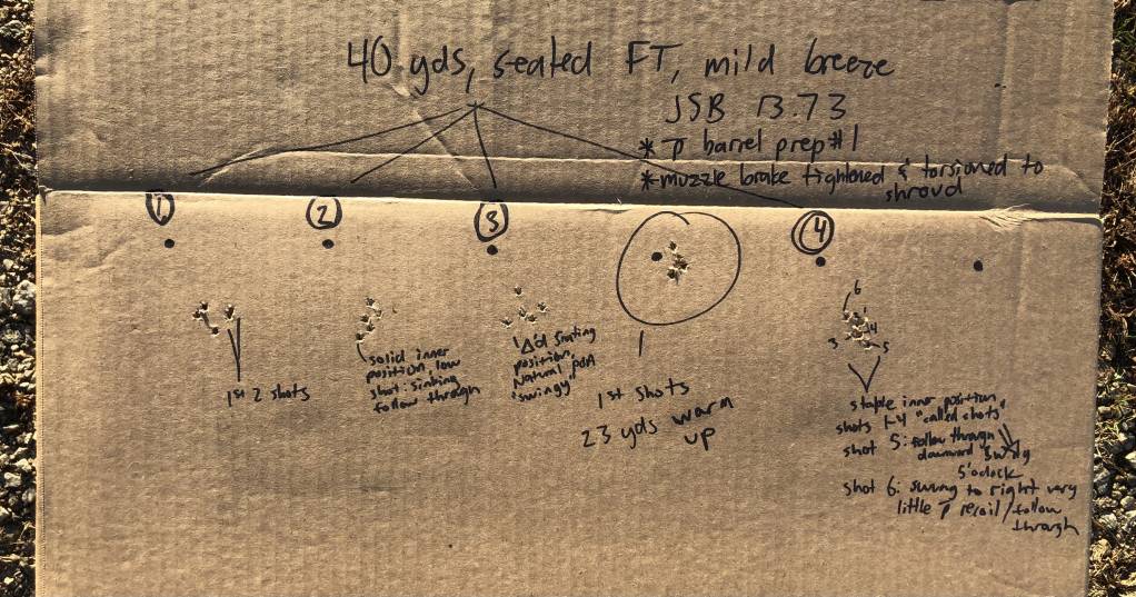

This morning I was able to test using JSB's at 40 yards (maximum distance I could scoot back to without the rising sun milking up my Simmons 44 Mag Scope). I warmed up the gun first with a 5 shot group at 23 yards. Nothing noteworthy, especially since the barrel has just received its first "accuracy prep" treatment (deep clean and light polish).

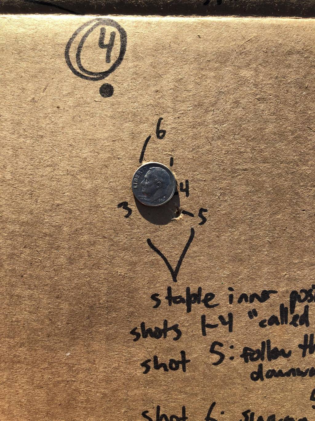

Here are the four 5 shot seated groups shot consecutively with minor changes in my positioning. For group #4 I raised my knees up considerably, and the position felt great, was easier to manage the recoil and follow through was a bit more on target.
A closer look:
Groups 1-3:
Group 4 (I shouldn't have written all over the pellet holes, but wanted to document the shots while memory was fresh):
I knew I swung shot #5 low and to the right, so sent a 6th shot to join the group😉
5 under a dime at 40 yards (shots 1-4 & 6) we're on the right track. These shots felt like "called shots". I know the rifle is capable of doing better, so onwards & upwards!
Trigger: among some of the modifications done, here you can make out the shims to reduce sideplay and offer a consistent, quality break.
My temporary and highly experimental D48 brake/shroud torsioning apparatus🤓🤔:
And the underside displaying the D.O.T. S. (diametrically opposed torsioning system) 😉:

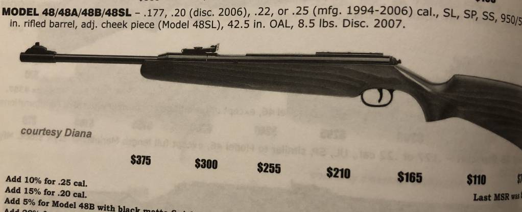

It's my understanding that the Diana Model 48 was a factory offering in .20, as was the Model 34 & 45. All discontinued, obviously.
But back to the 48, here's some info from the Blue Book, 11th Ed.:
truck-driver, I know there have been many custom/special orders organized over the years, but I believe the only factory offered Diana springers in .20 were the Model 45, 34 and 48. At least from what I see in my Blue Book. Thanks for sharing some of the background of these .20 cal Dianas.

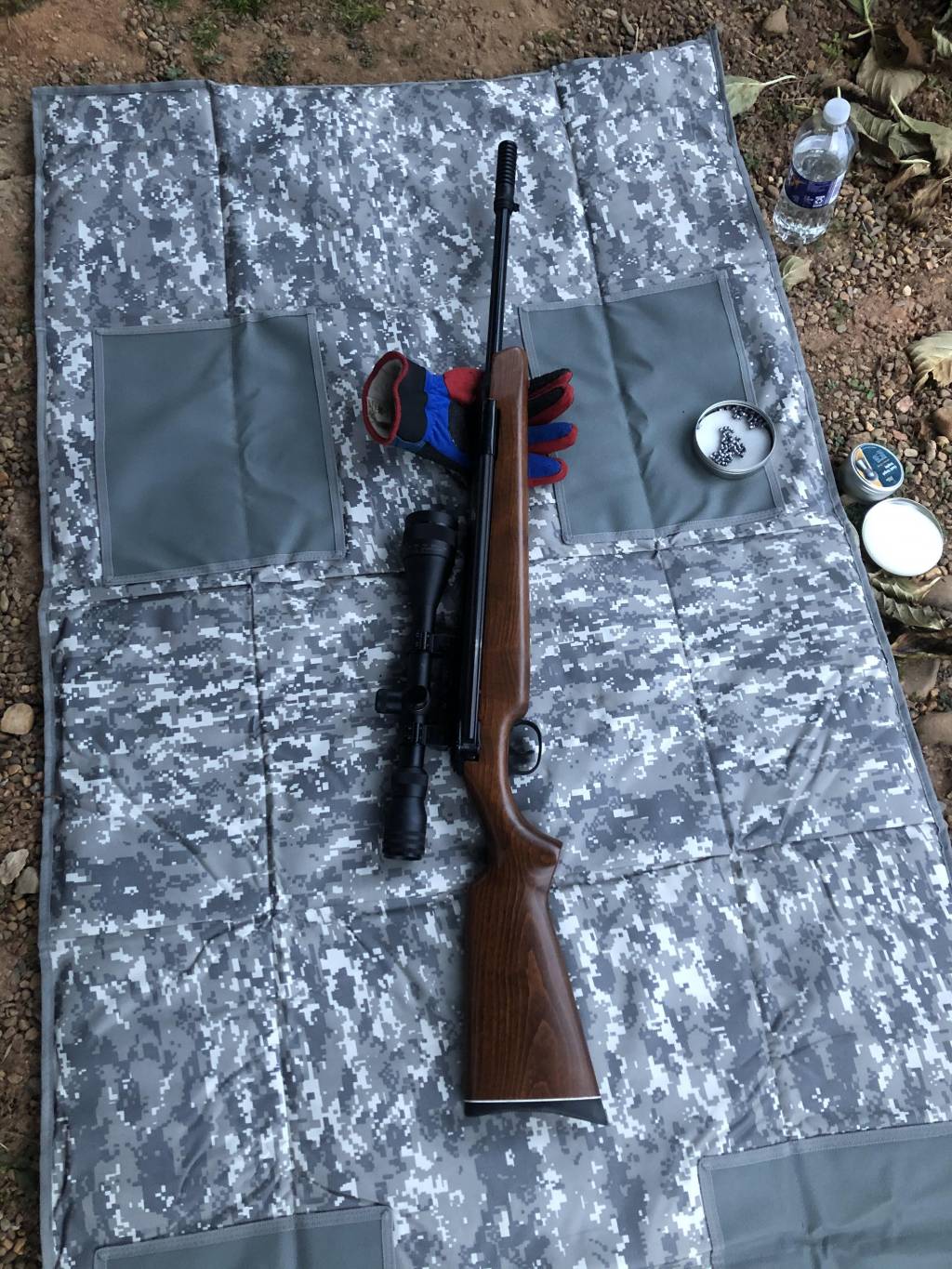

The shooting mat definitely helps with comfort, the coat & glove aid with positional stability, but none of this fun would be achievable without the D.O.T.S. 😜🤣. Fun times!

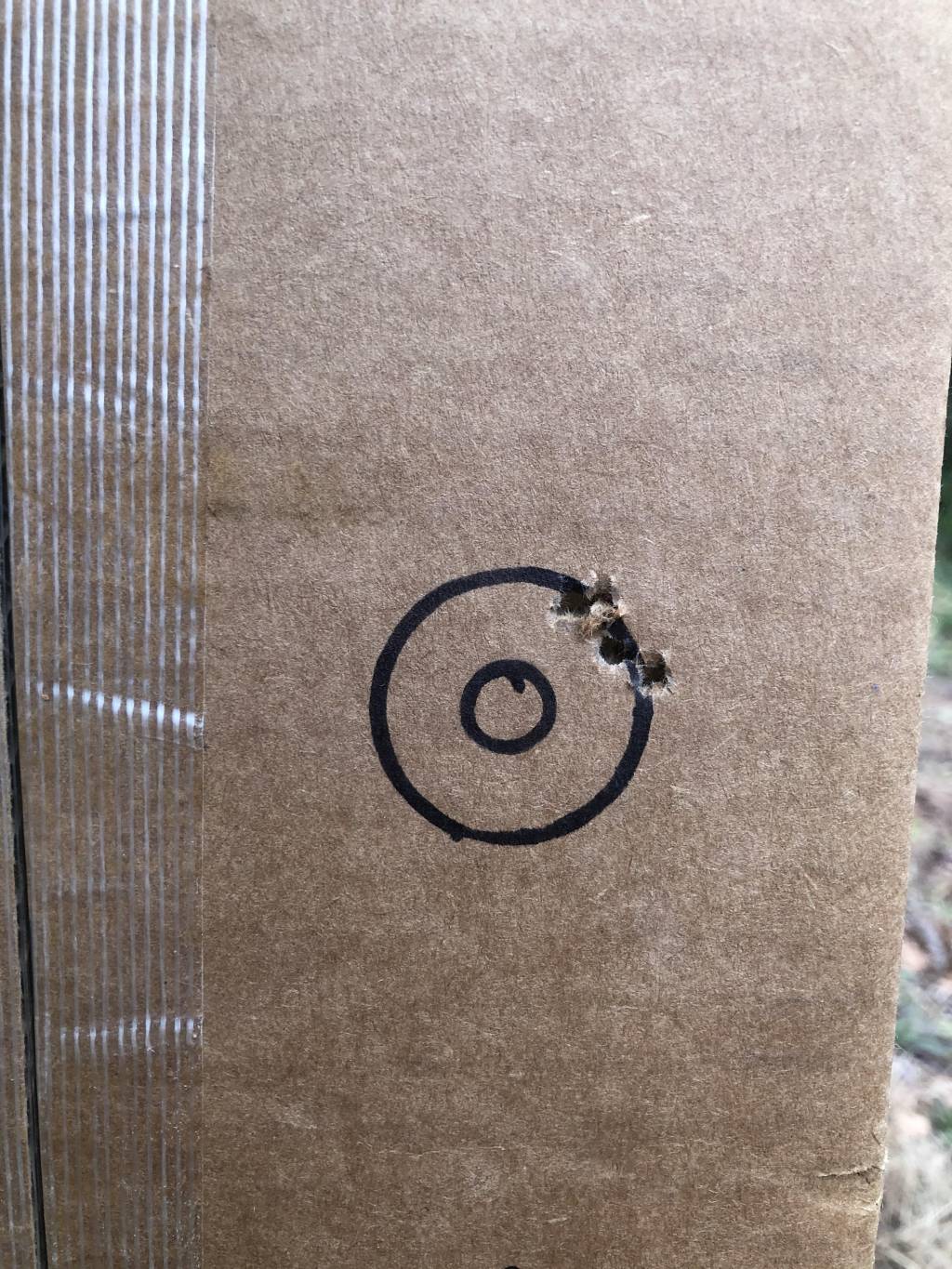

Yesterday early evening I was able to get in some practice with the D48 .20 cal. I thought that if I can get 5 in under an inch at 25 yard in this not so comfortable position with a recoilling magnum then that'd be acceptable.
Surprisingly POI from the prone position is not far off from when the foreend is placed directly on the knee (seated position).
The best 5 shot group of the short shooting session is below (target is a traced washer with a 1/2" center hole- so the actual middle ring is slightly under 1/2" diameter). JSB 13.73 gn were used.
Rewarding, sure. Room for improvement? Absolutely. Gotta stay at it!

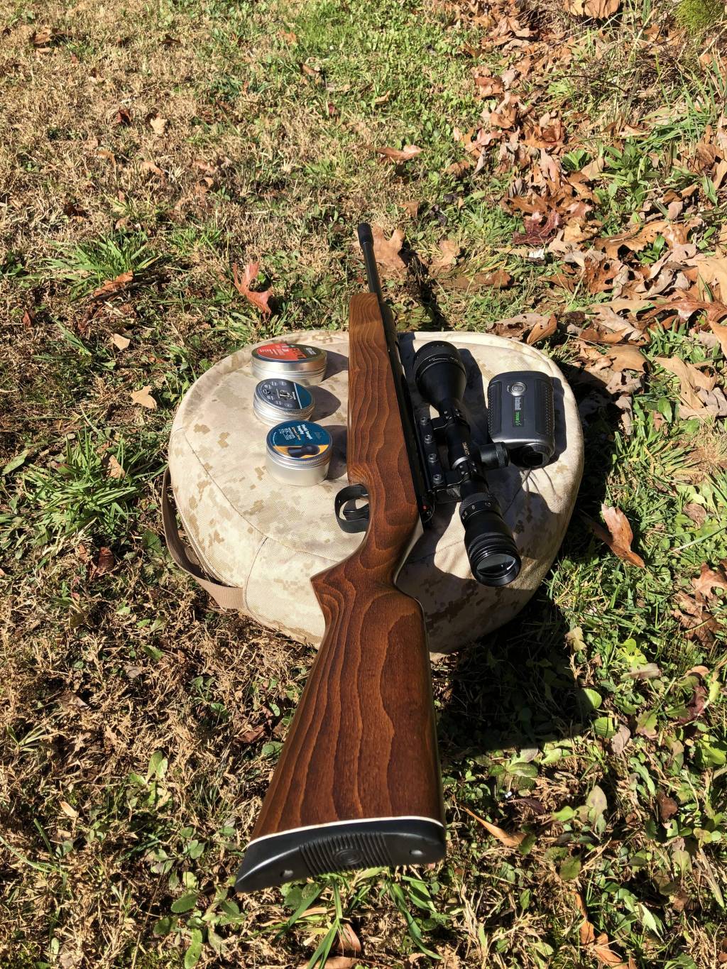

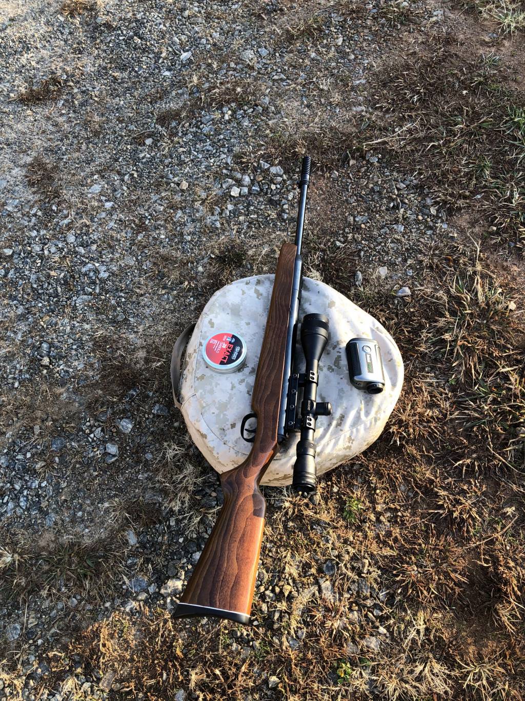

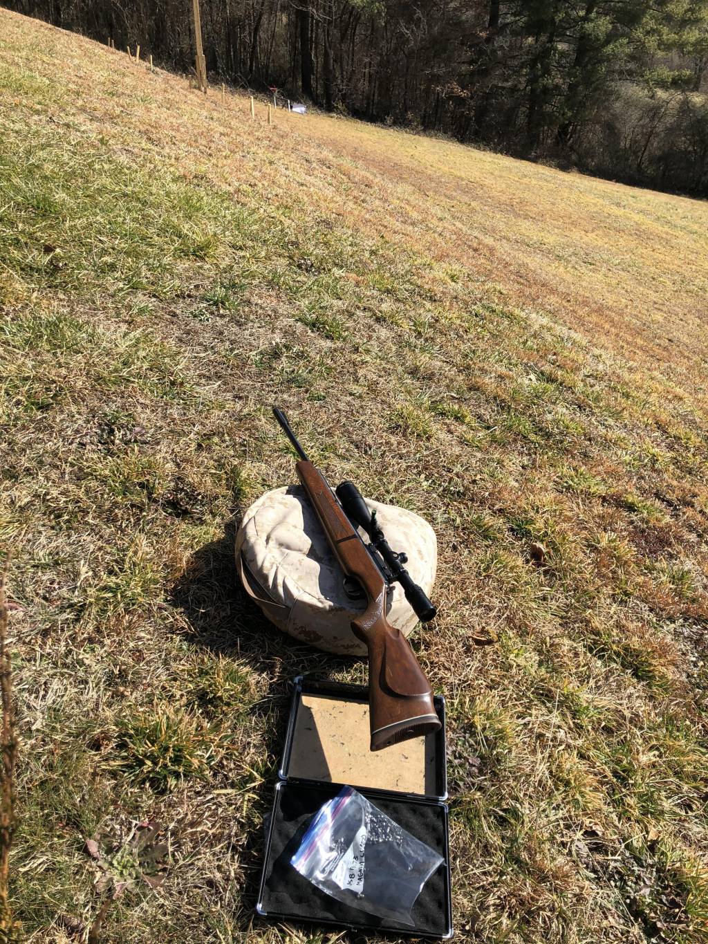

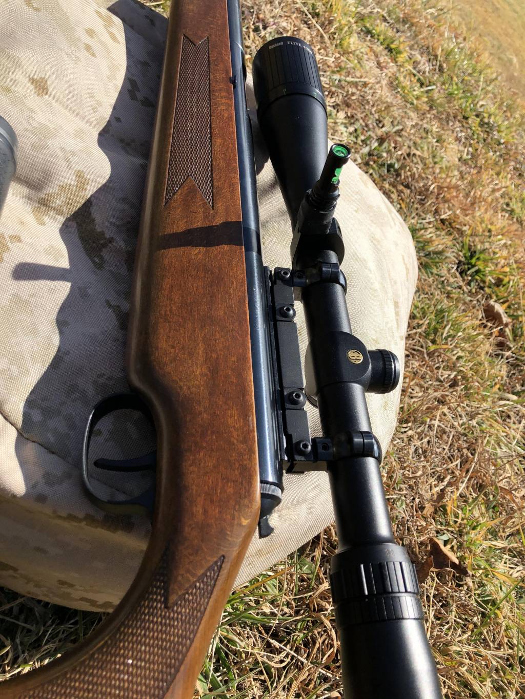

RWS Dynamit Nobel steel one-piece adjustable mount with Bushnell Elite 8-32X40 optically centered at 35 yards now mounted atop my Diana 48 factory barreled in .20 cal (this is D48#2, a T05 gun). Front sight ramp and rear sight removed, 3mm grub screws now occupying the rear sight holes for a cleaner look and less mass to vibrate. The action is in my "bionic" 🤓😆 repaired/improved 52 stock and it's been performing great.

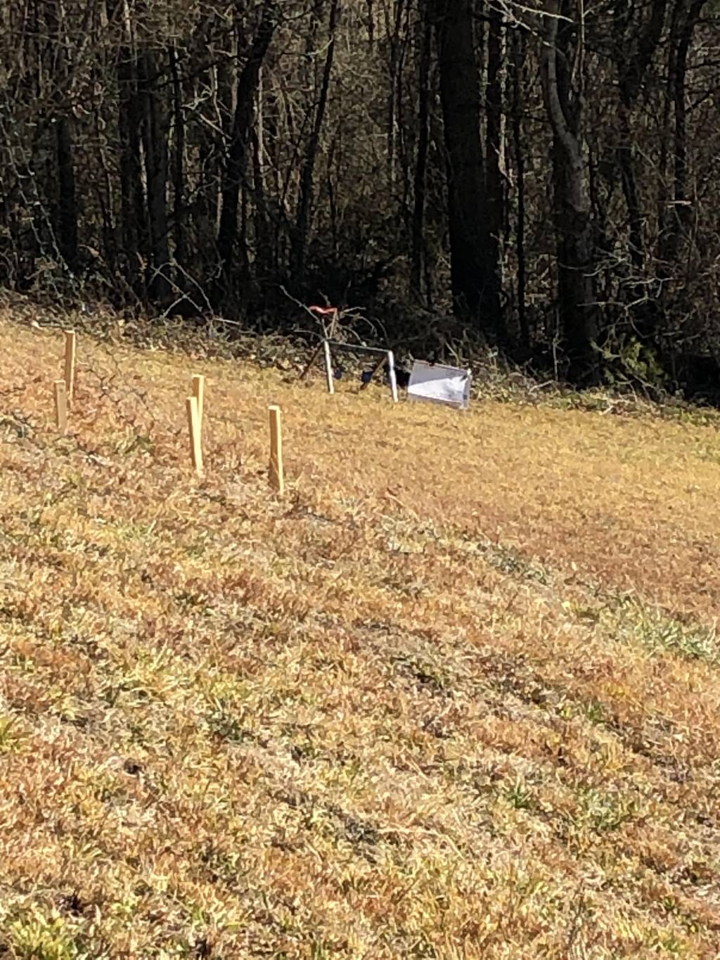

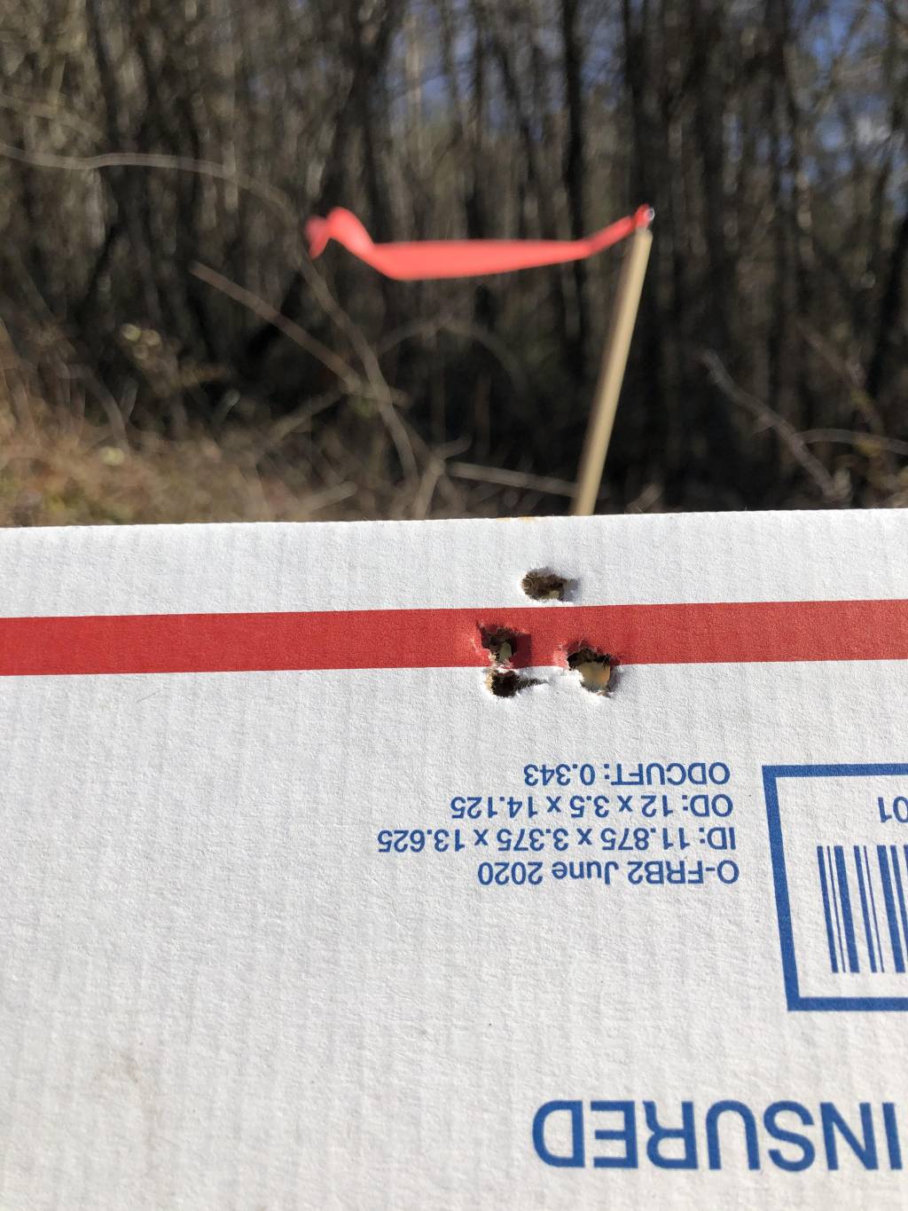

10mph predominant crosswind today (slight angle towards me at times). Beautiful day to shoot .20 cal 13.73gn JSB's. I sat on the top of the slope and shot down and across it at my target box set at 39 yards.

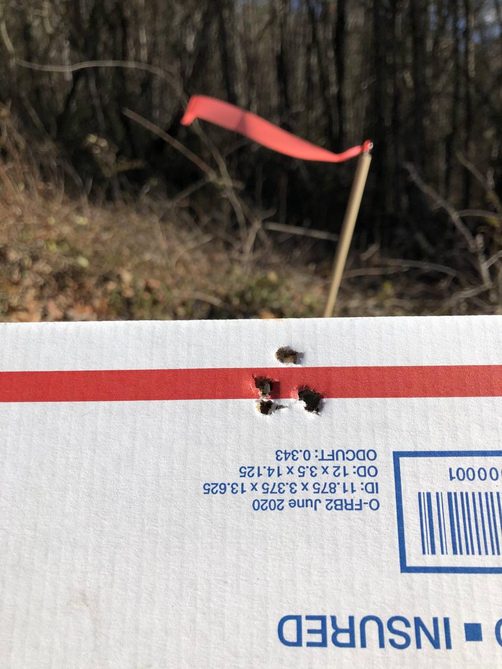

2 pellets through one hole, 2 more to the left shot in gusts; still holding a tight waterline and one shot that crept up on a not so consistent hold/follow through. 5 shots well covered with my thumbnail.
My D48 .20 rig with white target box downrange. Note the orange wind flag fully stretched to the left:
A bit of zoom:
The .20 cal grail spits out the JSBs very nicely and shows the wind who's the boss:
