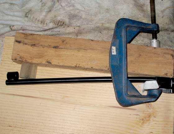

Another common cause is pulling the trigger after cocking the barrel and while it is still broken open. The spring slams it shut and momentum whips the barrel upward, imparting a permanent upward bend and shifting the POI upwards quite a bit. This happened to me with my Beeman R1. I was able to fix this by bending it with a simple jig out of scrap wood and a c-clamp, thanks to an excellent series of articles by Tom Gaylord:
Here is a link to the final article in the series, which also has links to all of the others. It's very good reading:
The pictures in the last article are pretty self-explanatory. You have to keep tightening the c-clamp to put a reverse, downward-looking bend into the barrel, then release it and check it for straightness. It helps to count the number of turns of tension on the c clamp so that you can go just a bit more each time until you nail it without bending it too far.
That should help you out, good luck!
