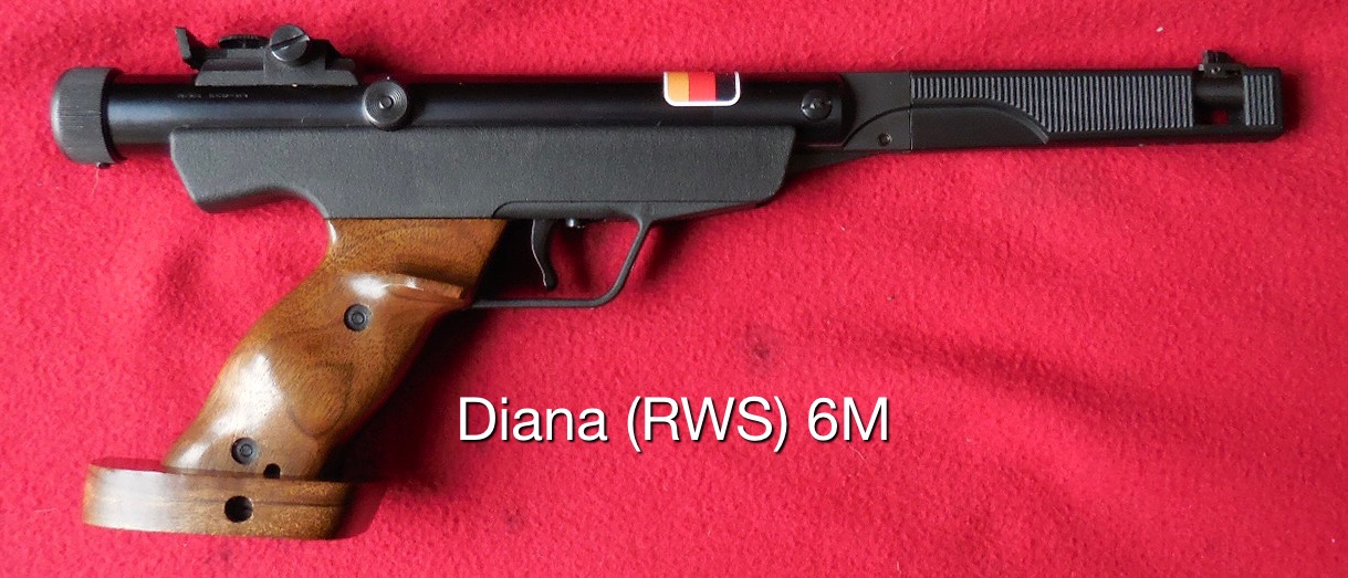

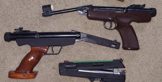

ALSO .. keep an eye out for the Winchester 363 ( Top Right )
It was a Diana 6M in a proprietary plastic RH thumb rest stock.
Here is mine i picked up a few years ago as a non shooting closet queen ... Actuality like it better than my OEM 6M ( Mid left )
Reactions: Pale_Rider

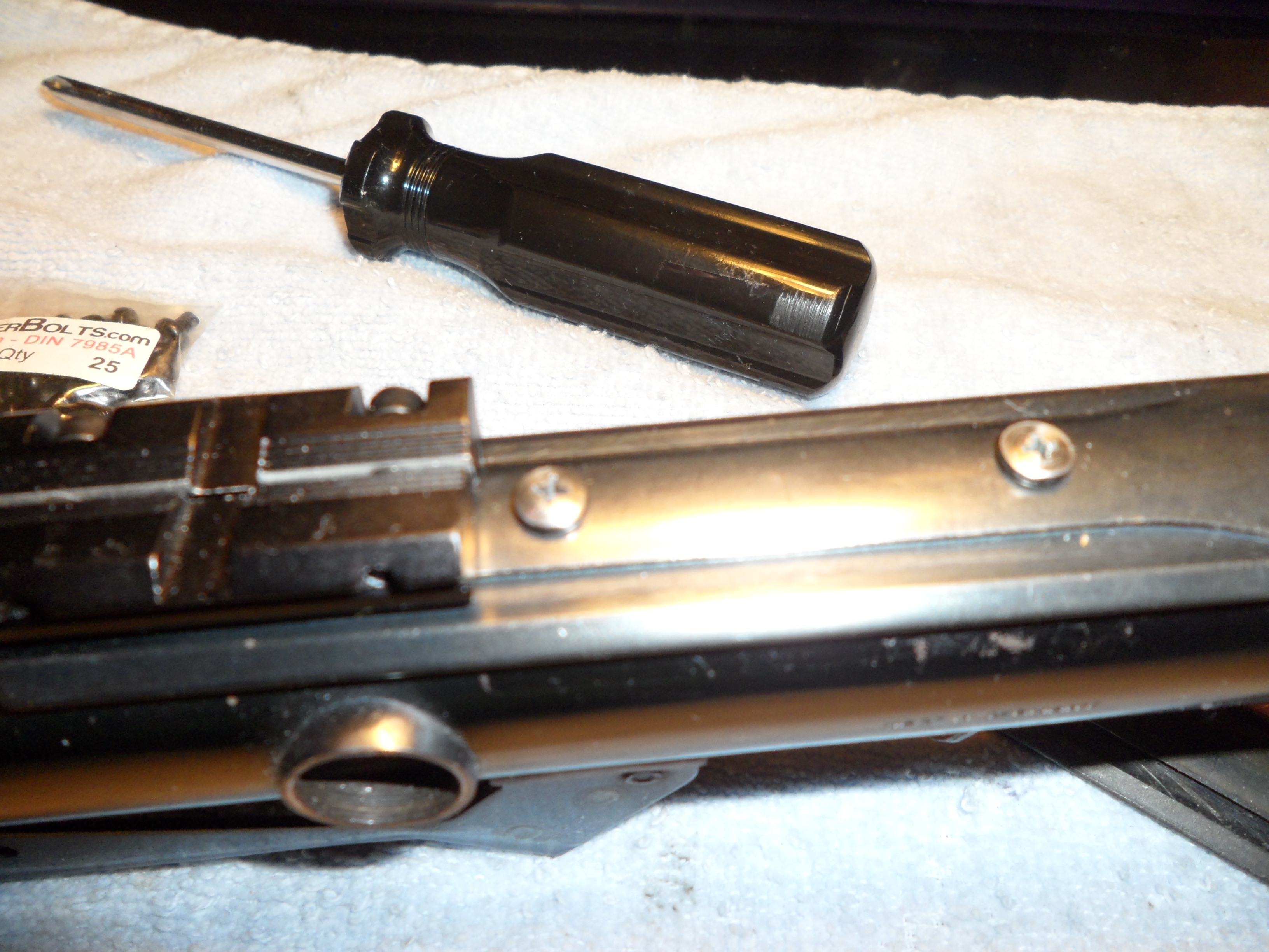

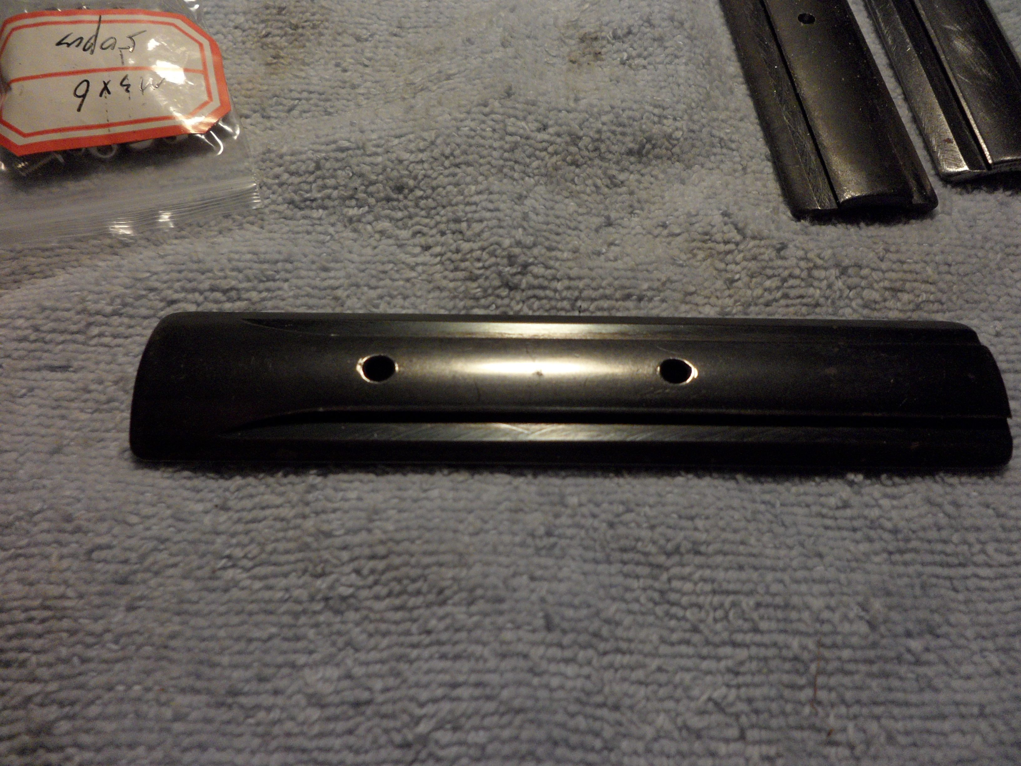

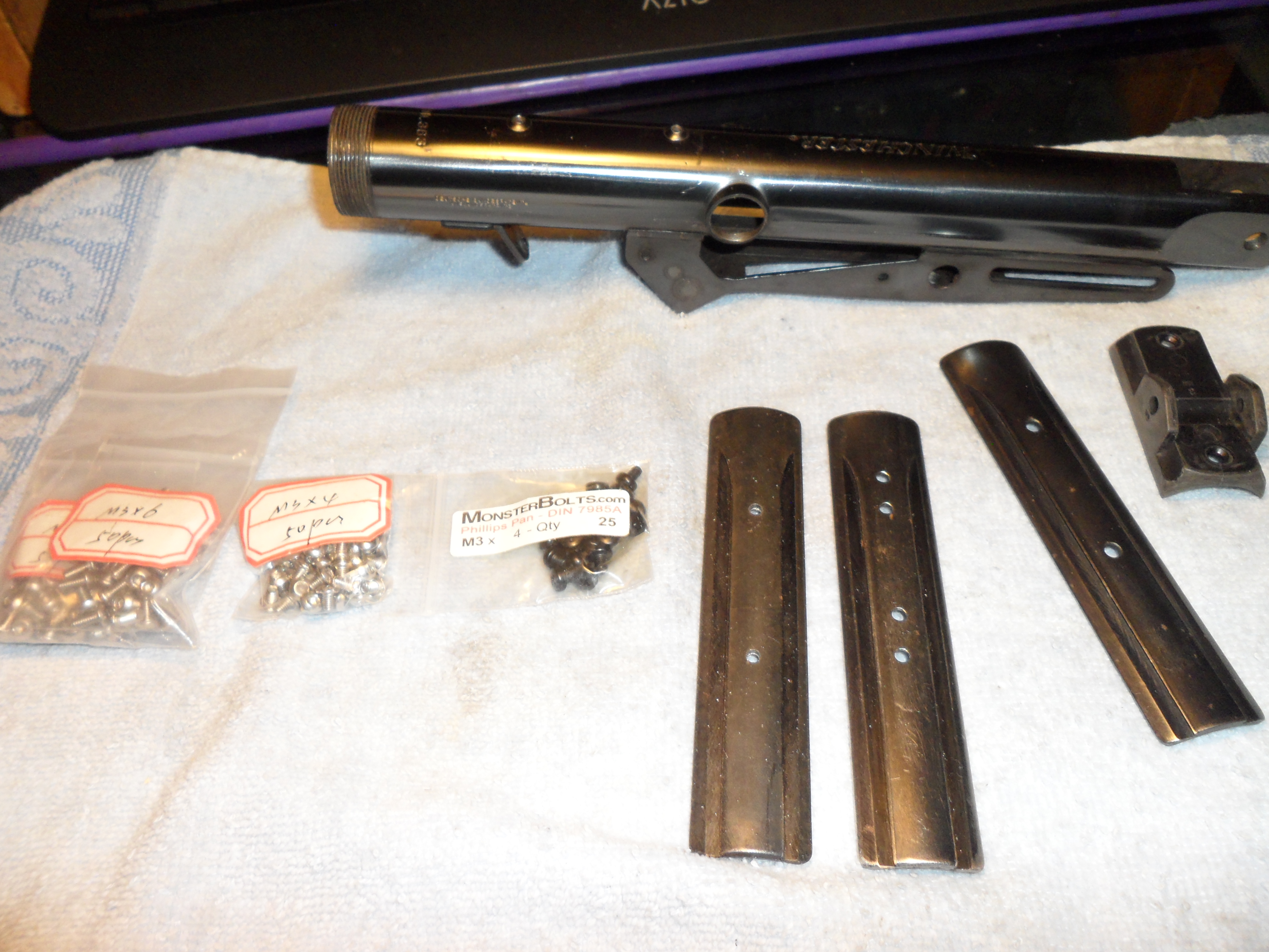

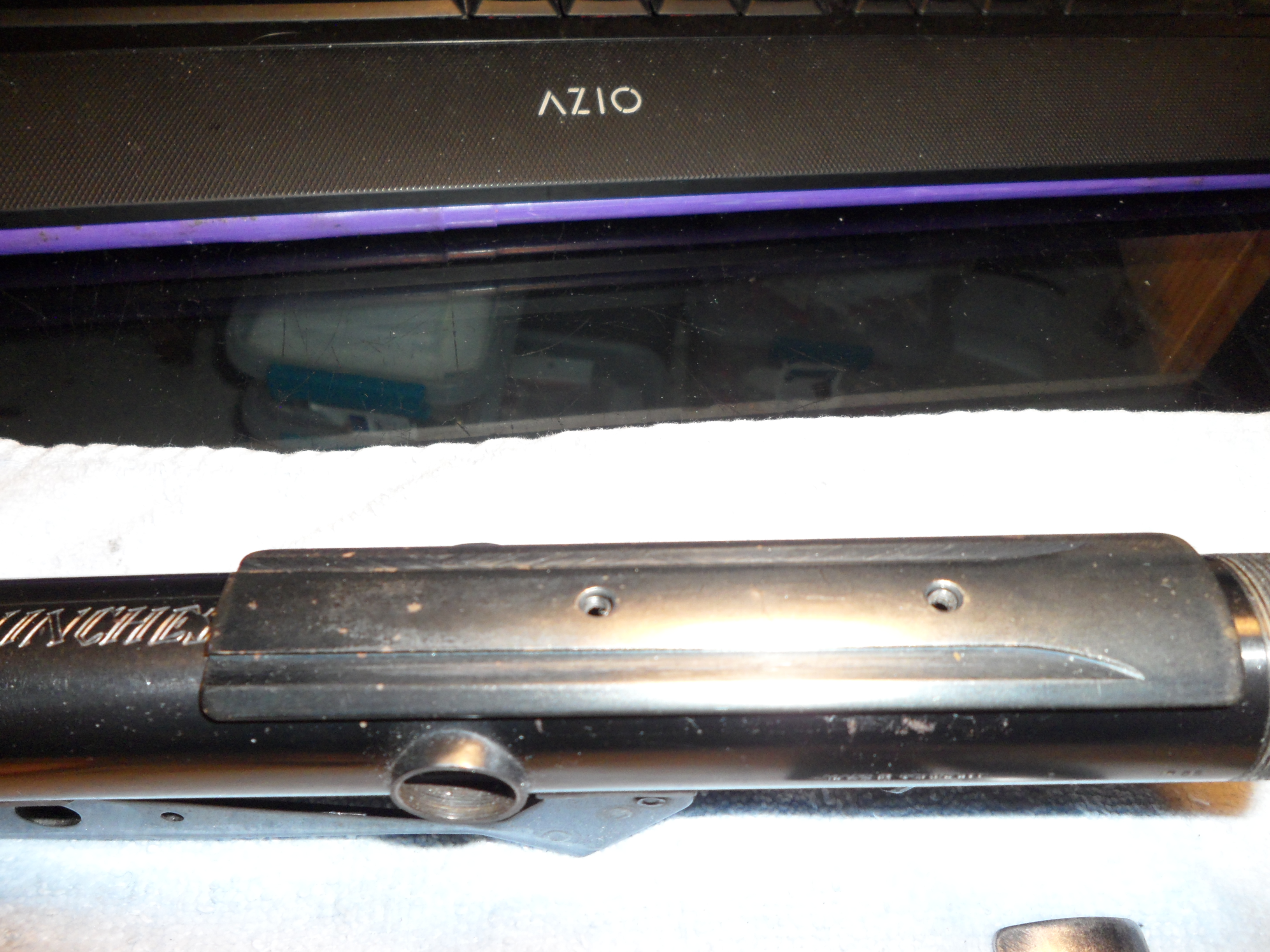

but the high-low problem is all controlled by the breech seal

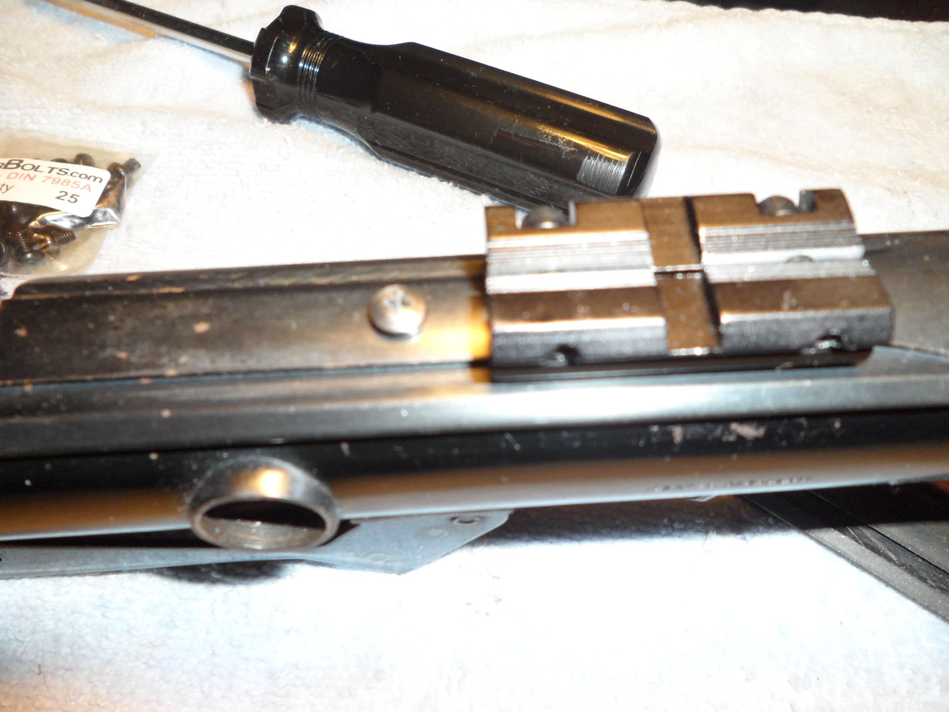

mounting sight on a model 5-6-10 is almost impossible because the mounts are not around anymore, you could find a Unicorn faster
i have made mounts out of some pieces that were on Ebay but it was more proof of concept then these are prefect
https://www.ebay.com/itm/192258428863
the other problem was screws and an empty tube was handy to get that right
the plates are ugly but clean up and also a dead match in width to the factory sight so you have a drilling fixture or a way to automatic center punch the metal
the screws are m3 with 4mm in thread length, the heads were reshaped so a weaver adapter would slide over them, again a project that was proof of concept, was never needed but i have lot of model 5 and 6's
i think a small reflex sight would work well on these a 2X scope as use on these a Willian sight for sure which one is your choice all it is, is a game of what about this could it be done
you see the one with two sets of holes, it ended up too far back, so the two extra holes made it lighter
