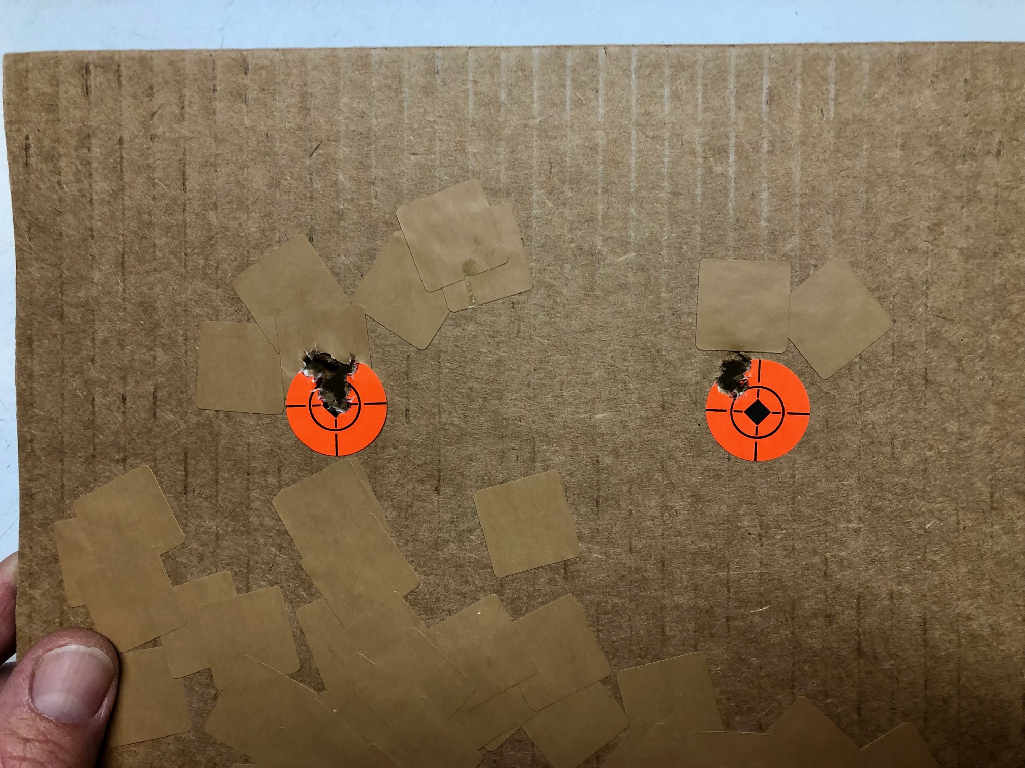

These are the results I'm getting with my Diana 48 / 52 - 15 shot group on left @ 30 yards, 5 shot group on the right - Vortek HO kit, 2 full coils removed, 17 ft-lb power, using H&N BM 10.65 and JSB Exct 10.35 pellets. Good luck !!
