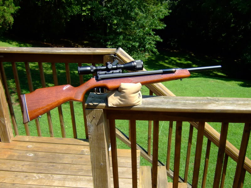

My setup with ARH Grt spring. Accuracy very good. Pest starlings@ 75 yds.
Either caliber is good as you can see from above. Decide which you prefer. 10.3 gr pellets are good if you go .177. It’s a beast of a gun, heavy and a little hard to cock. Not for everyone, but some of us find out we really like it.

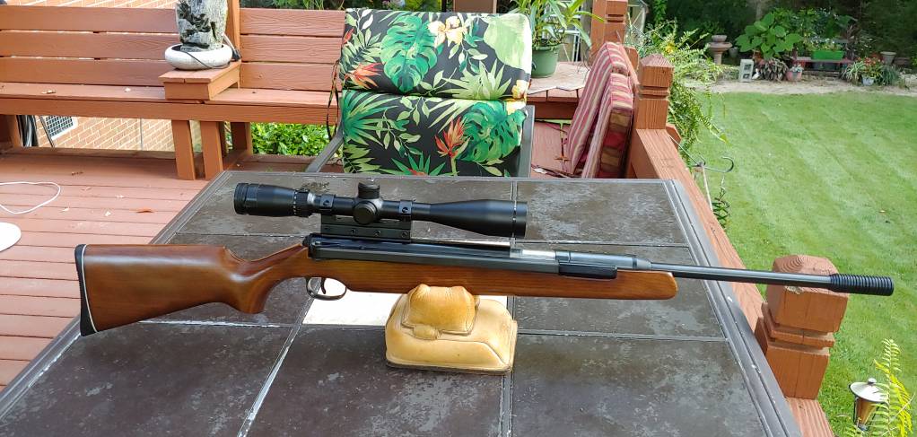

I own a 52 / T01 trigger in .22 cal. Very accurate & smooth firing cycle. This rifle & a second 52 where purchased used. One from a local gun shop & 1 from Gunbroker. The last purchase came with a BSA scope & was $300.00. These are excellent, well made rifles & at the $300.00 price point a real value. If my current rifle wasn’t such a good shooter as is I would have it tuned.
