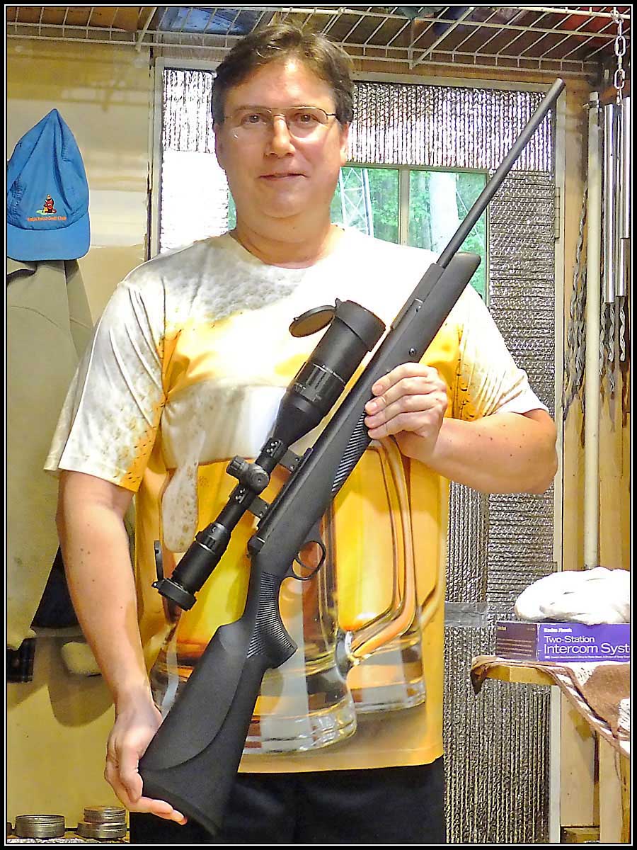

I put on a Leapers 3-9x50 scope with sunshade and looks like I used high rings. It's been 7 years.
I got the compact version but I took off the blob at the end of the barrel because I could never get it to stay tight. I haven't shot it in a long time. I think I ended up putting the blob back on because it's such a nice handle and adds leverage. I used loctite on the set screws. I dubbed it the Black Beauty.
