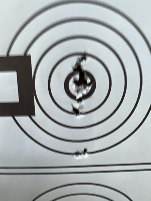

I have a 34 that is probably 15 years old. Maybe 1000 pellets fired. UTG Bugbuster 3-9 AO scope. Always accurate and dependable for pests until a few days ago. Suddenly missing starlings. On paper the shots group but the groups wander. This follows a strange cycle. At 50 feet from a rest I get 3-4 shots in a wide group at 6 o'clock two inches low. Next 2-4 at 6 o"clock 1 inch low slightly tighter group.. Next 2-3 shots 12 o'clock 1/2 inch high. Next 10-15-20 shots X one (large) hole. No adjustments made to the scope. I set the rifle down and replace a target or what ever and 9 times out of 10 the pattern repeats from scratch when I pick it back up. I went over every bolt and screw in the rifle and scope mount and all are tight. Doesn't matter what pellet I use of the several I have available. Bore is cleaned with pull through patches or felt pellets about every 100 shots. That doesn't seem to alter the cycle. This cycle has repeated more or less the same perhaps 10-12 times.

Thank you for responding. I will test the breech seal and get the appropriate lube before calling this issue solved, but earlier today I pulled the scope and fired 50 pellets with iron sights. The group was centered and I had a few fliers but I called them all. Hardest part was seeing that tiny little black needle alleged to be a front sight. I had to print a target with a red center ring around a white X to use it at all. My buddy has a newer version of this rifle and it has fiber optic sights. I'll have to see if I can get them onto mine.

Considering their cost and apparent ease of replacement I ordered several breech seals from Vortek. Since the shipping is flat rate I got a couple for my friend who also has a 34. If we don't need one yet we will eventually. I did not see vertical stringing with iron sights. I tried the tissue test and there was no movement. I reckon a bit of gas could be leaking out the bottom though, so for a buck I will replace the seal on general principle. I does appear a little flat.

Unfortunately I do not have access to a chronograph. I have to think that the scope was the main culprit since using iron sights did not produce vertical stringing. It probably is time for the rebuild you mentioned. I'll look for articles and videos and research supply vendors. Is there a specific video channel or vendor you think would be more useful? Also, any thoughts on finding fiber optic modern sights? The only references I found to them were out of stock in Australia and Pakistan of all places. I would not be ordering from there even if they were available. Is there a compatible brand that you know of that parts might be easier to access?
