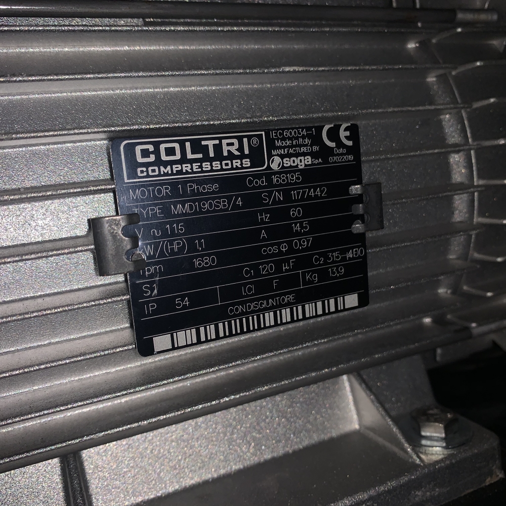

GREAT info! The faceplate on my motor leads me to believe the wattage is 1667.5 (115v and 14.5A). I had the thought of using one of my 3000w (APC) UPS battery backups in front if the generator. I have these:
https://www.apc.com/shop/us/en/products/APC-Smart-UPS-3000VA-LCD-RM-2U-120V/P-SMT3000RM2U
Specs are down the page. The wattage might not cut it though, based on what you said. Here is the faceplate btw..
I don't know how to tell what type it is but it's for sure a capacitor motor with two apparently. Anyway the Honda would be near full capacity running it if it can start it which doesn't look likely.
100% -- Alan_B shared some pictures of what appears to be a start capacitor and run capacitor which is housed in the box where the shut off switch is located. There was a shunt resistor between the blades for I assume overcurrent protection.
One is 120uF the other looks to be 315uF 400VAC -- labeled as c1/c2 on the top of the control box.
Edit: I'm blind, but yeah the motor plate matches up to the information on the control box.
