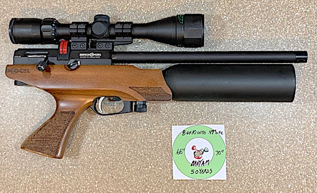

So I built a purpose-specific TFT pistol from a .177 Brocock Bantam Hi-Lite rifle, that outshoots its former self. Having souped-up the rifle, I had to actually DE-tune the pistol to get below 20 foot pounds. GREAT FUN knocking over three-foot tall coyote and elk extreme field targets at 55 yards!

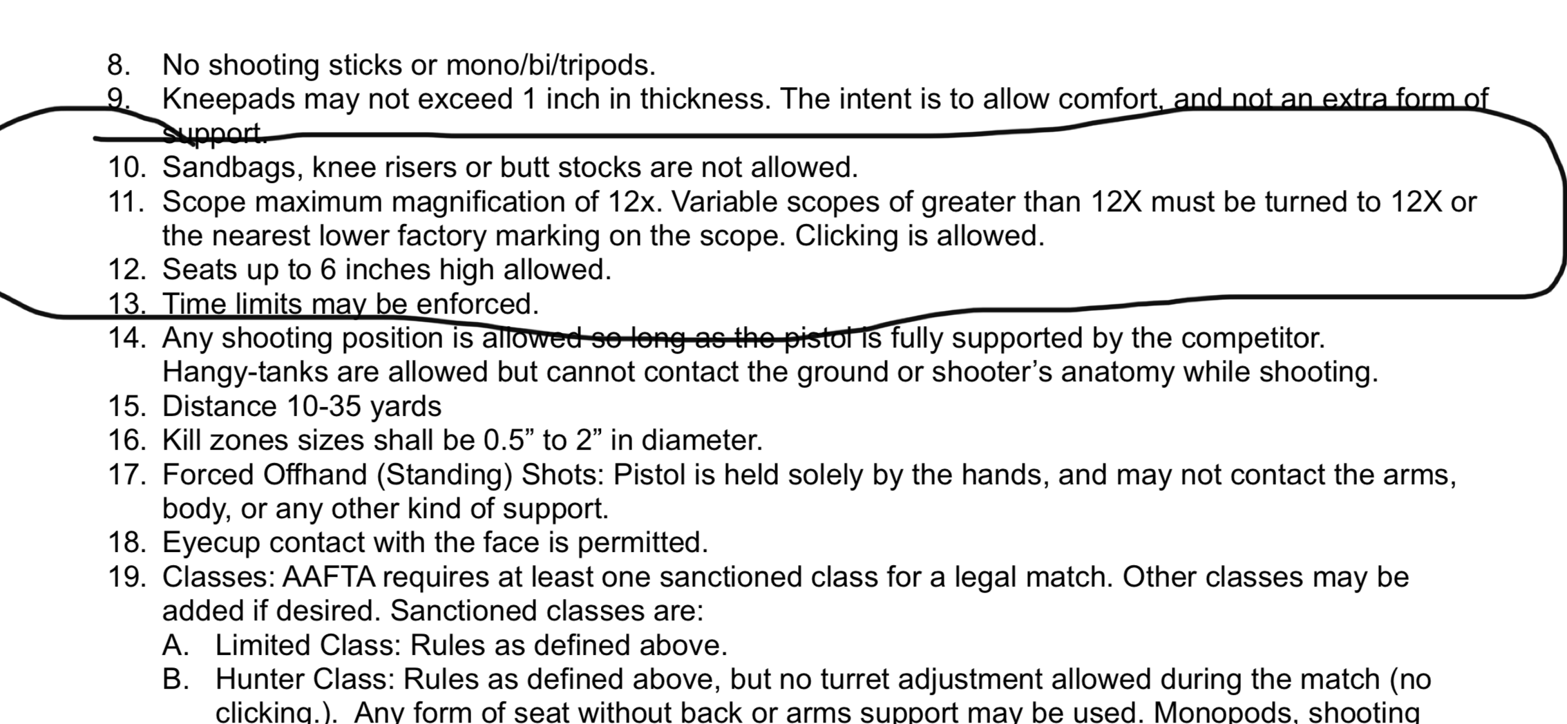

The image that Jon provided is older and doesn't show the important sentence added to rule 11 for EPFT "Elevation and windage adjustment turret clicking is allowed." Bear in mind that these are the rules used at Ron Robinson's matches. They may do things differently in AZ or elsewhere. Ron also specifies two classes, the only difference being sticks being allowed.

YES ... limited PFT I'm well aware of the AAFTA rules allowing clicking. Question was EFT Pistol which is NOT an AAFTA class.
Tho thank you ;)
Oh sorry that was meant for the people that said you can't use scopes that go above 12 power for AAFTA pistol but you can as long as you put it on 12, but you know that. For Ron's you can dial. I am this weekend for the match. Sorry for the confusion
