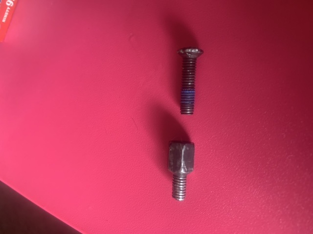

1582384770_20210343385e5146826dced9.37251860_42DA0FE4-86D7-4712-B99C-6645D8819EFB.jpeg
Local hardware store should have the attachment stock attachment. the what appears to be the part that attaches to the receiver is another story. See the threads are trash could be chased with a die and might be usable.
The main issue would be how bad the threads on the receiver are. Bottoming tap might make it usable.
Not had one of the new guns so this adapter is new to me? I have seen this on other brands. Not sure that the adapter has to be removed to rebuild. Older models I think had the same attachment as the Diana 34 that the stock attached to the trigger group. This gun was before the elite the Blackhawk which was a clone of the D34 and the Xisico XS25 or B25. Looks like the new elite has some different hardware. jmo
Flying Dragon can help you out on parts and save you money.
