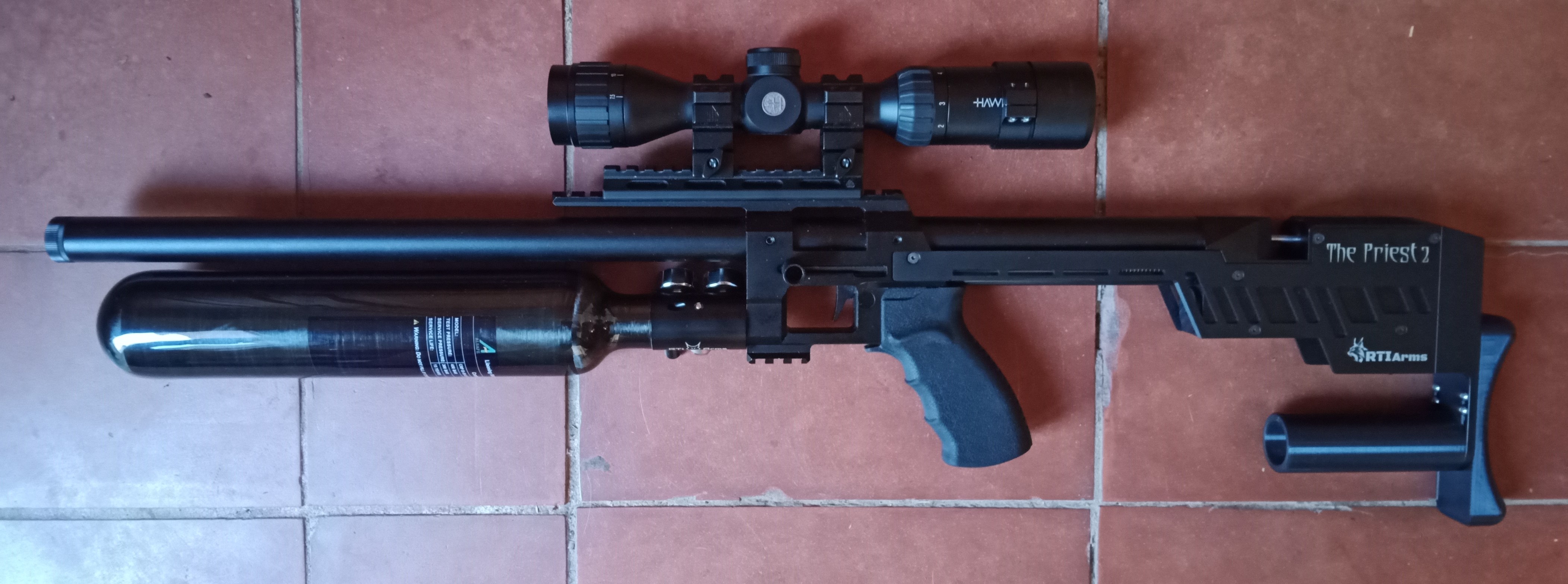

I'm from Italy and we have two options : below 7,5Joule or over. My choice is the Priest 2 .177 in 7,5Joule( I got HW30, HW50, HW977 and a Pardini GPR1). Two friend of mine made the same choice too even one of them previosly got a P3 .22 full power and the other one got a Weihrauch 77 .177 full power(both have a long experience with firearms). Why they made this choice? Because of the best compromise in price/quality, best affordability, the customer service provided by the factory(Rok is #1), the shot count and the best compromise in case of ratting till the 25 meter distance. Do you need more? You may upgrading to the level you want...
