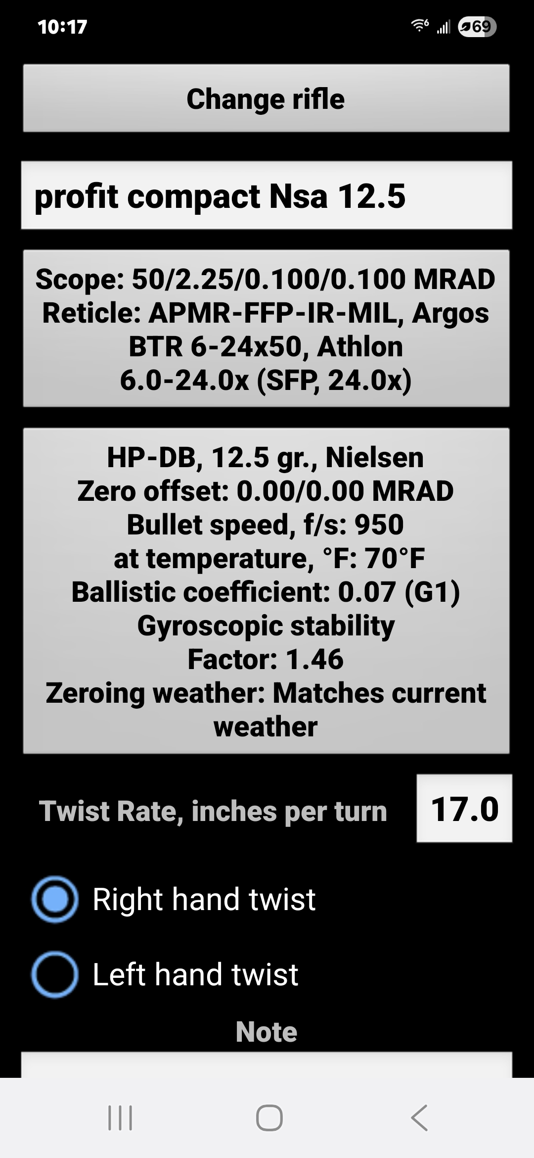

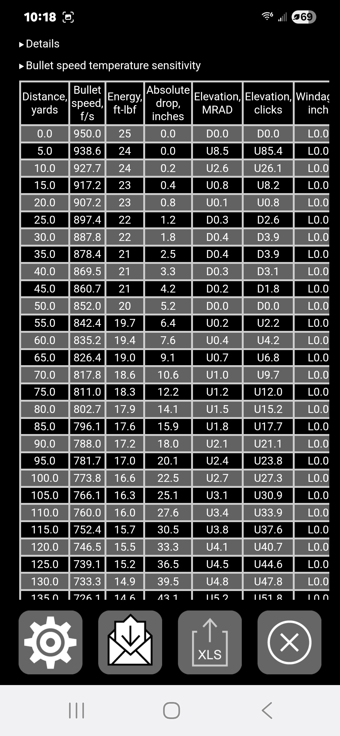

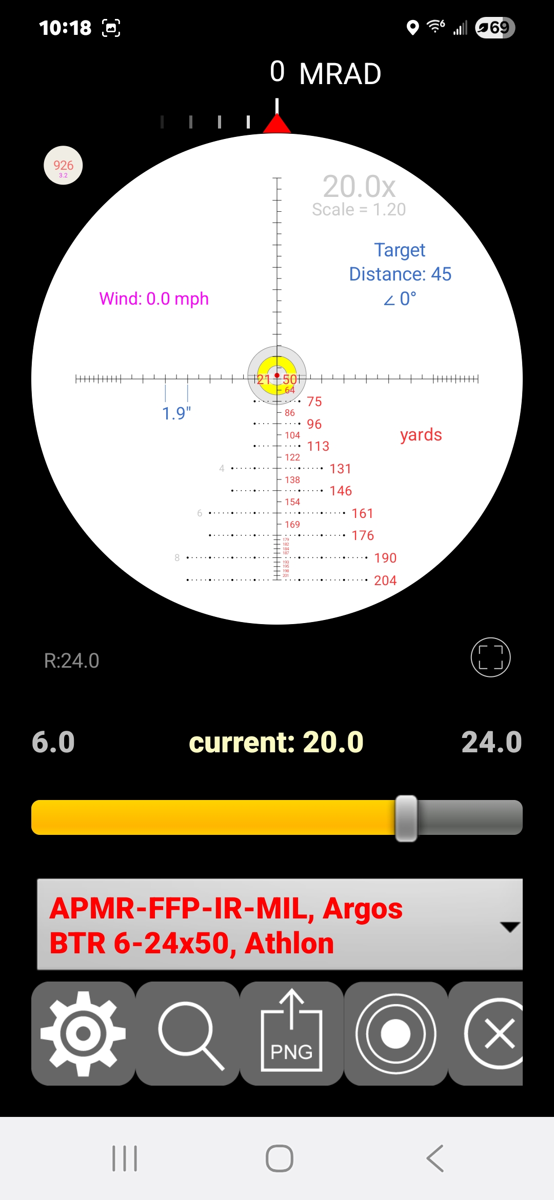

@ max, welcome to the forum. I have the compact performance in .177. Absolutely amazing little package. The external adjustable reg is nice to adjust on the fly. Mine set up as slug gun. Starlings @ 100 yds no problem. The prophet 3 is just an upgrade from original. You will be happy with either.

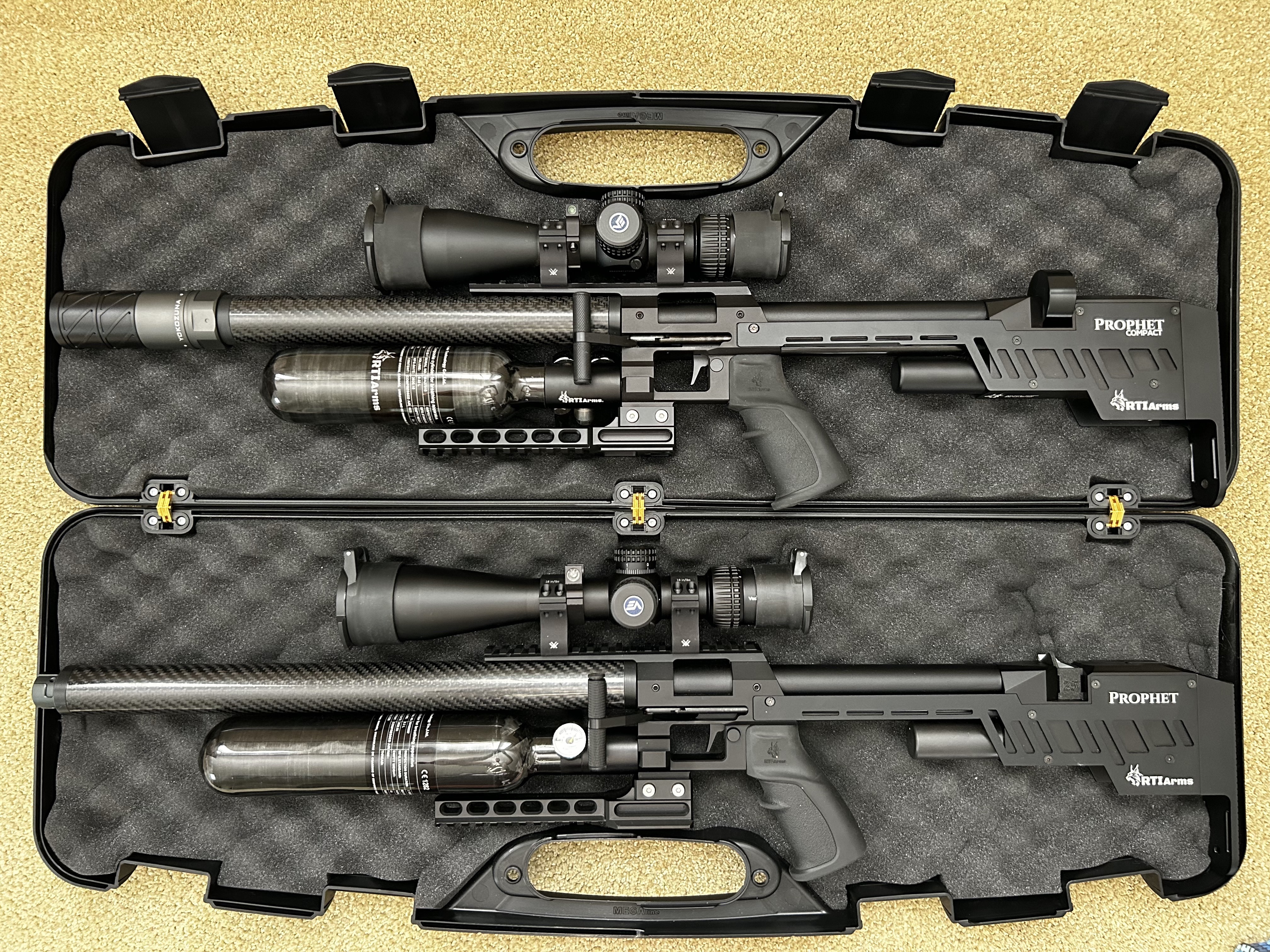

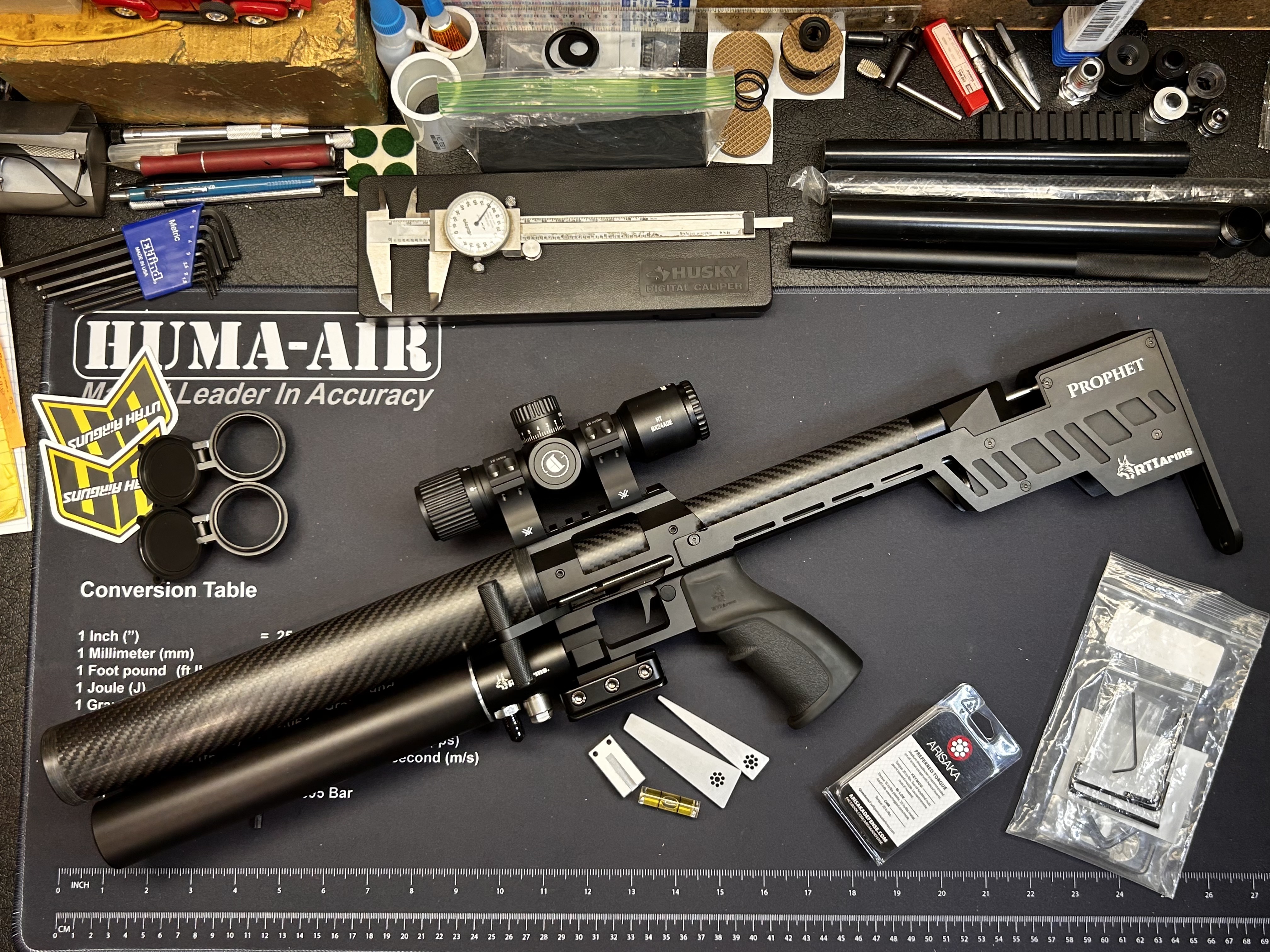

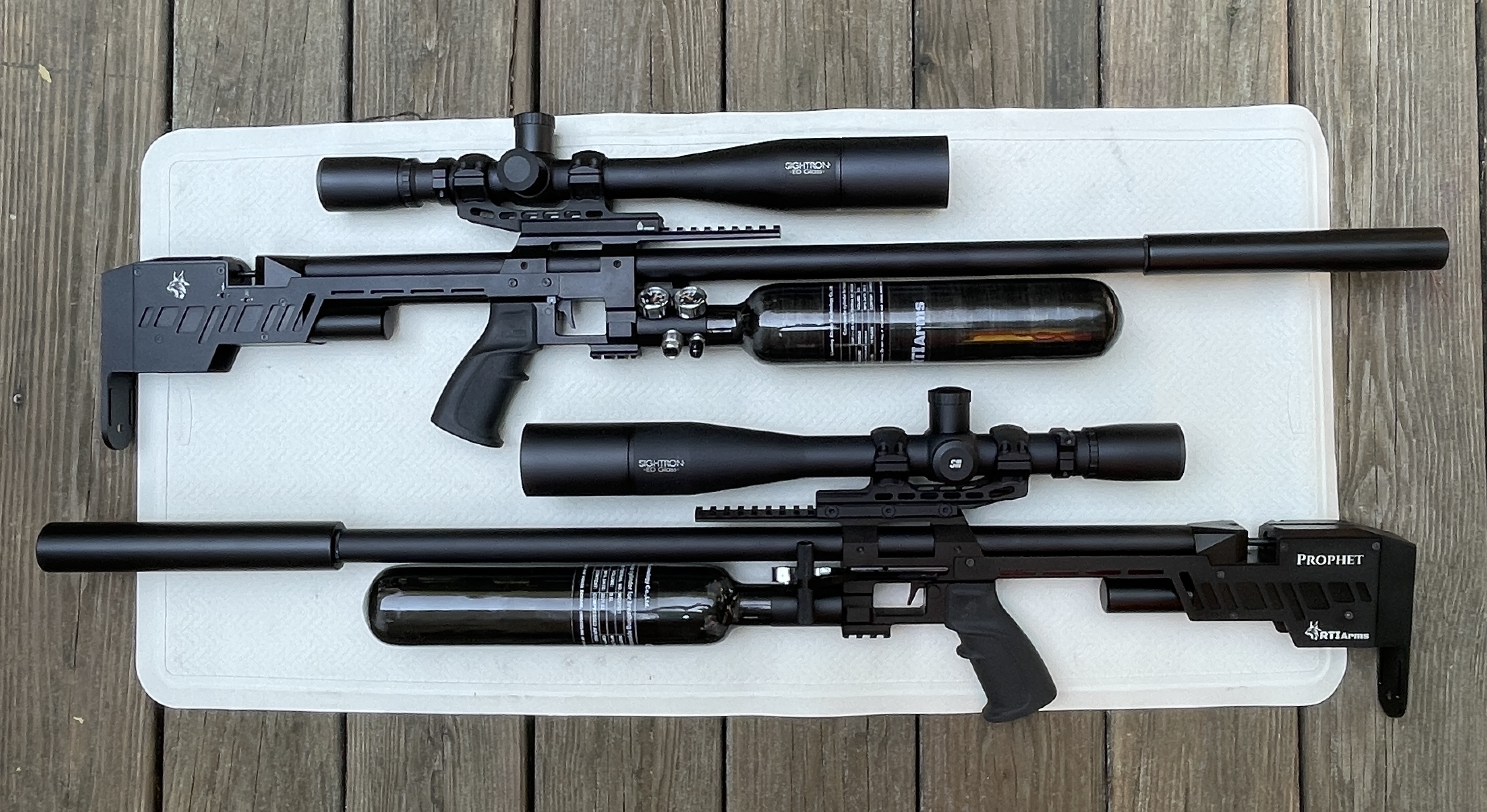

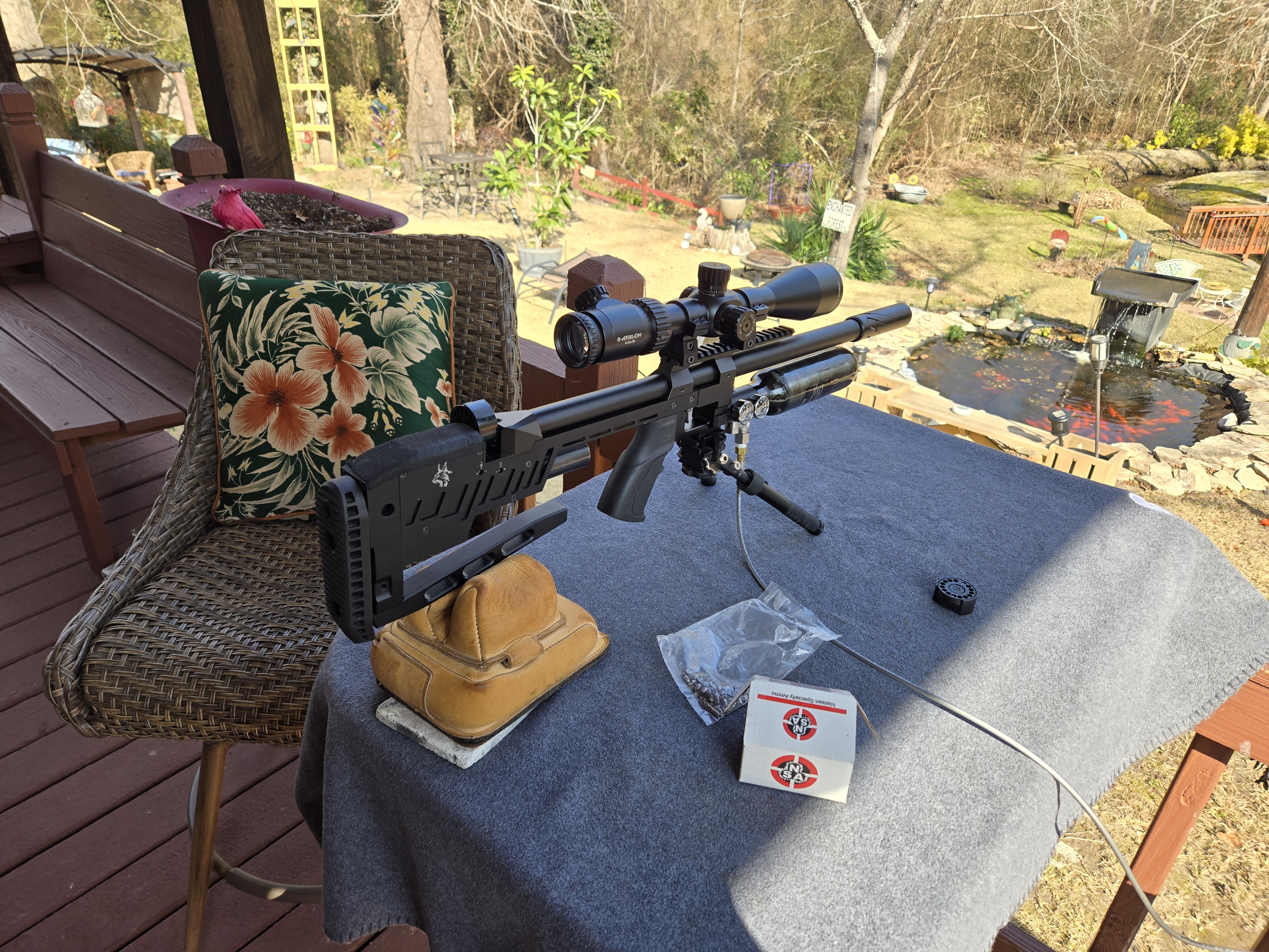

The P1 Performance Compact can use either 400mm(16") or 500mm(20") barrels. I have a .22 500mm CZ barrel that can easily push 22gr pellets to 890fps when the regulator is set to 125bar. I have a .22 400mm CZ barrel that pushes 16gr pellets at 950fps at 125bar. I have not tried the RPB barrels in my P1s...yet.
The OD of your Leishy 350cc bottle will be the determining factor as to whether you can use it. That and the thread size of the bottle. With the standard 25mm shroud, the max OD you can use is around 61-62mm. You can see the clearance from shroud to bottle in the above pics. The Performance Standard comes with a 500cc bottle that it ~60mm. The 220cc Compact bottle is ~54mm.
You mentioned a different charging handle. I think you're referring to the "push-pull" handle found on the Priest and Priest2? All my P1s have an articulating charging handle.
I haven't needed parts for my P1s (owned since 2022), except for a regulator rebuild kit to cure a "creep" problem. If you do need parts there are multiple stores that sell them..RTI Arms Spain, AirgunHeaven in the Netherlands, and direct from RTI.

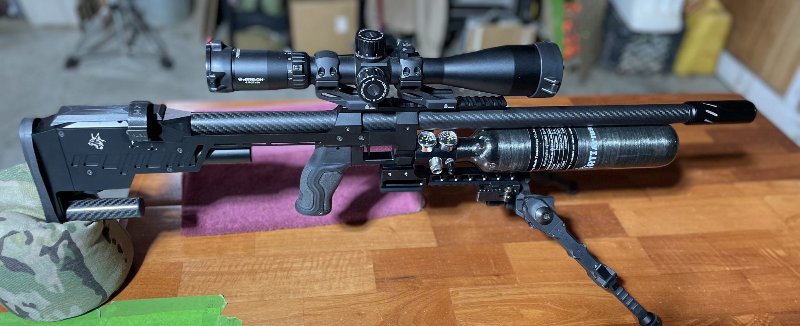

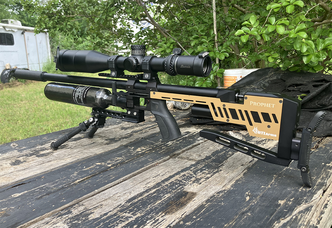

I cannot comment on the P2 or P3, but I did buy a Prophet Performance with the .22LR right after the P2 was officially released. I did this because I liked the simplicity of design and also hoped I could get a decent price on the old tech gun, and that I did.
As for the RPB barrels in the P3's. I later bought a .25 RPB barrel and am using it in my P1. It shoots very well in the Prophet. Both pellets and slugs.
I doubt that parts are going to be a big issue, but who knows. All I can say is that in 3 years and somewhere between 20 and 30,000 shot fired, I have had one leak from the fill fitting and early on a cracked side lever that was replaced with an updated part. Other than tat, I have had zero issues.
I am sure I will have other leaks, but o rings are o rings.
