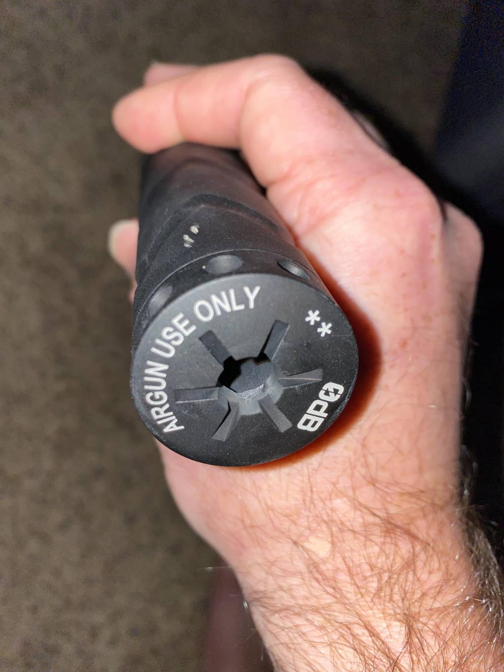

Alright, quick update: I told you my newbie status would rear its ugly head... I took me quite a while to translate the responses because I wasn't familiar with most of the terminology being used. So, had to do my best to figure out "what was what" on the gun.
The long and short of it is that I took the Mod off and shot through one magazine with 33s and, aside from my scope needing to be brought almost completely back to zero from where I had it out in BFE, I seem to be relatively solid in accuracy and consistency at 35 yards. I definitely plan to try it further out too, but it's pretty clear to me that all-or-most of my problem is the Mod. I actually snapped this quick pic to show some damage I noticed on the end (don't know the name for this...crown?) of the Mod:
Pretty glaringly obvious that's a major source of a problem. Now I just need to figure out how to fix this thing or if I should just throw it in the trash. After the headache it's caused, the latter is sounding like the best option. Any suggestions? I was able to open up the bottom area where it screws onto the barrel (or shroud?). A long metal sleeve (maybe a baffle?) slid right out with a washer looking piece behind it. There looks to be one or two more of those same setups in the Mod, but they don't just fall out like the first one. The other washer piece in there doesn't look to have any damage, just the crown (?) area in the pic.
I don't mind buying another/different Mod if that's my best bet, but thinking maybe I should check out the crown and shroud on the gun too, in case that's where the problem is starting? I can confirm that I have always made sure the Mod was screwed onto the barrel very snug (by hand).

Nice pic of the 0db. Your symptoms do not necessarily indicate an issue with the shroud + barrel alignment!
Get another 'Mod' and go from there. I have a 0db and it unfortunately does not 'play well' with my RTI Prophet Performance Compact .22.
In my case the shroud has baffles and that may be the reason for the air quality being poor when entering the 0db, no clipping but less than what I want for accuracy. It's a tiny bit different POI with the 0db, slight fliers, but I am spoiled and will tolerate ZERO of that.
Keep the 0db for another gun that will probably like it.
