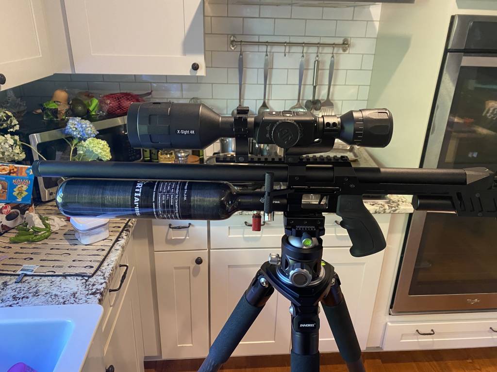

I received a new reg from Mr. Rob via AoA a few weeks back.(warranty) clocked the bottle so reg and fill is @ 6 o’clock. Filled with air and sealed just fine as described above.
Note…. Since the manifold isn’t tight/flush against the action/block, doing so you may experience the bottle pushing up against the shroud if you rest the bottle on sticks/bag etc. Which could change your POI. So I’d recommend you use a bipod if you go this route.

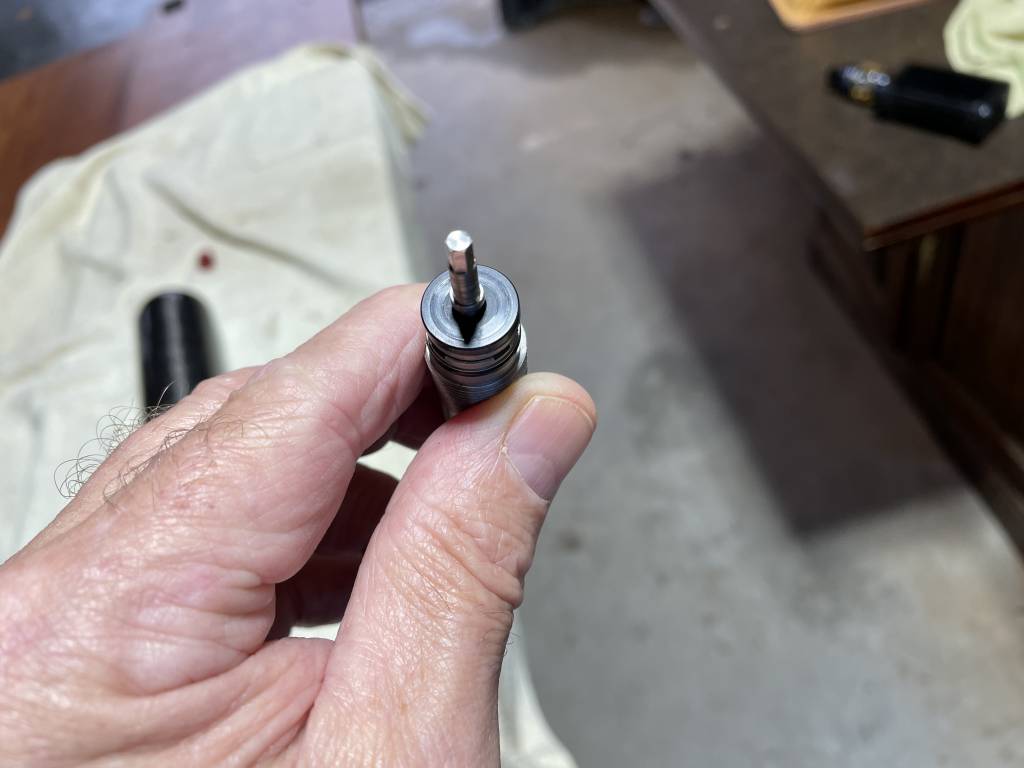

That's my pic of the new design internals on the left. So far they have held steady pressure.
I had emailed RTI and ask about the creep. Got a response in a day or so. Was told new regs were on the way by slow boat to AOA. About six weeks later AOA called and told me they were shipping new internals to me. RTI also sent a hat!
I don't think it is possible to get the seat off of the shaft on old or new to lap the surface. The collar appears to be pressed onto the shaft.

My foster was pointing inconveniently and yes it seals just fine when rotated to the 'convenient' position. Put an o-ring between the reg and receiver to tighten against. It works.

Vetmx and Scotty, thanks for the pictures…and to Brownie for the comment about the seat being press-fitted to the shaft.
In that case one way to dress the seat is to drill piece of hardwood so the regulator’s shaft is a close clearance fit. Then prep a piece of sandpaper with a matching hole and glue it to the jig, then insert the part and spin it. Be mindful that you don’t want to generate so much heat that the plastic will melt so start with a coarse enough grit that it will be able to level the surface without having to stop a bunch of times to let it cool. Then change to a finer grit to smooth the surface.
When you get close, use a paste abrasive like J-B to lap it to the regulator body. Color both surfaces with a Sharpie. When the marking wears away in a clean concentric ring on both parts, you know the surfaces are well fitted for a proper seal.
I’ve fixed some stubborn creepers with this approach. It also works for repairing a poppet that has sustained damage from a piece of debris or mishandling.

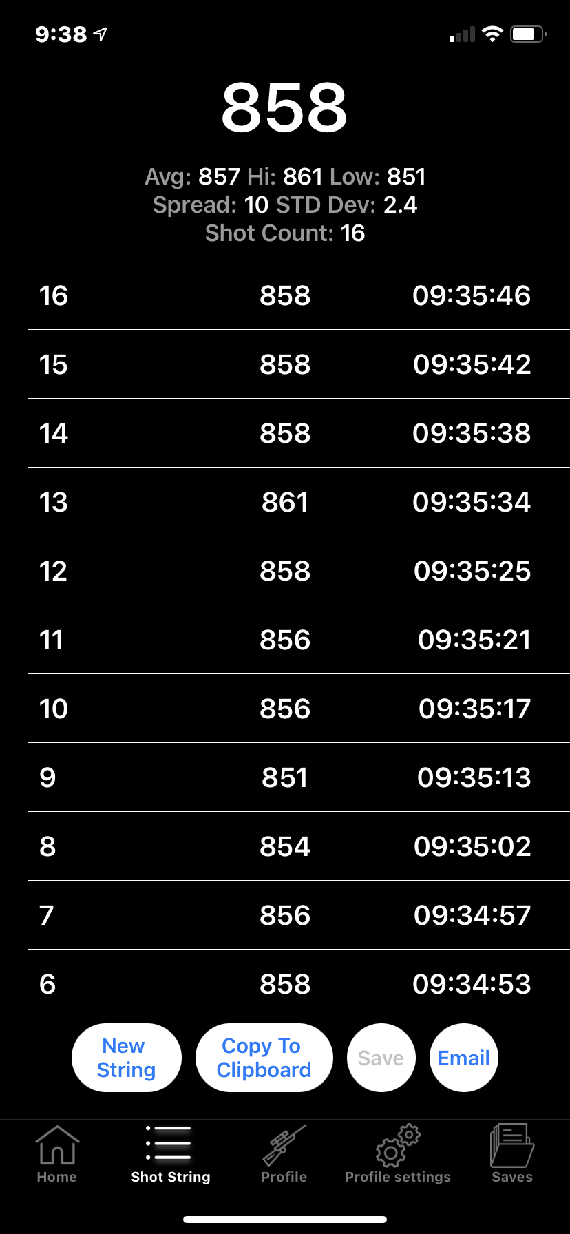

loaded a magazine and shot over the Chrony while adjusting the reg to achieve my desired speed of around 970.
reg now sits at about 145 and has held steady since and that was two weeks ago

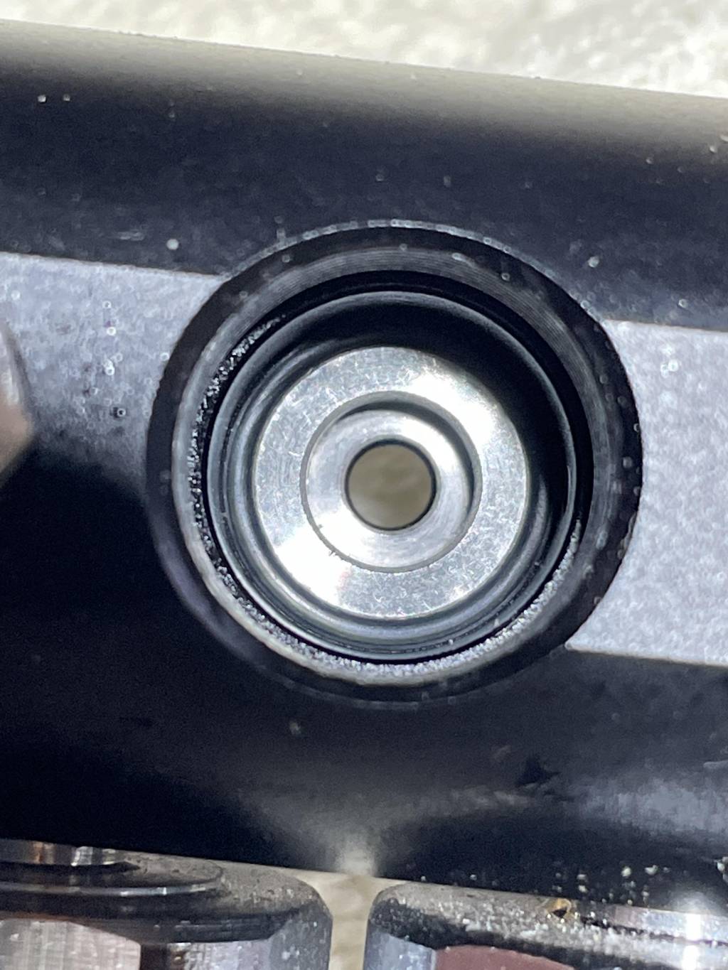

Nervoustrig, I’m not sure the assembly will turn, possibly just the adjustment grub screw spins, adding pressure through the springs?
here are a couple pics….
it looks to me like the seal is only the o ring on the perimeter?
