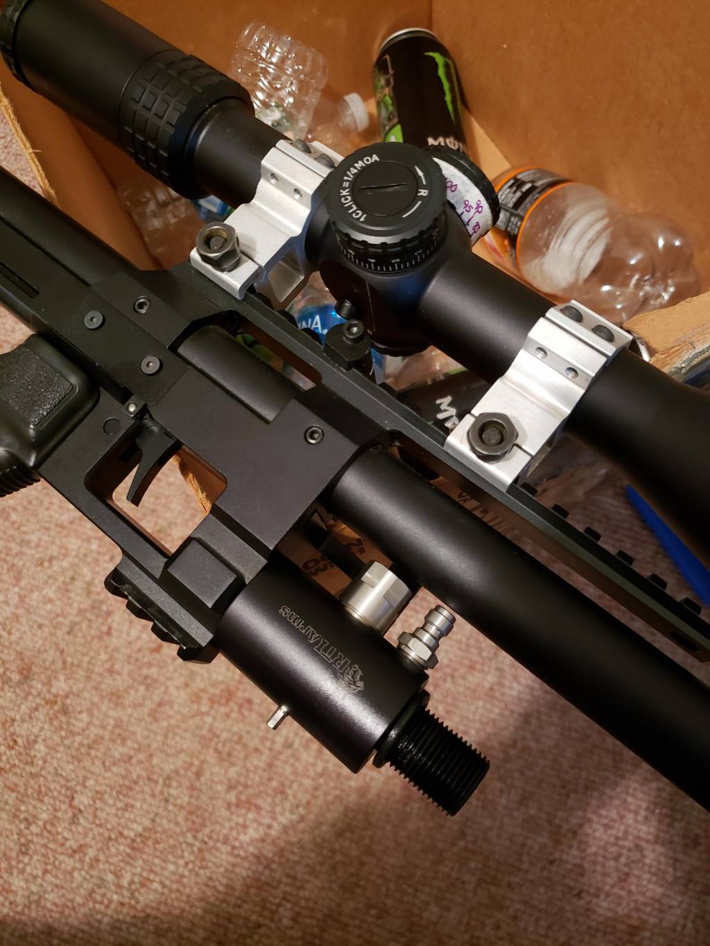

{sigh} OK guys ... so yes @alias - that's how you bleed it. I got the thing apart and the FIRST thing I noted when pulling it apart was that it seemed like there was a 'gap' like the reg body wasn't actually making contact with the trigger block where it screws in . . . it came undone with zero effort. Unscrewing the bottle off of the reg body actually did require a little effort - but no big deal - it spun right off. So I get it apart, clean threads out, wipe down and relube with silicone lube the couple of o-rings that are visible and now I'm in a 'stand-off' with the thing.
What am I missing??? *Every Time* I turn the reg body back in, the fill port and reg adjustment wind up, well -- upside down. Am I supposed to recite some ancient Slovenian text from a long lost scroll while petting my dog at the same time and checking my facebook feed using my toes on the cell phone?? Those of you who have pulled this thing off and then put it back together - how did you manage to get it to wind up back in the right position?? I've tried several times now to get the threads to 'bite' when it starts threading back in from different 'clock positions' - ie; last attempt I ~thought~ it started to bite @2:00 . . . nope upside down. The I try 7:00, thinking opposite start - maybe it'll finish up the right way. No joy - *EVERY TIME* it winds up bassackwards like this. {sigh} Grrrrrrrrrrrrrr . . . . . ( lol )
What am I missing? It isn't *supposed* to be "loose" and not threaded all the way in is it???? That just doesn't jive.

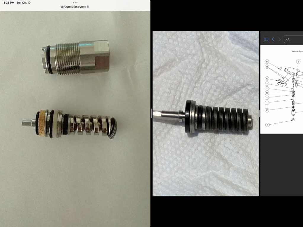

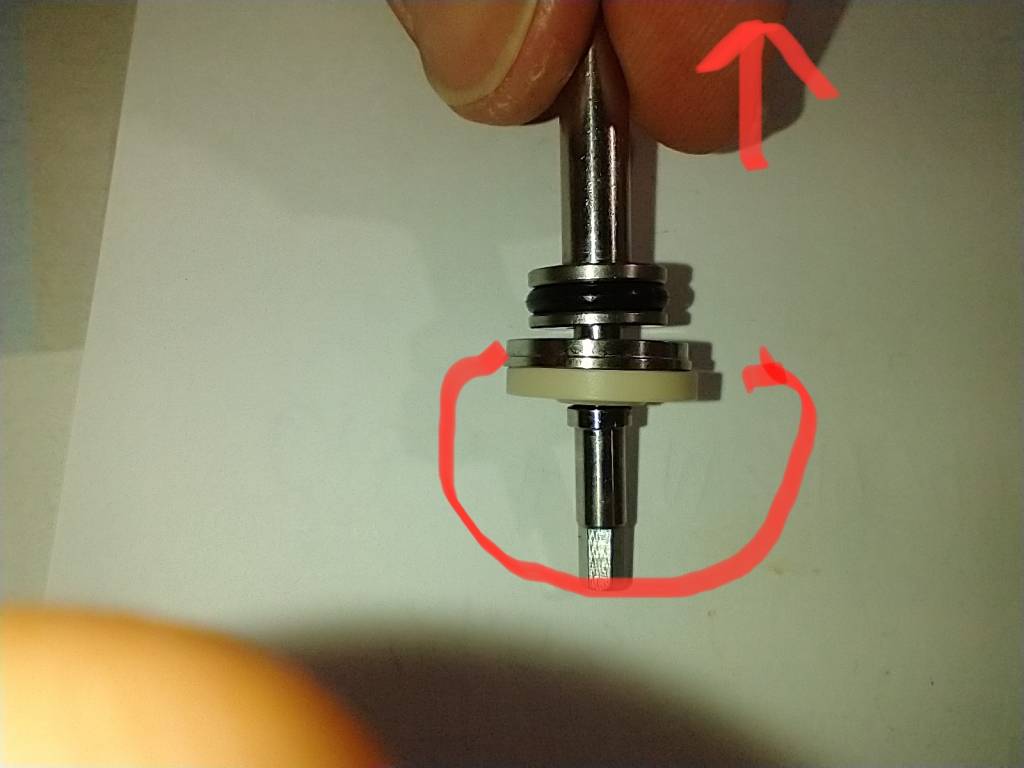

Months ago I was corresponding with some fellow RTI owners trying to help them with reg creep on the newest version reg. I went other routes with my RTI when I completely failed to be able to get their gen 1 adjustable to perform to my satisfaction. Guys sent me pics of the internals because like you, I know the seat has to be addressed to cure it. I even built a Peek seat for mine and got the creep under control but still wasn’t happy with recovery or consistency. When I’m done typing I will see if I saved any pics of the important parts of the newest reg these guys are having issues with. Without having the reg in my hand I can’t tell them exactly how to address the seat problem. Maybe you can from the pics. The stuff I drew in red is the area I would look at if I remember right. It was a while ago. The damn thing is just a too complex side filler because they want to keep it compact.
Good stuff. Thanks to all of you for the input guys! I've got it back together and, well ..... as weird as it is NOT snugging it down - yeah - it works. I didn't actually get into pulling the reg apart - this was just a foray / recon into pulling this gun apart as I mentioned earlier - I never have. Baby steps. ( lol ) My m-rod, taipan's - I've had them *completely* stripped down lots of times . . . .
