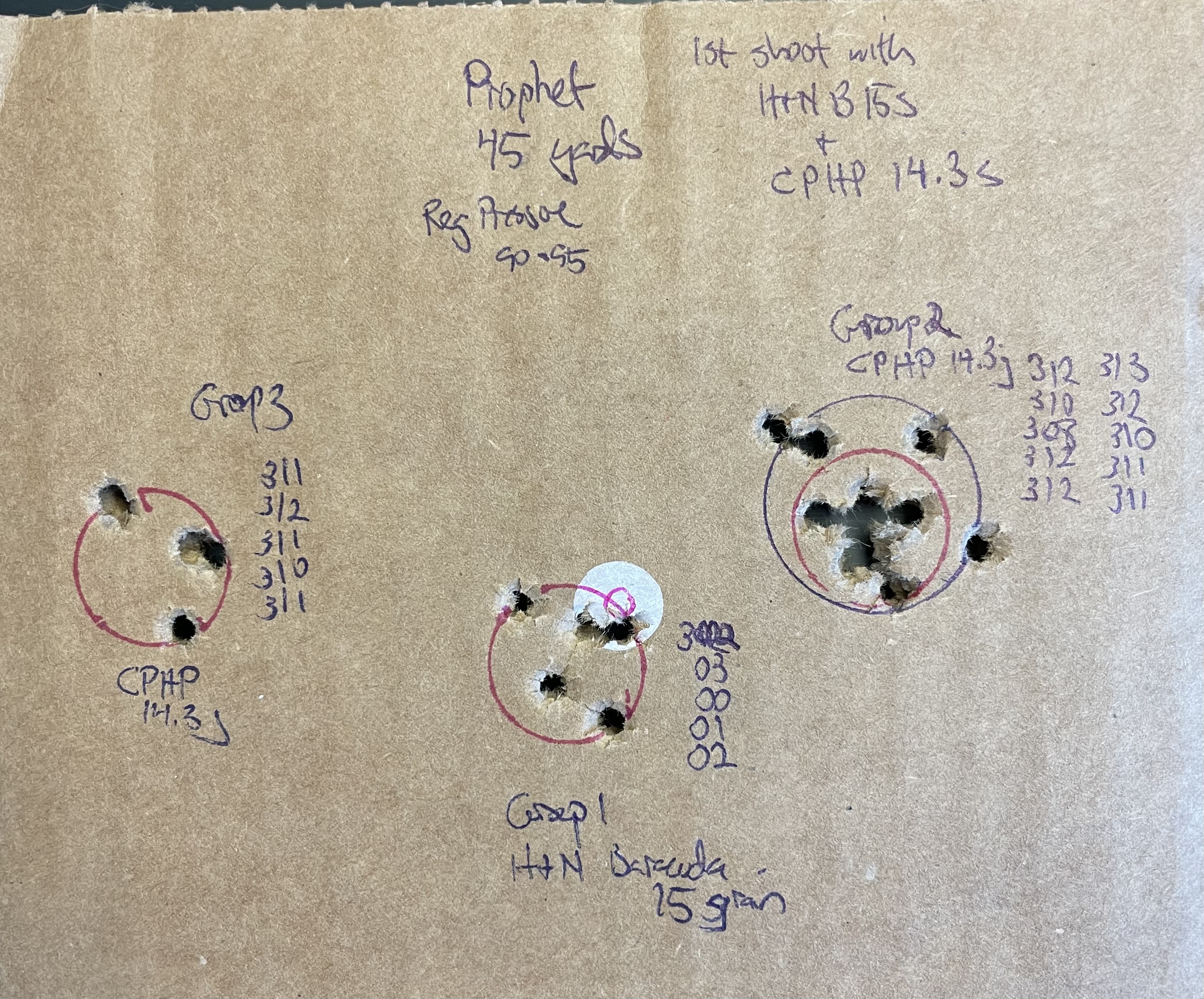

But its fun to shoot lighter pellets at crazy velocities and still retain accuracy. Here are some groups with CPHP 14.3g @1,025 fps (!). The pink circle is US dime, the blue circle is US quarter. (Just used my 18.13g tune - it shot the CPHP at 1,019 - 1,025fps with this tune)

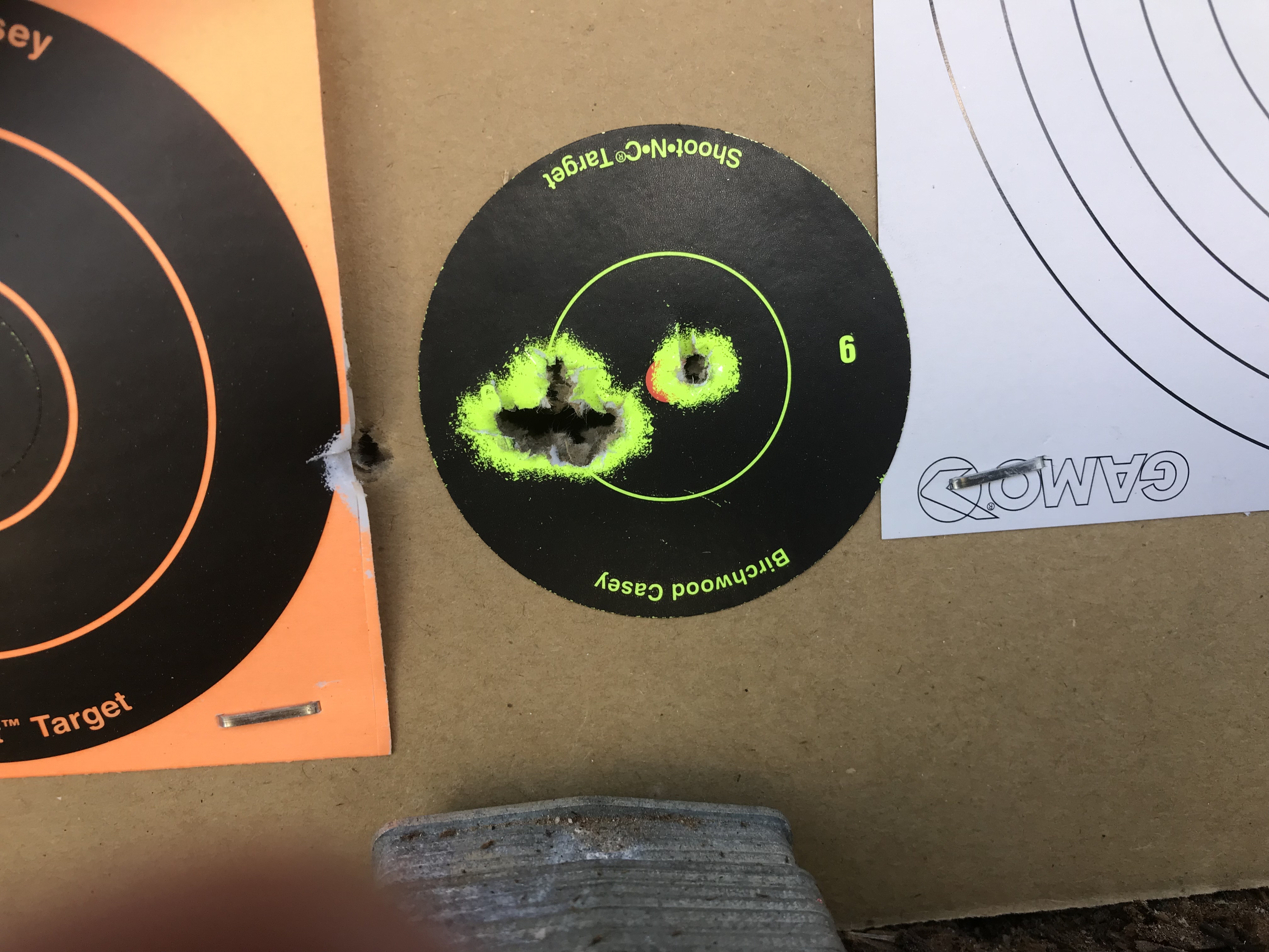

Talking pellets , My RTI PP 2 compact in 22 caliber with the 510mm CZ barrel loves the Hades JSB pellets shooting at 980 FPS , Just kind of stumbled across the Hades was shooting the JSB 18 gr very well, Had a few 22 caliber guns on the shooting table , Cricket , Mutant, Just for grins loaded a few Hades and wow , 16 shots with the new Orion magazine, and of course I pulled one, 48 yards slight wind ,
