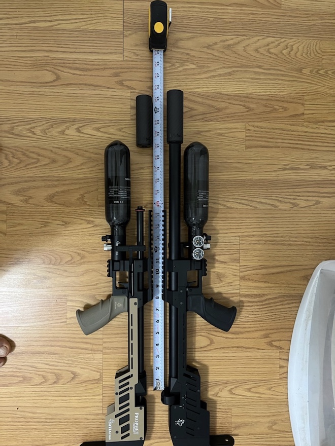

So a friend of mine with two 30 cal Prophet Performance Compacts wanted to improve a few things. One of the issues was clipping and the other issue he wanted to shorten the shroud. The second photo is a recent result of Bullysyclones work.

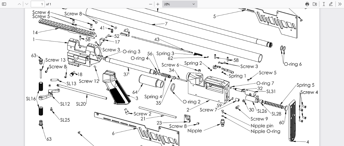

all pcp guns need work from time to time , but sounds like you used all the air and you cant fill it cause it is leaking out of barrel , cock it first and then fill it if this dont work the possible the valve has debris on it or broke but many guns leak while filling if they are empty unless you cock them , I do own same gun let me know after trying this they are a basic gun to fix
LOU
COCKING IT SHOULD HELP FILL IT IF NOTHING IS WRONG HOWEVER IF IT STILL LEAKS OUT BARREL DURING FILLING IT NUMBER 34 IS THE VALVE YOU NEED TO SEE IF IT HAS DEBRIS ON IT OR IT IS BROKEN , I HAD OTHER MAKES WITH BROKEN OR LEAKY VALVES BUT NOT A RTI
