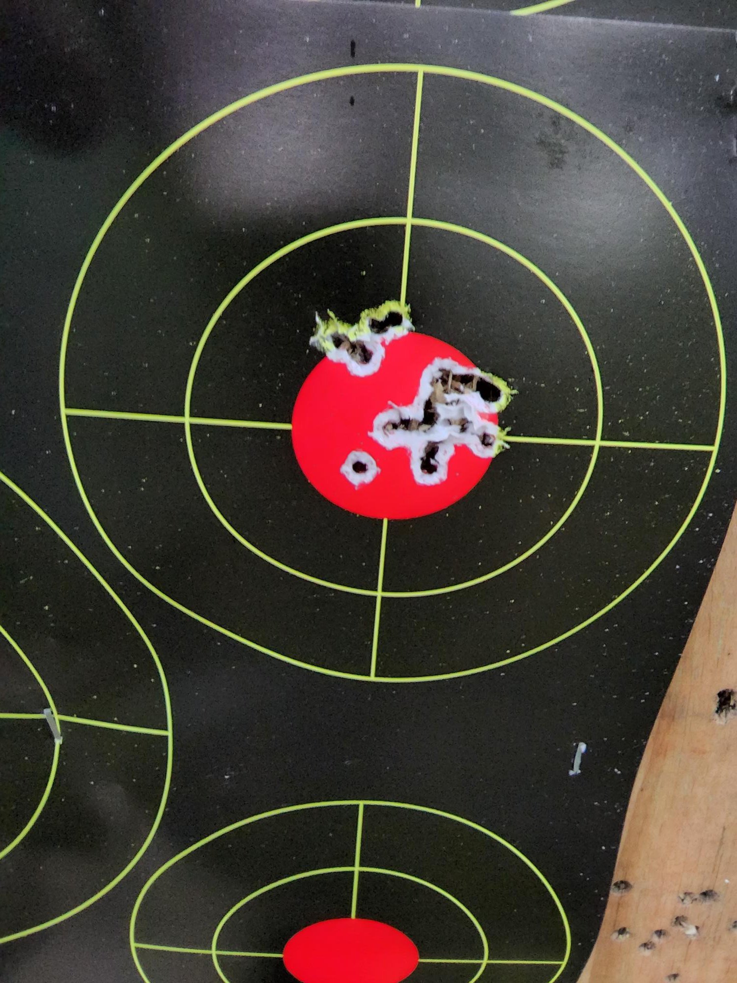

cool, appreciate the reply - just shot a round of 91yrds (backyard, that's it) with the 48s @ 88fps - top group is 6 shots - turret adjustment - bottom group is 20shots. sad but for the HP-BT - 48 is the lightest Griffin makes and they shoot better than any other slug I've tried.
