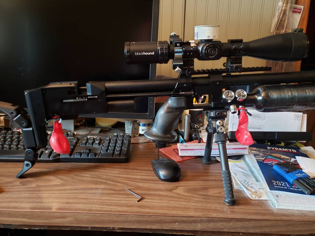

Tuning RTI Prophet Performance has a leak ( somewhere )
Not a fast one. Say I fill it to 250 bar and shoot it down to 200 ... it'll drop to 150 after about 4 or 5 days. So its not a show stopper of a leak but ... it is leaking ( wasting ) air. As you can see i have it looking kind of like a clown now with a couple of ballons i just attached to both fill ports. I just attached them ... I'll check on it on a day or two to see if either one has started to inflate ....
If not ... ideas / suggestions as to where else I might look / try to figure out where it's leaking?

Winner! Winner chicken dinner!! Those who said guages - ding! ding! ding! 😆
Reg guage was *very* slowly seeping air - soapy water helped me find it (finally). I gave both if them a slight turn of about an 1/8" of a turn to snug them up. I've been shooting it ... need to fill it to 200 or so bar and just let it sit for a few days but I'm hopeful that I've (we've collectively) identified it.
