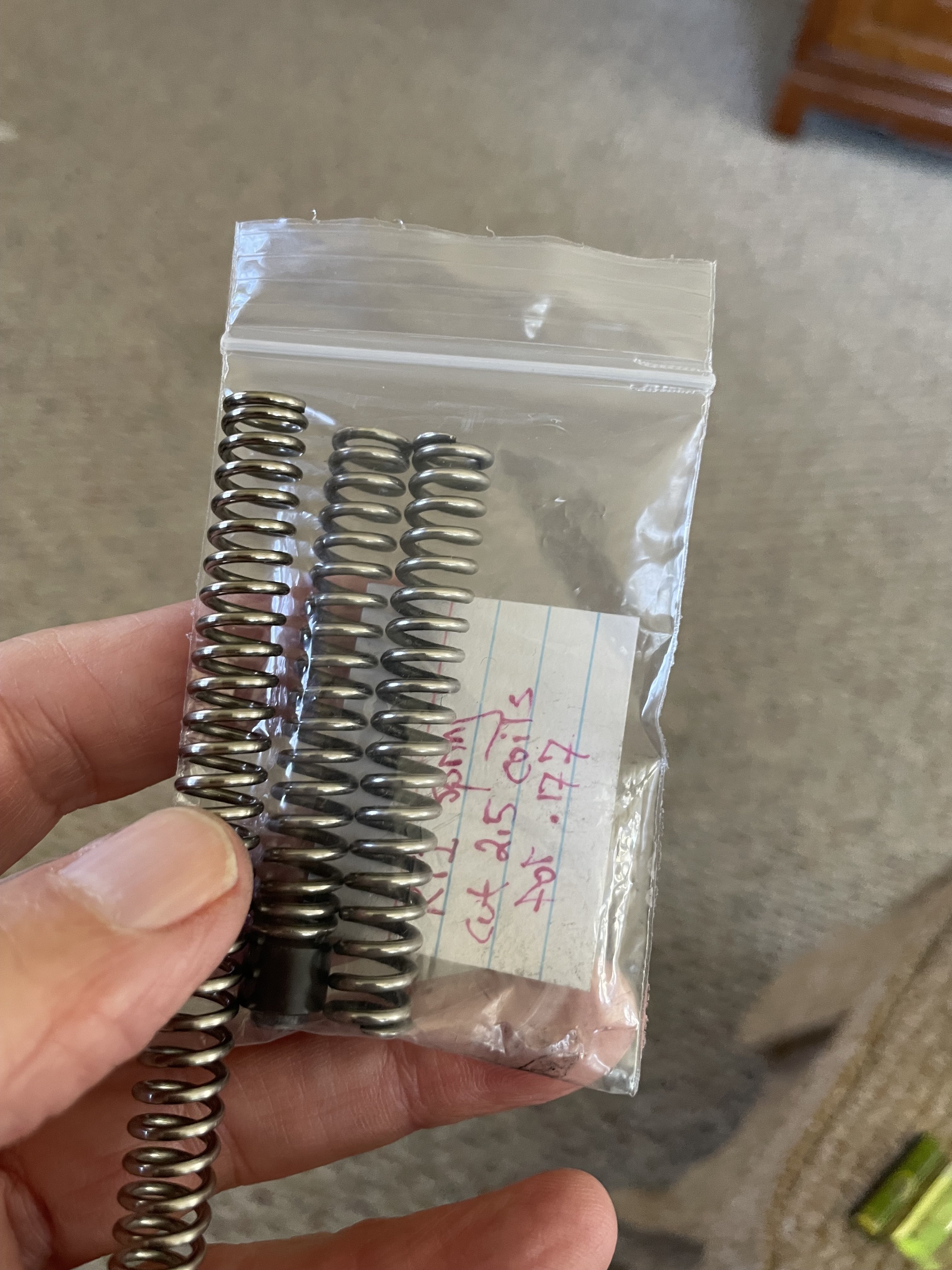

My photo shows in the bag a stock RTI Prophet spring, a shortened stock RTI Prophet spring and the delrin spacer/spring guide. The long replacement spring is outside the bag. It has the correct 10mm outer diameter and has a 1.5mm coil thickness.
Its softer than the stock spring, so gives a much smoother cocking experience. It won’t provide the power of the stock RTI Prophet V1 hammer spring, but I’m target shooting, so I don’t need massive power. It has plenty of omph to get to 850-920 fps “optimal accuracy” velocities. When I do want massive power, its two minutes to swap the stiffer stock spring back in.

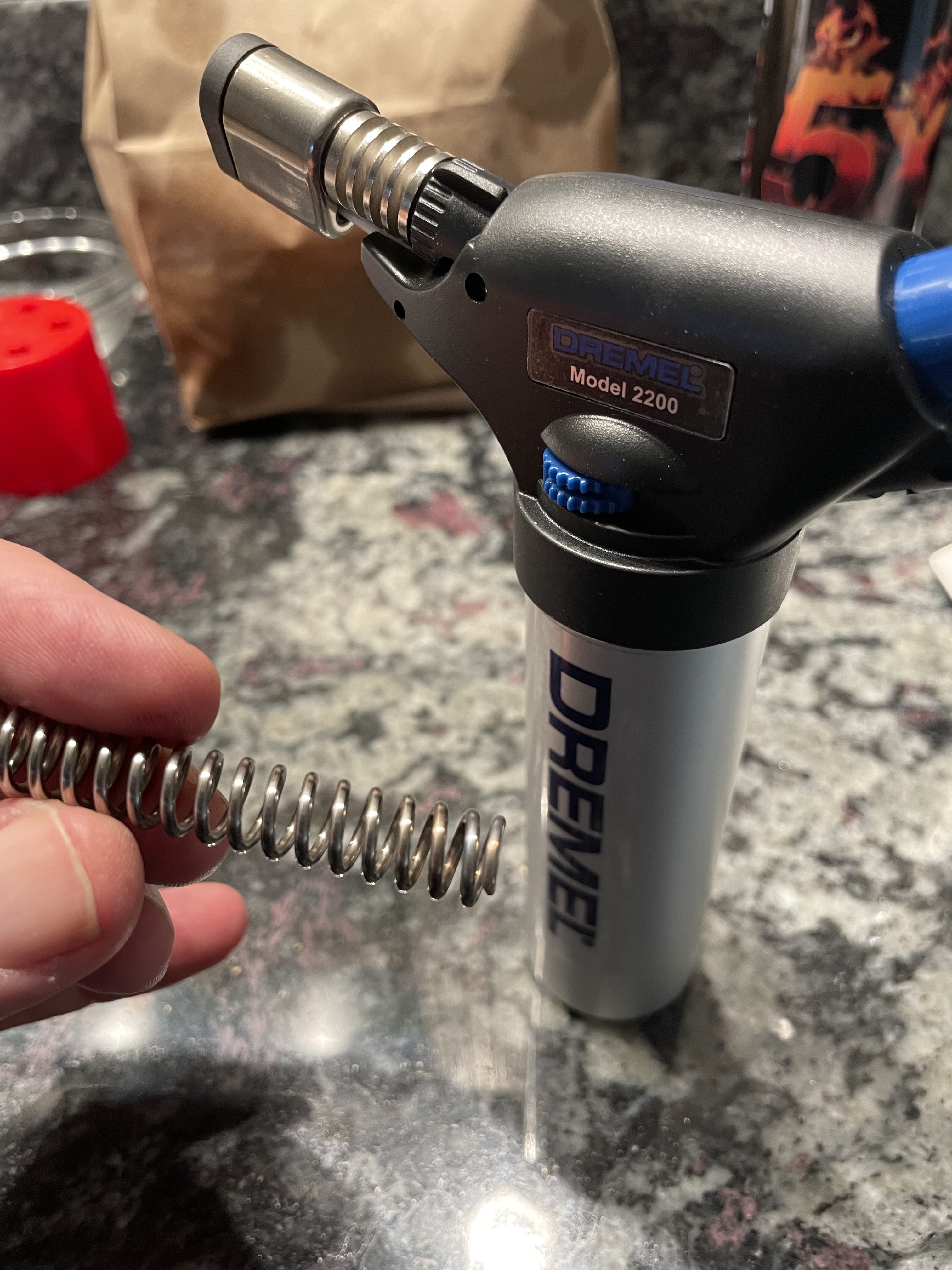

What did you use to cut the spring? Would a Dremel cut-off wheel work..or maybe something else?
Yep, I used a Dremmel cutoff wheel.

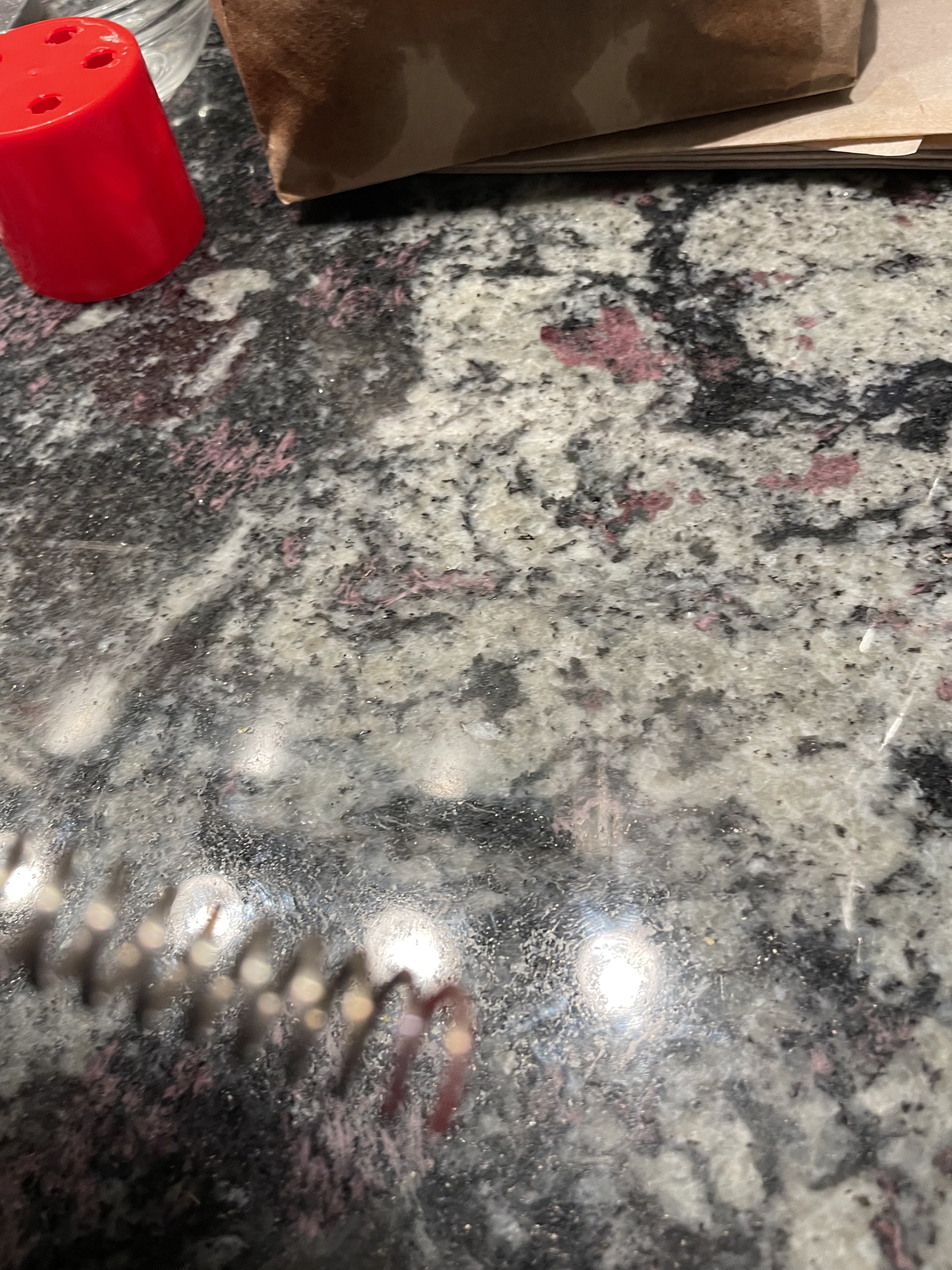

Also, use a little butane torch … heat the last 1/2 coil of cut end until red, then push end down on flat glass stove top or granite countertop to flatten the end, giving a more “professional“ finish to your spring.
Added pictures to show Dremmel butane torch I used… so Dremmel rotary tool with cutter to cut spring and then Dremmel butane torch to heat the end coil and flatten it.
