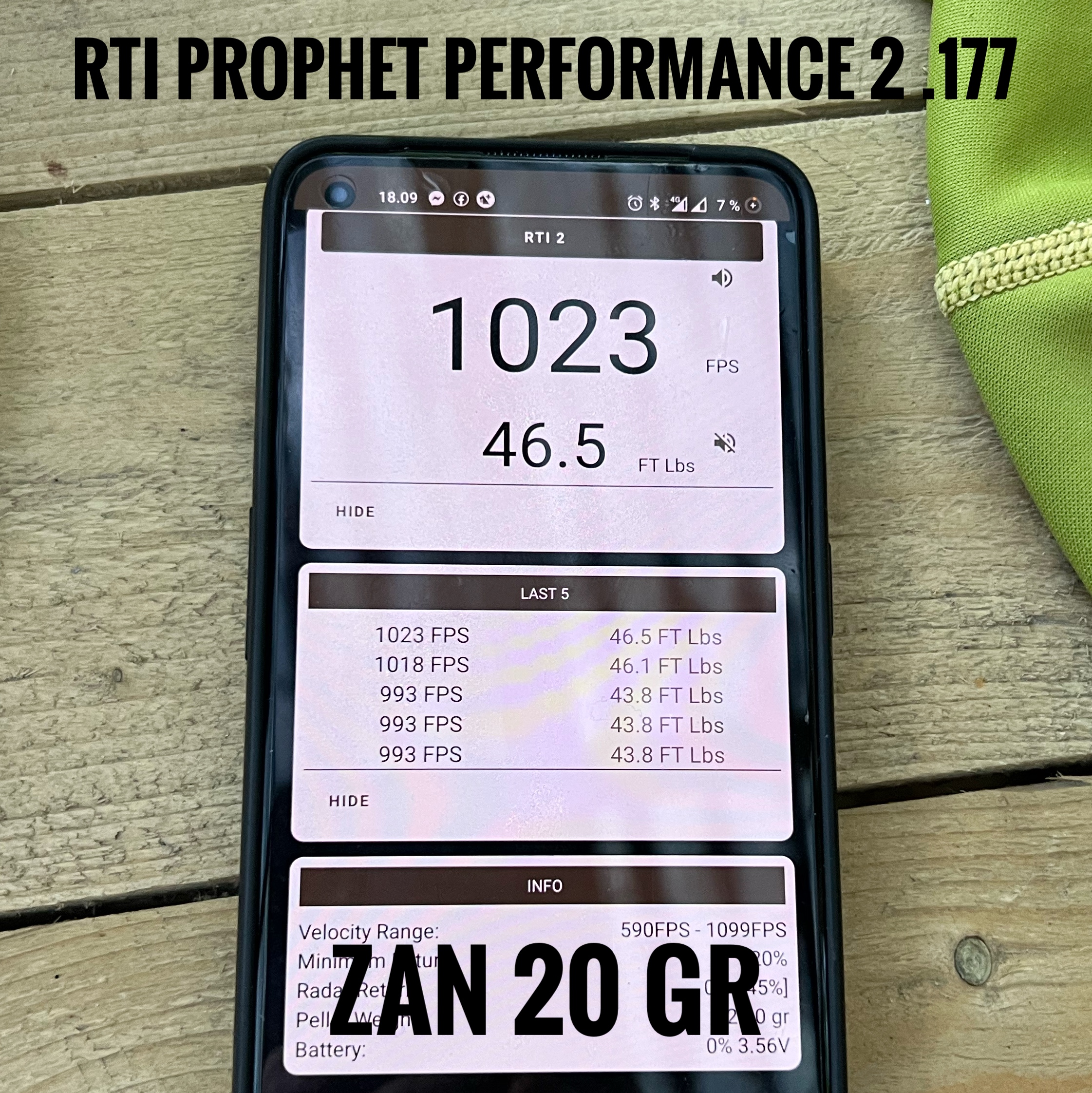

At my range yesterday shooting with a couple of friends and one of them brought his new RTI Prophet 2 Performance Compact 👍 At the end of the day, we decided to test the max power output of this new edition with the new valve - He was shooting 13 gr slugs at the same velocity as we did with the RTI Prophet 1, but he was only at 115 bar and we were at 145 bar ! 🙂
Well, he cranked up the regulator to the max of 180 bar and loaded the ZAN 20 gr slugs 🙂 The specs at RTI says 30-50 Joules or 22-37 FPE 👍
63.05 Joules and 46.5 FPE !
Huge numbers for a .177 for sure ! 🙂 Amazing ! 💪
I need to gather some slugs and test. 15 gr NSA are doing well but only tested 20-45 m.... just. I'll be shooting more soon and trying ZAN 's as soon as I know which ones work in my barrel and order some.
Considering faster twist barrel if needed to shoot 20gr accurate @1000 ish fps. Remeber!! lube your slugs properly , clean the barrel - slugs foul and ZAN are even softer lead I hear...

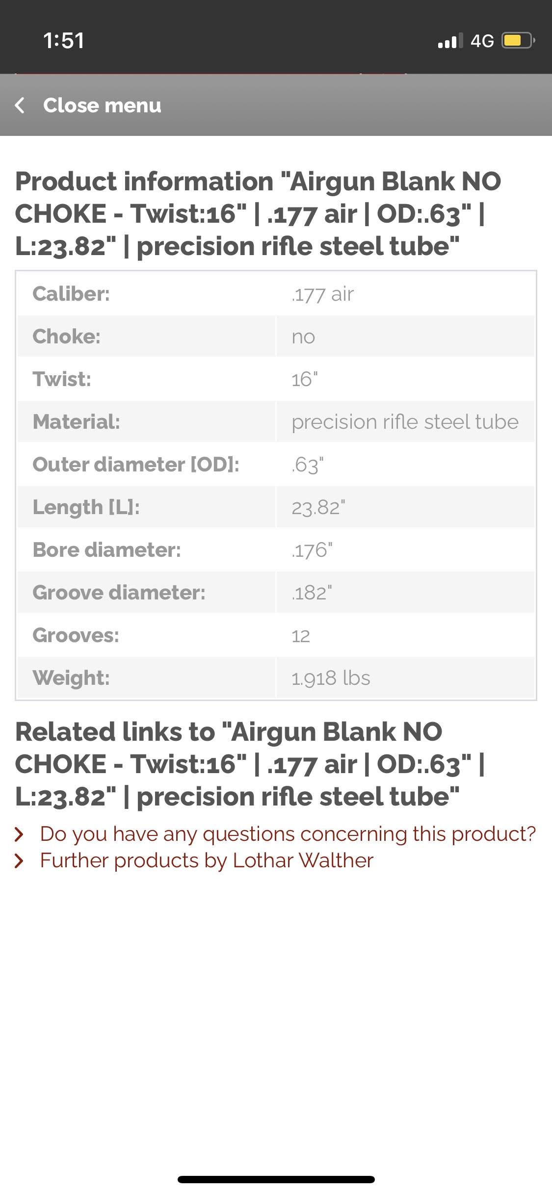

I have the power but lacking dedicated 1/16 or 1/15 slugbarrel ... here's a Lothar Barrel I'm considering having machined:
I wrote here ealier to RTI in regards to a 60cm(23") barrel for their .177cal. They replied if I wanted 60cm barrel I should take a look at their .22 & 25cals.....Oh well.

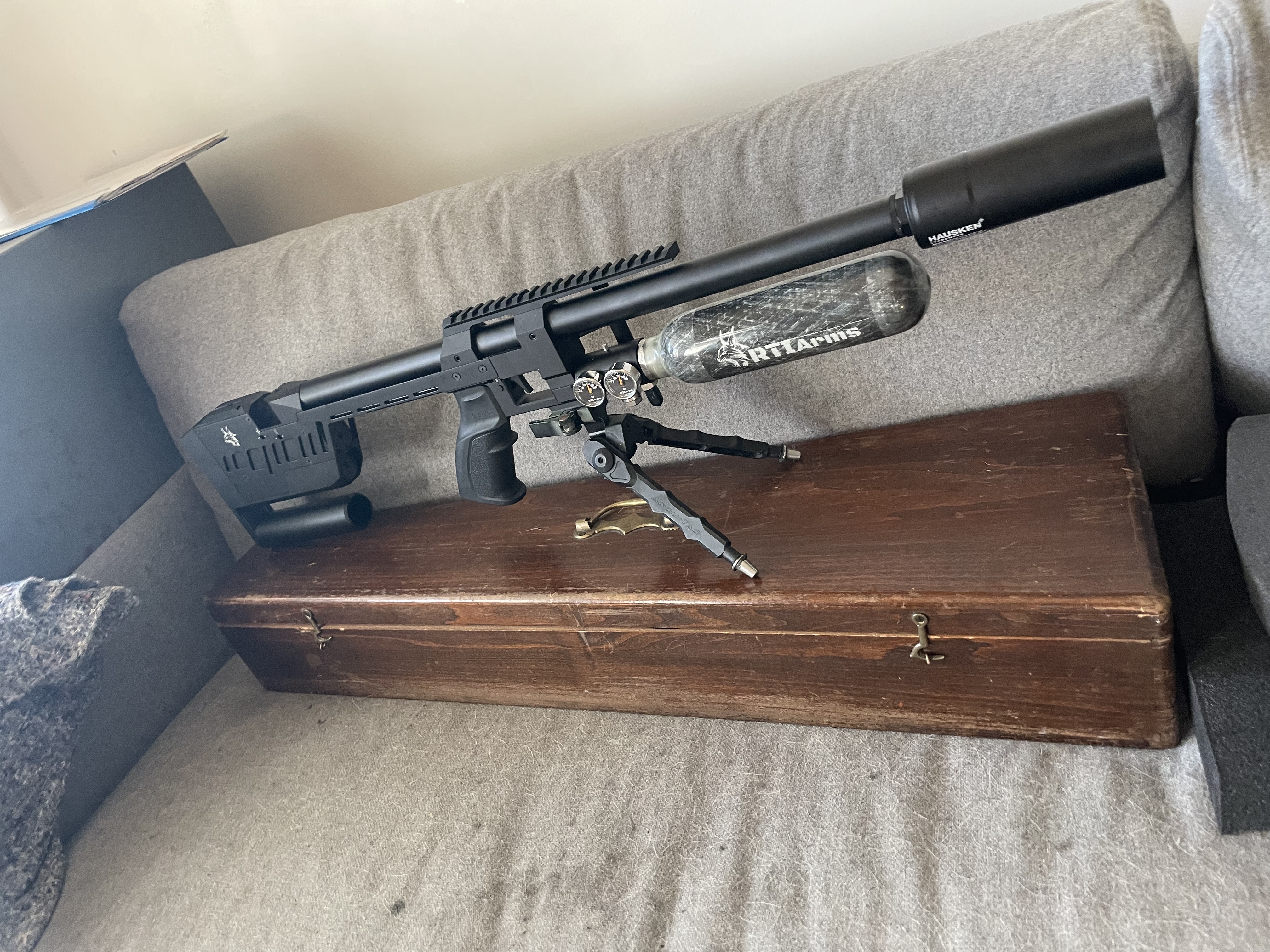

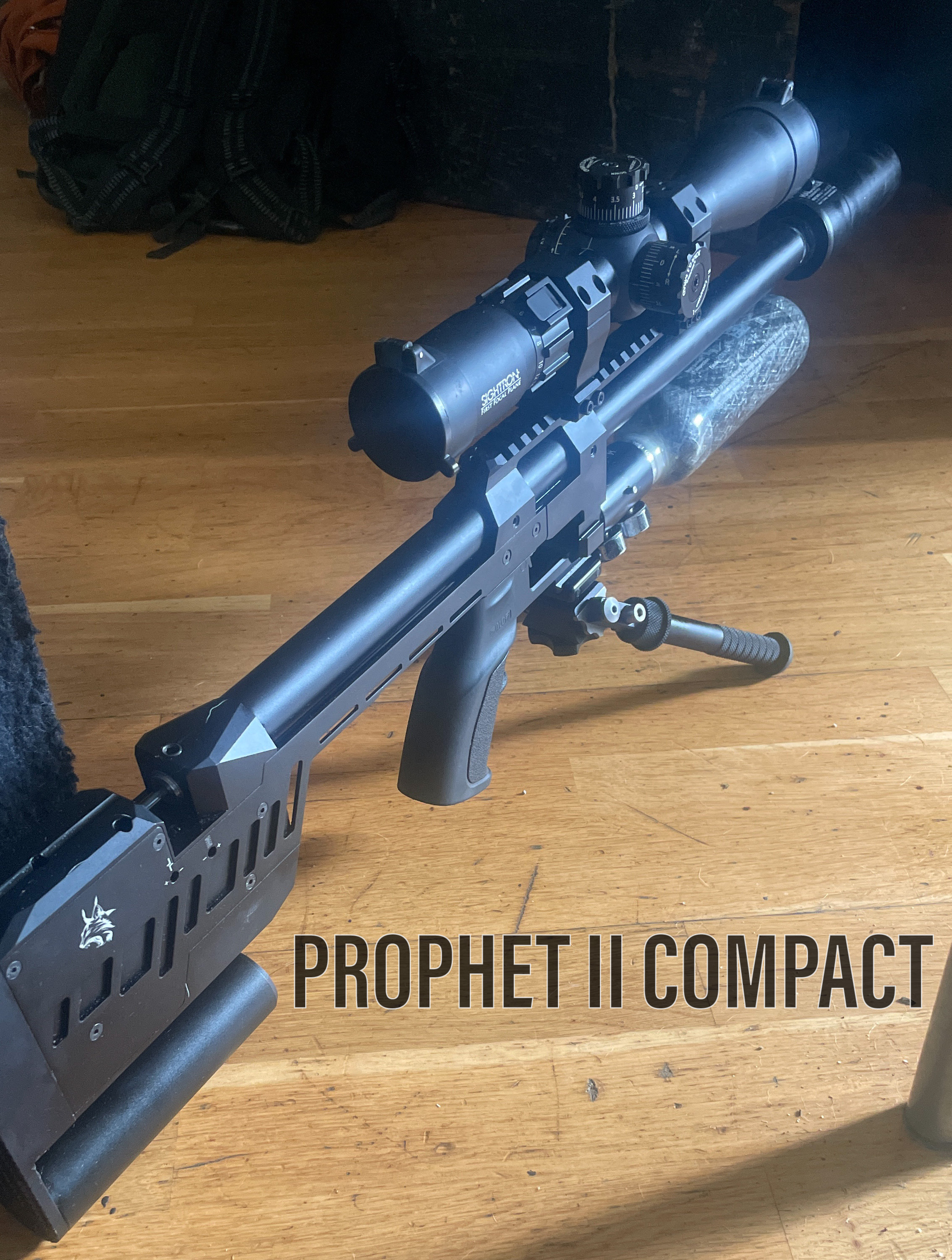

Hi Soren, did the prophet 2 have any port restrictor fitted?
Purchased a .177 kit for my prophet 2, if needed I can use the port restrictor from my prophet one.
Thanks, 👍
I have no idea ! :) Usually the .177 is restricted to 2.6 mm (I opened mine up to 3 mm) (y)
Thanks 👍.
I'll change the barrels tomorrow and take a look at the TP. If it's threaded I will stick a 3mm restrictor in.
Like you, the 3mm TP hole works for the calibre and power.
This P2 is a totally different beast.😉🙂
