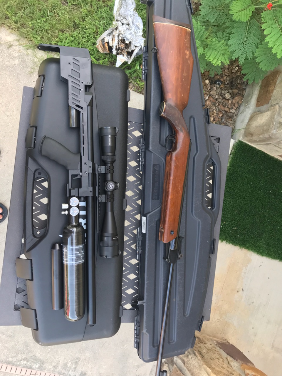

I picked mine up Friday from Alamo Airguns in .22 with the reg set at 125bar. Spent yesterday afternoon shooting the Propeht and my FWB 124 between grilling and working in the yard. I put about 100 rds thru the Prophet and so far I am happy with it. Only shot jsb 18g and Fx slugs. At 50 yrds I was getting tight groups the JSBs and I was with my cycling the action pretty fast at times. The FX slugs (.217) were a bit more difficult to load and were about half an inch at 50. It's a little loud in stock form so I added a spare LDC and it dropped the noise a lot. Seems like a simple platform to work on should there be any issued and easy to adjust. Ergonomics are very good for me but the buttpad slips a bit on the shoulder. The side lever is nice but not as refined as my Wildcat was.

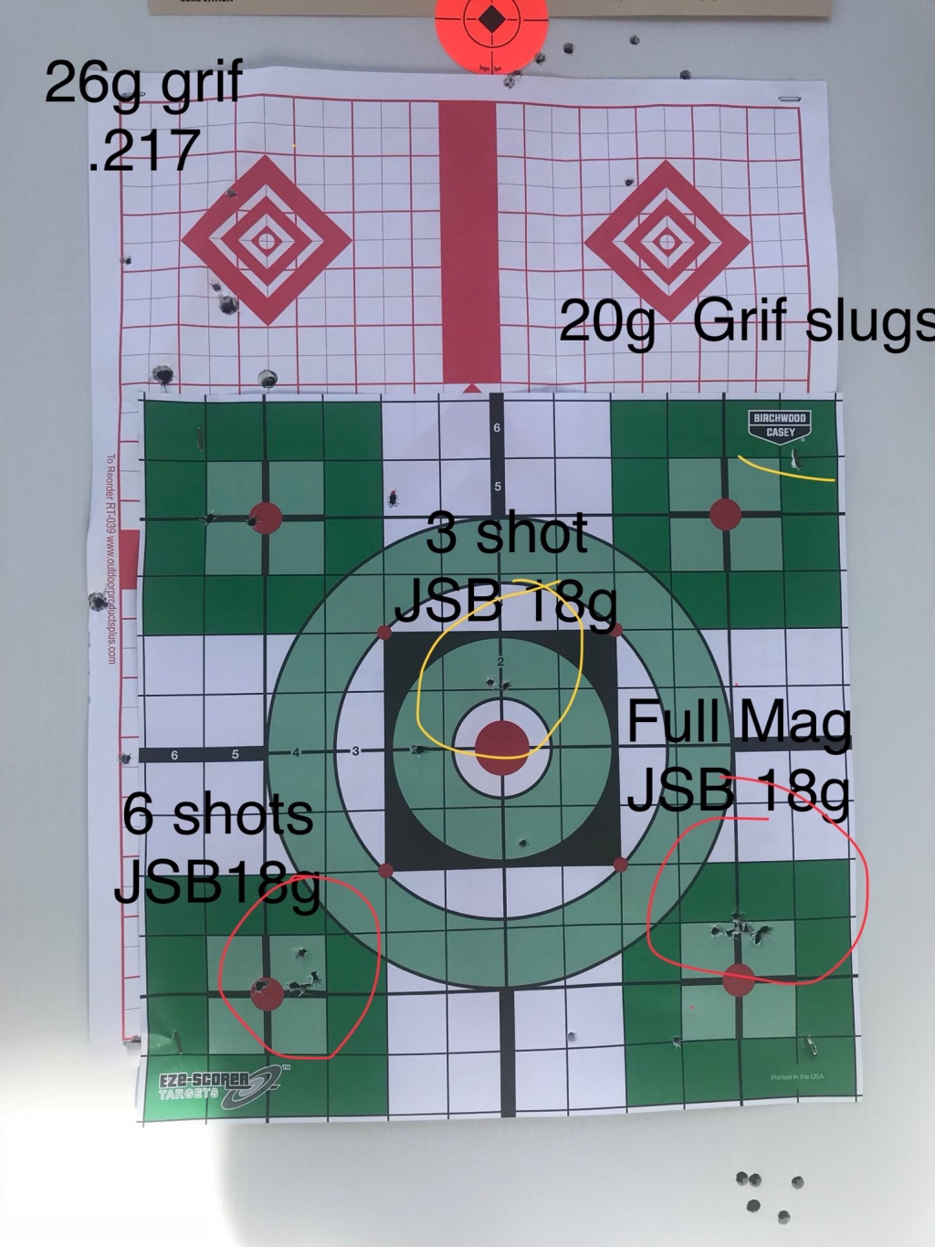

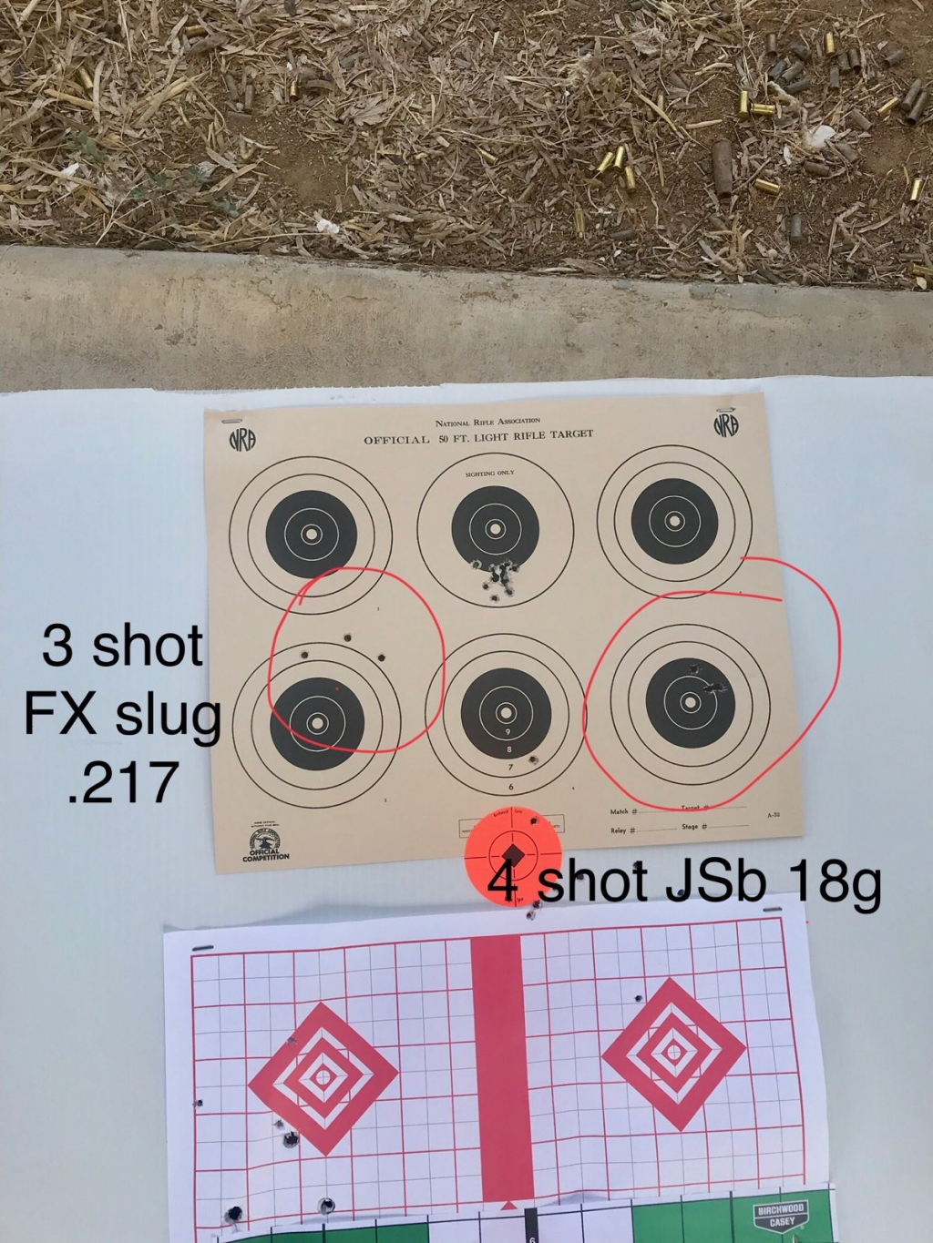

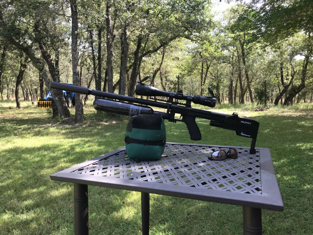

Went shooting this morning. Was already 85 at 9:00Am here in SA. Shot the Prophet at 75m and still havent adjusted anything but only really liked the JSB 18gs of the pellets I tried.
Shooting a bullpup from the bag is still weird and I should get an adjustable front rest and a bag rider. When I shot my R-10 after the Prophet the R-10 feels much more natural and easy to hold on target. I used my Vortex 4-12 Crossfire SFP that I had on my PBBA .401.bc it was the only picatiny mounts I had. So not the best target scope. Had stopped by Academy but they were sold out of mounts. Next week I'll get a better scope mounted for bench shooting. Was shooting to the west and had a slight crosswind from the S wind.
Tried a couple .22 217 Griffin slugs and it scattered them all over. You can see some of the flyers in the pics. They werent even within 4" of the aim point at times. The FX slugs opened up a bit but still grouped. Tried the JSB .25g redesigns but it didnt like them at 125bar reg setting. Very happy with the gun so far though.
