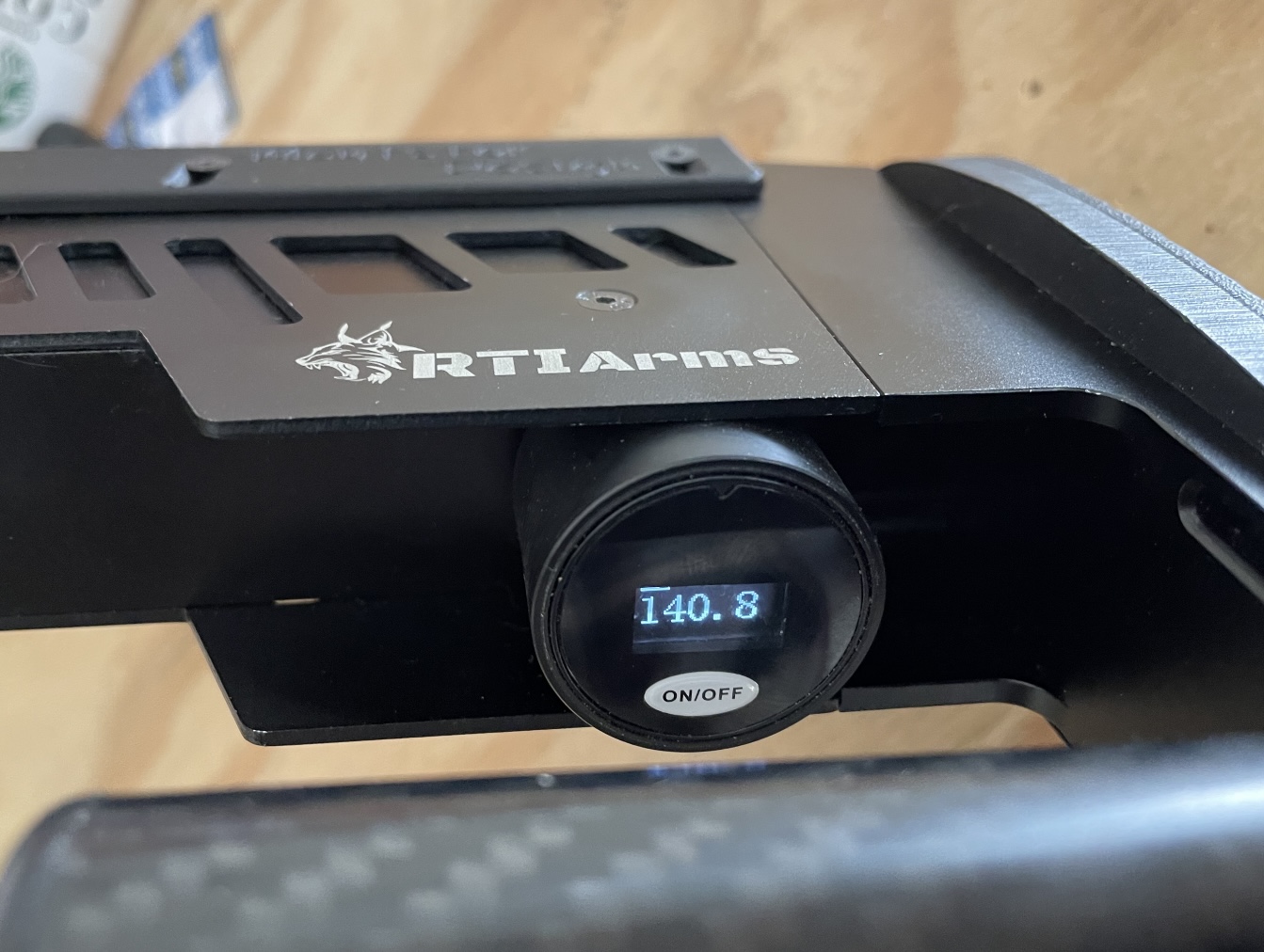

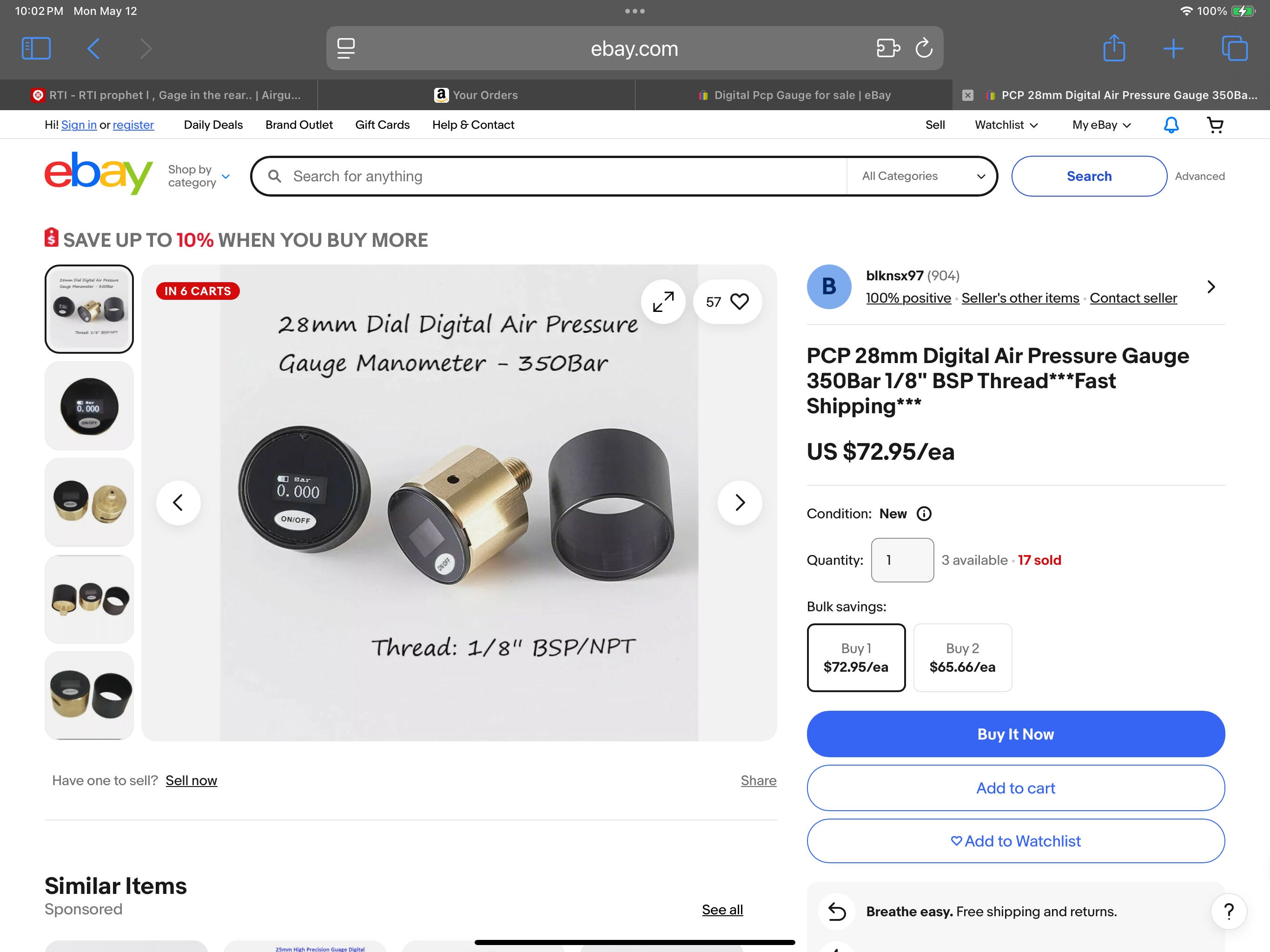

I have a prophet l set up in 177,22, 25, and 30 caliber , Kinda of a closet gun, But I would like to put a digital gauge in the rear of the gun,, It seem all the digital gages are to big.
and body done this and kept the part numbers ,,, I think RTI made the port to install a back pack bottle or something ,,,,

And be careful taking out that foster fitting. Use the right size socket and if it fights you at all, put heat to it. A couple years ago a guy made a mess of his gun getting it out. Mine came out of my Priest fairly easy but I hit it with some heat first.
I was fortunate with this one, the rear foster was sealed with a dowty seal. Some of the earlier versions were loc-tighted on and were a bear to get off.
