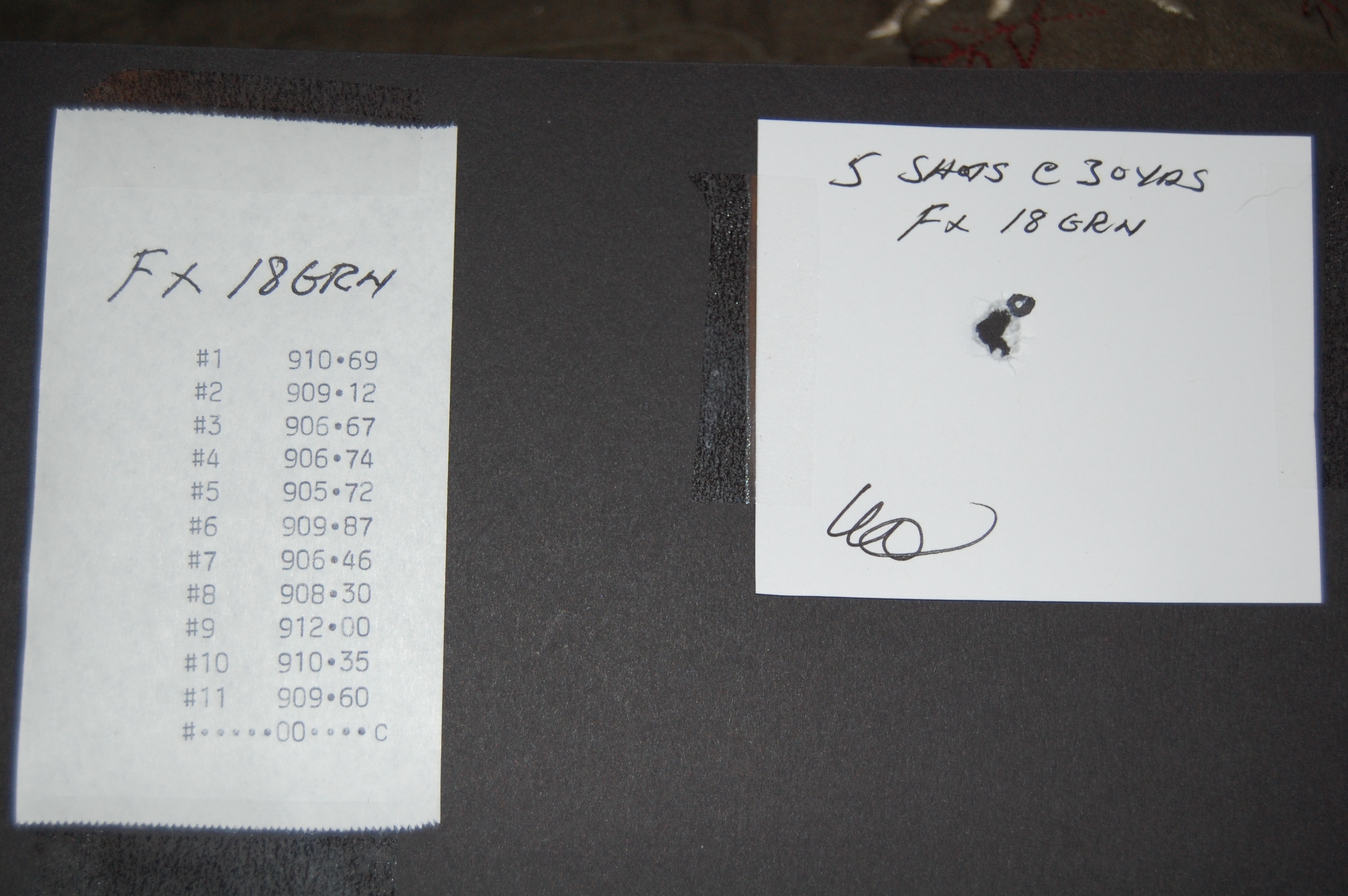

.22 ... here is TT results:
At those settings and if you’re going to be shooting 18.1’s, you’re going to have a lovely shooting gun. Shouldn’t take a dirtbike muffler to keep it nice and quiet. Get some pellets through it so everything can start to get settled in. Like others have said, the pop during filling should only be a concern when you don’t get it because you might have a leak when you disconnect.

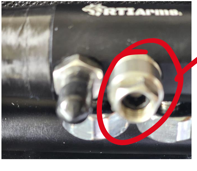

Hi guys,
My reg leaked from the 'nipple'.
I changed the o-rings on the reg, and it leaked from the reg screw adjustment.
I tightened the screw all the way in and the leak stopped. I filled the air up to 100 bar (my scuba tank had only about 100 left), and lossened the reg adjustment screw slowly. Suddenly it leaked from the barrel.
I changed all the o-rings on the valve components. And it still leaks. The leak from the reg adjustment screw is also a mistery. Initally, the reg was set at about 160 bar plus before the reg leak, and it was doing fine. I can't remember how much reg screw adjustment it took to set the reg to 160 bar. But I'm concerned that it was the first time I had a leak from the reg adjustment screw because I will set it at about 160 -170 bar again.
Any ideas are appreciated.
Thank you.
Reactions: JungleShooter
That pic makes it look like the reg pressure is set below the minimum working pressures of the regulator. Might start there if that's the case. Also another thread complaining about this rifle and you don't even have a scope mounted yet. Yeesh...

I also had a valve fail on my P2. The symptoms were similar to yours. Rok sent me a new one, I replaced it following Gregor K's video on Prophet 2 disassembly/reassembly:
and am in the process of tuning the hammer spring/regulator pressure balance to attain a particular velocity.
I also had the regulator leak around the protruding pin. I rebuilt it following this video:
The gun shoots well and holds air. Probably my favorite PCP.
