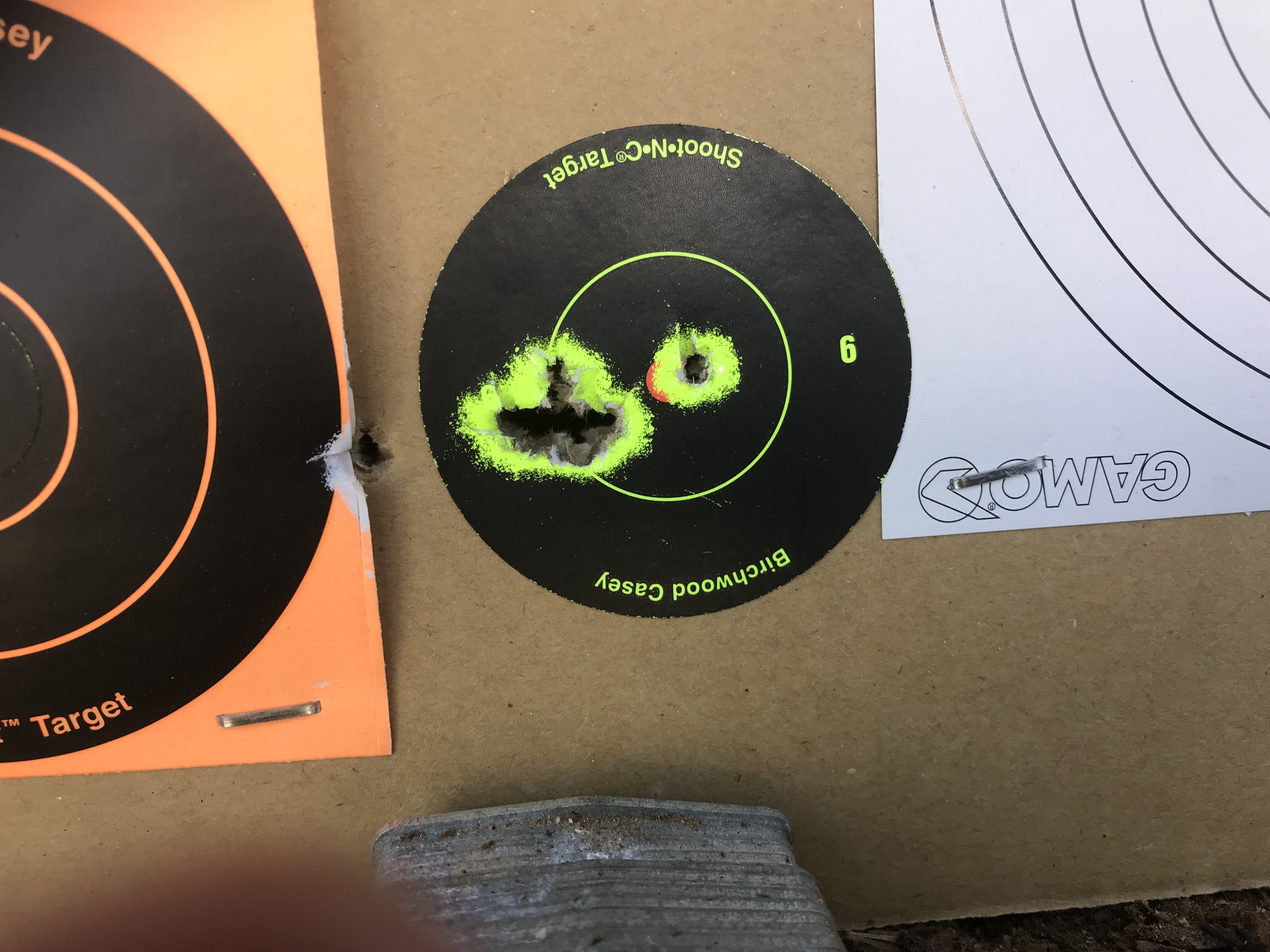

I shot barrel #2 at 48 yards some wind , ten shots cover by a dime and I was not trying real hard, after about an hour working on truck came back and shot 11th shot dead center but out of the dime group, DAM, I will see if I can get a picture up.
Mike

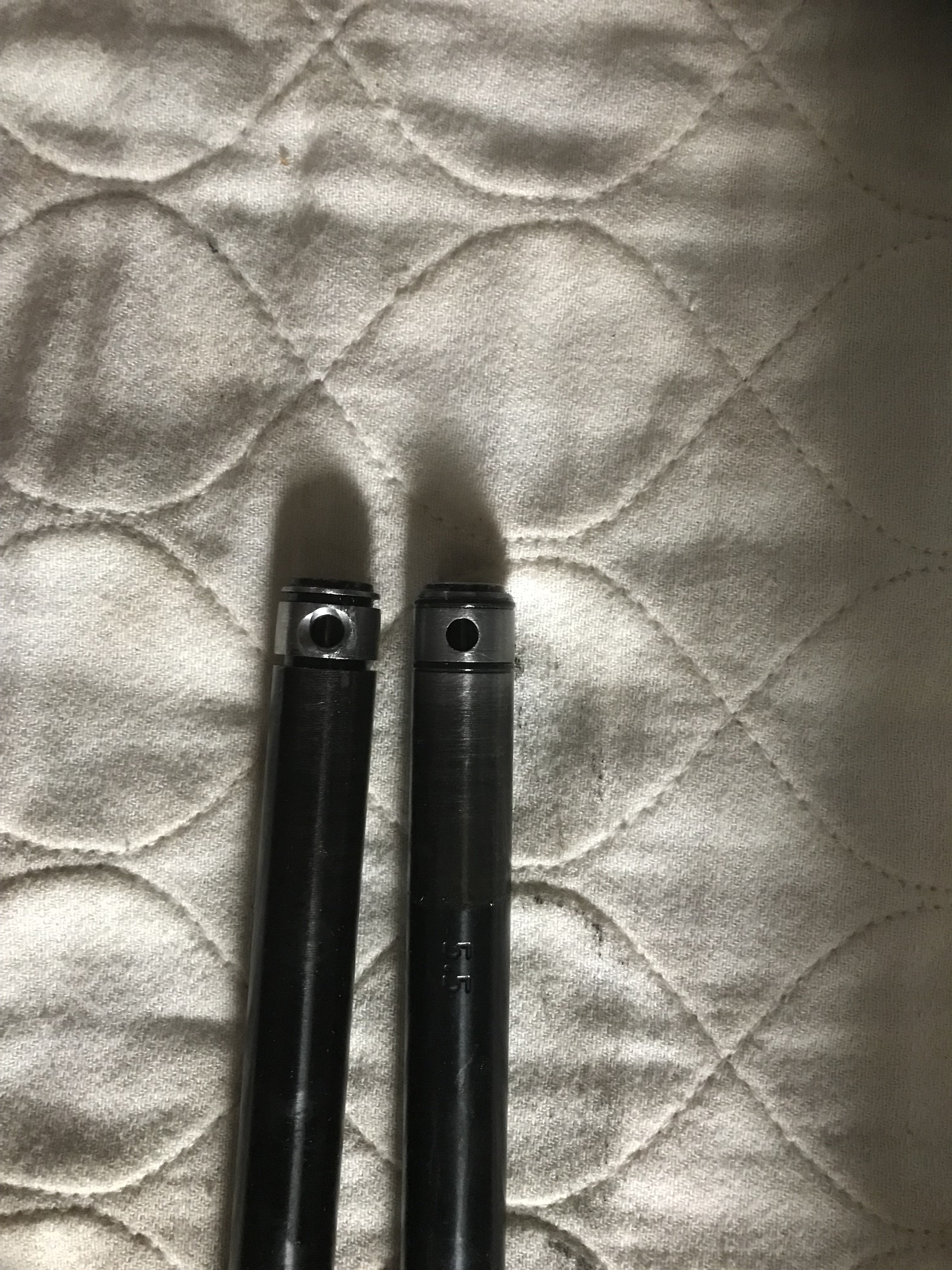

50 to 60 MPH winds , No shooting today West Texas, But i did take some barrel pictures, The barrel on the left came with the Prophet 22 PP II I could not get the sharp edge off the port, I was hand sanding , I thought hell smallest port I have seen on a 22 caliber I got two barrels so I opened it up a little, The one on the right is the one I was sent for warranty As I said in the other post I have test fired the one on the right , I stacked 10 pellets in a dime size hole with out a whole lot of effort, ( IMPRESET) I got about four hours sanding on both barrels and some very sore fingers, I got the barrel on the left port a lot cleaner than picture shows,OOPS.
