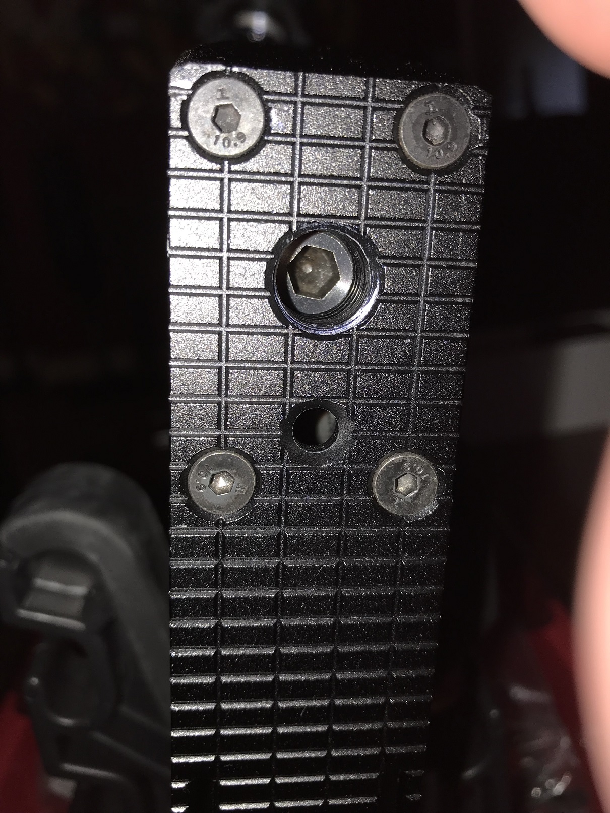

I have an RTI Prophet that was converted into a Performance model. The rifle came stock as a .30 caliber performance. The gentleman that I bought the gun from did the conversion (a great job) and sent it to me along with a .22 barrel installed and the .30 barrel. He put the spring in that came with the performance upgrade kit (gotten from rtiarms.shop site). The gun shot great and I tinkered around with it and then changed out the barrel to .30. With the spring in it, it would barely shoot at all and I cranked it down to almost the end to get any shots at all. So I changed out the spring with the one that came with the stock Prophet and I could barely get the screw in as it was so tight. Now just the opposite occurred: The hammer spring screw extended more than 3/16ths out from the butt plate! And it was hard as hell to cock. I then got the .22 lr barrel and put it in along with the original screw and it is back to working great except for the fact that the hammer spring screen is really cranked down. I have included a picture of where I have it to push JSB redesigneds at 970 fps.

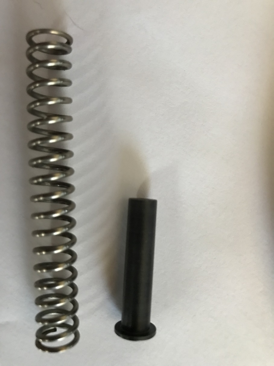

I have also included a picture of the 2 springs and you can see the length and and spring size difference. What I wanted to do was to cut down the heavier spring sot that I could use it for both the .30 caliber barrel as well as the .22 barrels and just make adjustments to get the speed/fpe that I want. Has anyone else done or had to do this before? Is there a better solution than cutting the larger spring down and grinding it flat to match the way the springs are now? Unfortunately, I also get a lot of air noise in my right ear on every shot. Thanks.
If I’m understanding you right, it sounds normal. The Prophet 2 doesn’t have a heavy hammer. It extremely lightweight , it uses speed from the spring to open the valve. Completely normal to have the adjuster in 1/2 to 3/4 of an inch. You may need to raise your regulator pressure for the .30 to get the speeds you desire.

@Scotty1, here's what was in the back of the hammer spring. It doesn't seem to have enough width at the bottom to really make a lot of difference if I leave it out. Since I have 2 of the new, heavier springs, I thought t wouldn't hurt to cut and grind one down to see if I could find a happy medium. On the o-rings I was thinking the same thing as you have already done! Do you know the size and I will order a few (I think 100 minimum for a couple bucks) and give it a try and report back? Sorry I did find out the o-ring: 1.5mm x 12 Buna-N 90

I do have the end piece (part 60 in the blow up) that came with the original .30 caliber barrel, but when I changed to the heavier spring, I put the longer one back in thinking that it was required for the performance versus the smaller one. Don't know it that's part of the problem. I haven't tried it with that short end yet either. Maybe try it without the long spacer and see the results? Thoughts?

As a follow up to the thread, I finally go t to go out again today after a 2nd full hip replacement ( 3 weeks and walking again!). I took the longer, heavier spring and cut off the extra length to make it the same length as the lighter spring that I was shooting before. That seemed to do the trick. I do not have the hammer flush - maybe a turn out and I am at 970 fps with the Jumbo Redesign 25.39 grain pellets ( I have the LW LR 24" barrel in). I am pleased with the results. I will put the .30 caliber LW barrel in tonight and take it out tomorrow and tune it up, but so far I can't be much happier. Thanks everyone for the help and advice.
