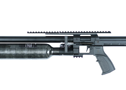

I took a closer look at mine today. It seems to me that you could have the stock rail milled down the slots to a flat surface and then just drill and tap it to bolt a long rail in whatever position you like.
Doing this you would have a slightly taller rail, but not by much.

if you milled the OEM rail flat and drilled multiple mounting holes, what would stop you from mounting two rails end to end? That would give more than enough rail to mount lots of stuff.

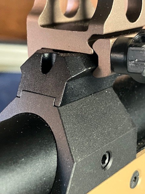

Yes, I suppose you could do that, but the rail that comes on the gun s not flat on the bottom. It is sort of a tounge and groove fit, that has the advantage of never drifting out of alignment.
You would also loose your 20 MOA unless you found a rail that also has that.
If I were doing this, I would order a spare rail from RTI and take it to a local machine shop to have it milled flat.It would be a pretty simple job.
O yeah, I see the tongue and groove... — good observation. 👍🏼

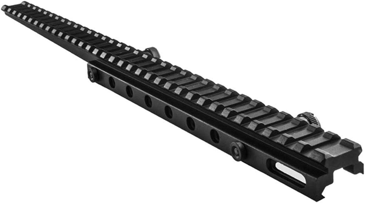

I found a rail that I could use without any machining.
Rail. 13.8'' (35cm) long. 0.5'' (13mm) height added. $35
And if I cut off the bottom part and drill holes I could use it as a replacement for the OEM rail — and thus gain another half inch to lower my scope....

Thanks for the info, and the effort to design something like that. 👍🏼
I'm not quite sure from the photo or the description if this is limited to Prophet II.... — or all of RTI's guns (Priest, Prophet I + II).
At least as far as I can tell the Prophet I does not have a dovetail, and I don't see how to mount this part on the two "rail pillars" of the Prophet I. Maybe a photo of just the part would be helpful, and a description how much higher my scope will mount as compared to the OEM rail.👍🏼😊
Matthias
Looks like the picatinny railed portion comes off and you mount the base to the two original rail locations on top of the pillars, then slide the picatinny portion on and run the two cross bolts through. Little steep for my tastes. If people would quit adding thicker butt pad options for the Prophet the original rail works well enough.
Looks like they made a dovetail on top of the lower base so you can pull off the picatinny portion and just use the bottom with dovetail mounts.
Reactions: KrafordAndLypt
The rail can be adjusted from 0 to 120moa and everywhere in-between. It operates much like no limit rings, but lets you keep the scope lower than using those rings. There is the added benefit of the wedge to set to some defined moa levels.
Thicker pads unfortunately are the only way around their hammer spring adjustment. There might be a way around that by putting a stiffer shorter spring, then you would have to thread the rear block. Not a simple mod...
And yes, you can use it as a dovetail rail or picatinny.
Matthias
If the Priest, Prophet I + II all have the same rail attachment then they will work. We don't have all of them in house, so it's only tested on the II.
The rail is higher, but giving a measurement won't really mean anything with how it is to be used.
If you want to build in more moa you have to use high profile scope rings like a one piece or no limits. This rail allows you to build moa into the rail and use LOW profile rings so you get the angle you want as low as possible.
So it's not exactly an apples to apples comparison to the OEM height.
