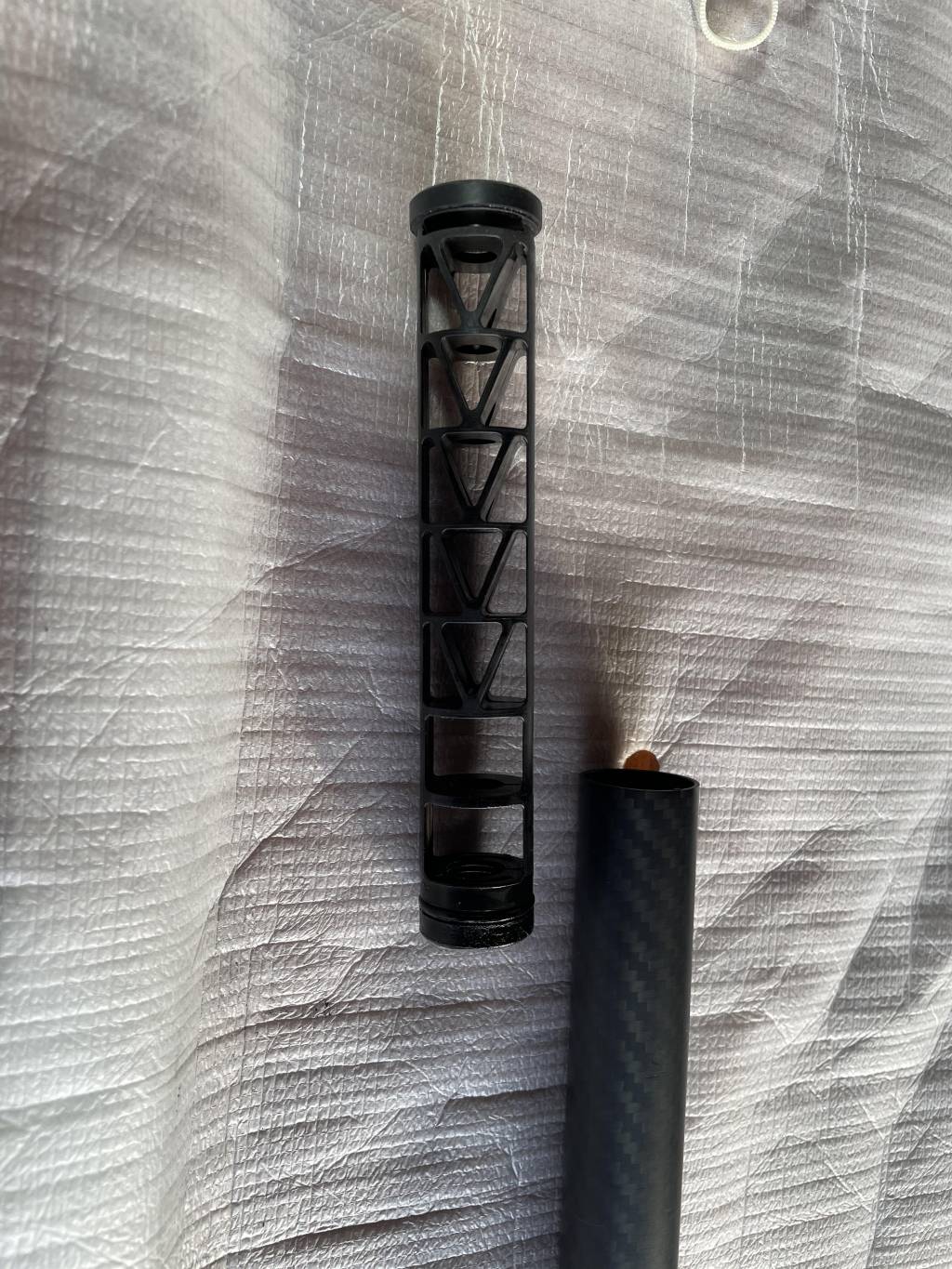

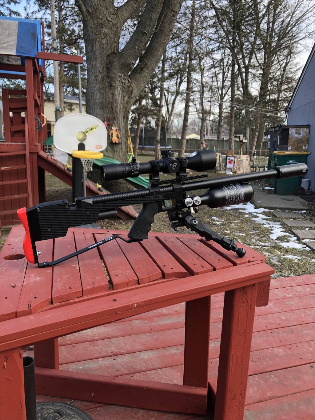

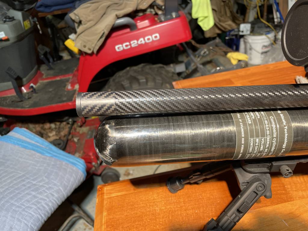

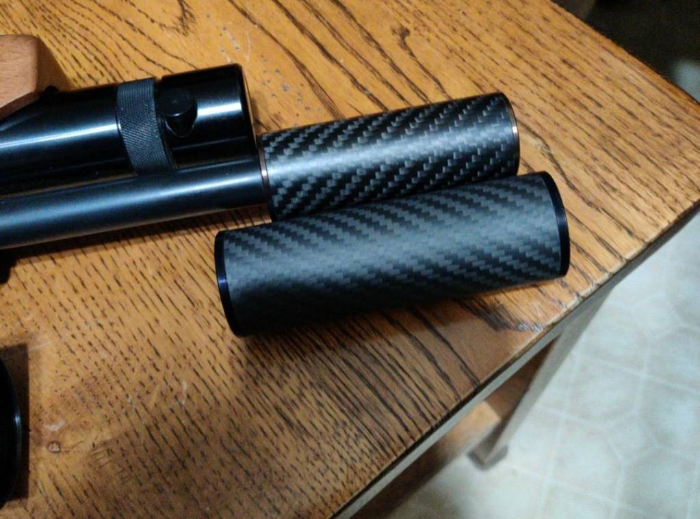

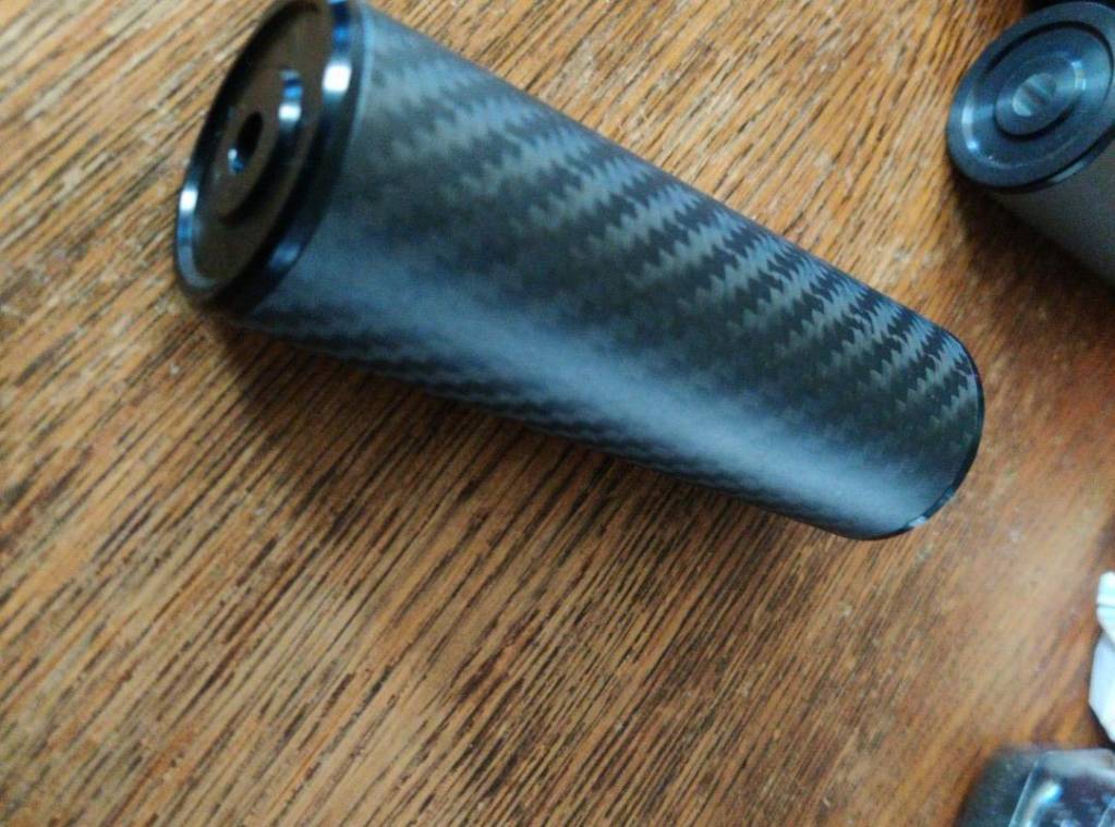

I added a baffle to my Priest 2, which has the original shorter shroud. I made up the difference with a short piece of tubing. I’m still testing, but so far, so good. I sent some 20.2 nsa slugs through it yesterday at around 900fps and it’s working well…so far.
Joedirt,

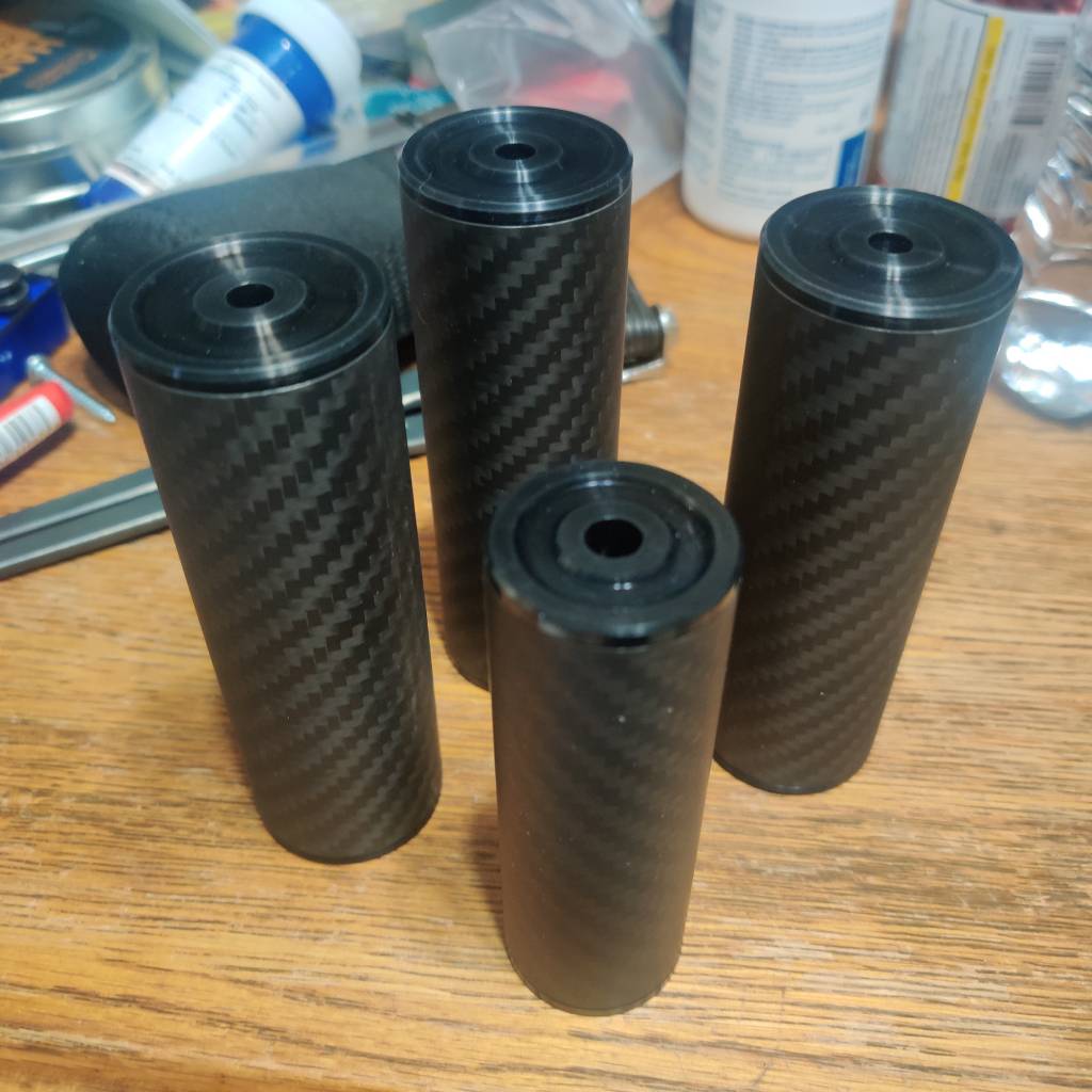

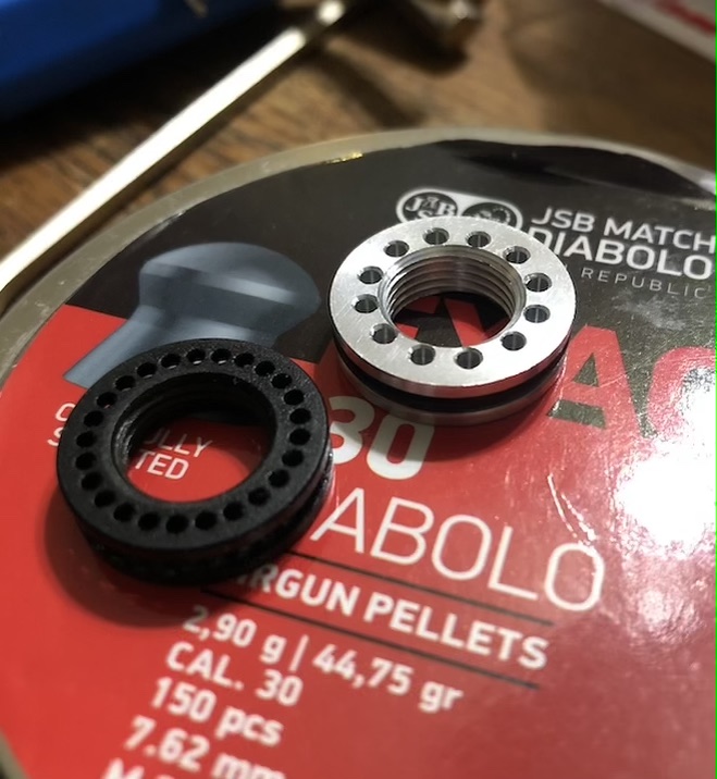

Bully's barrel spacer is more effective. One of the reasons is because the OD of the spacer is tighter to the ID of the CF shroud and the o-ring does not partially block the holes like the factory setup. The factory spacer and aluminum shroud had some play that allowed the barrel to be off-center to the shroud end-cap. This resulted in some people have clipping with a moderator. Bully's spacer will be going thru another change to quiet the airgun a bit more.
