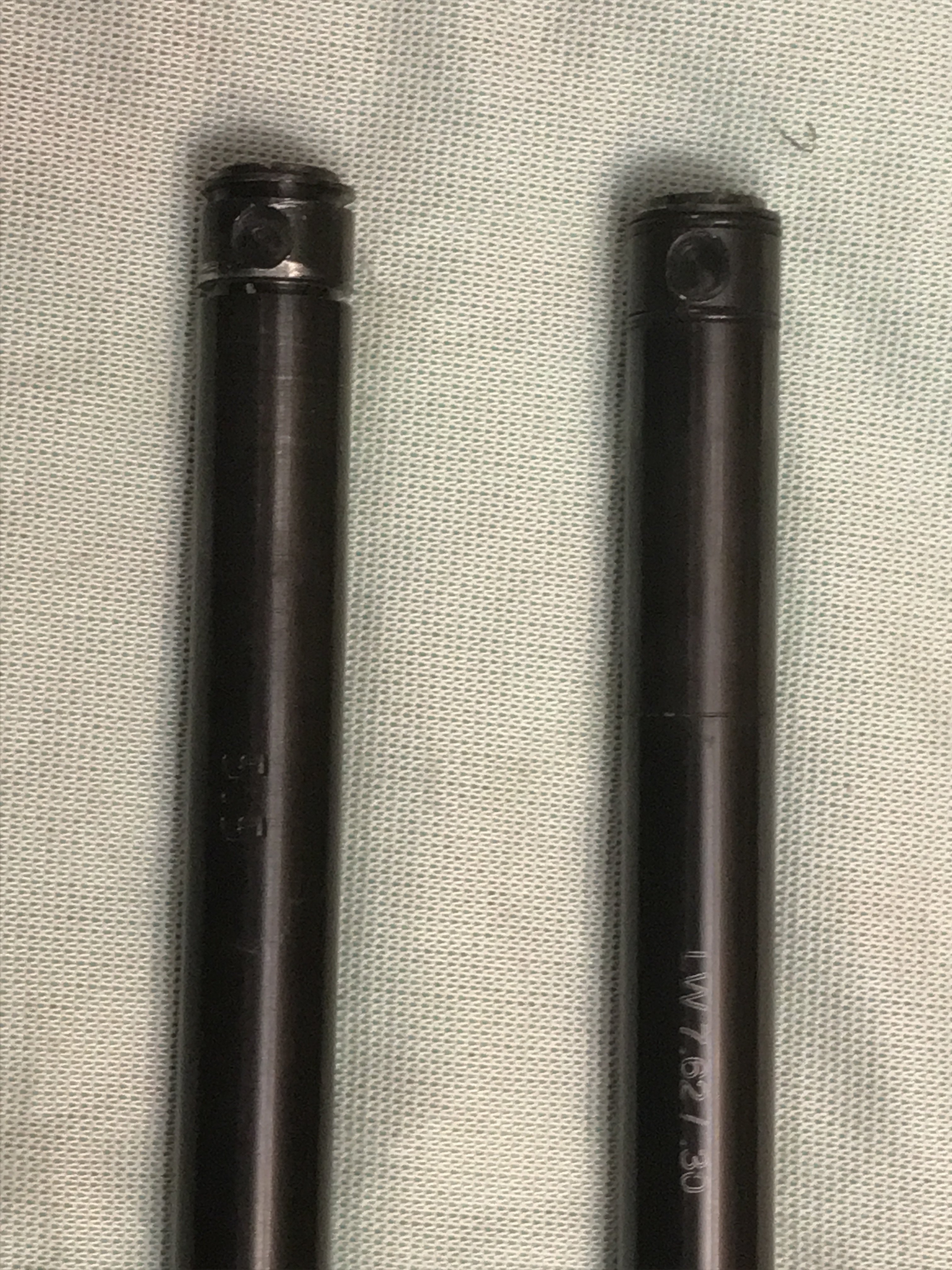

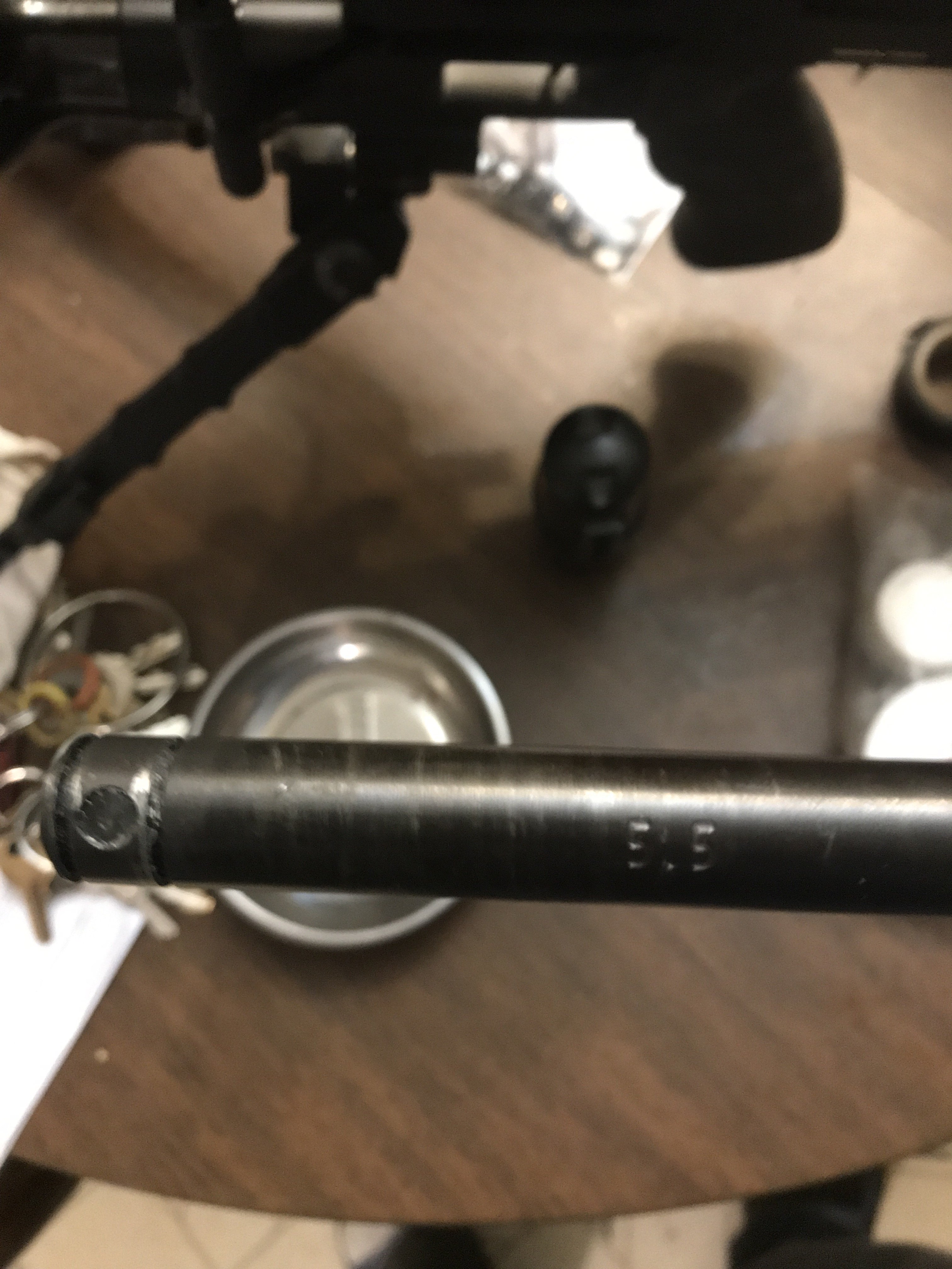

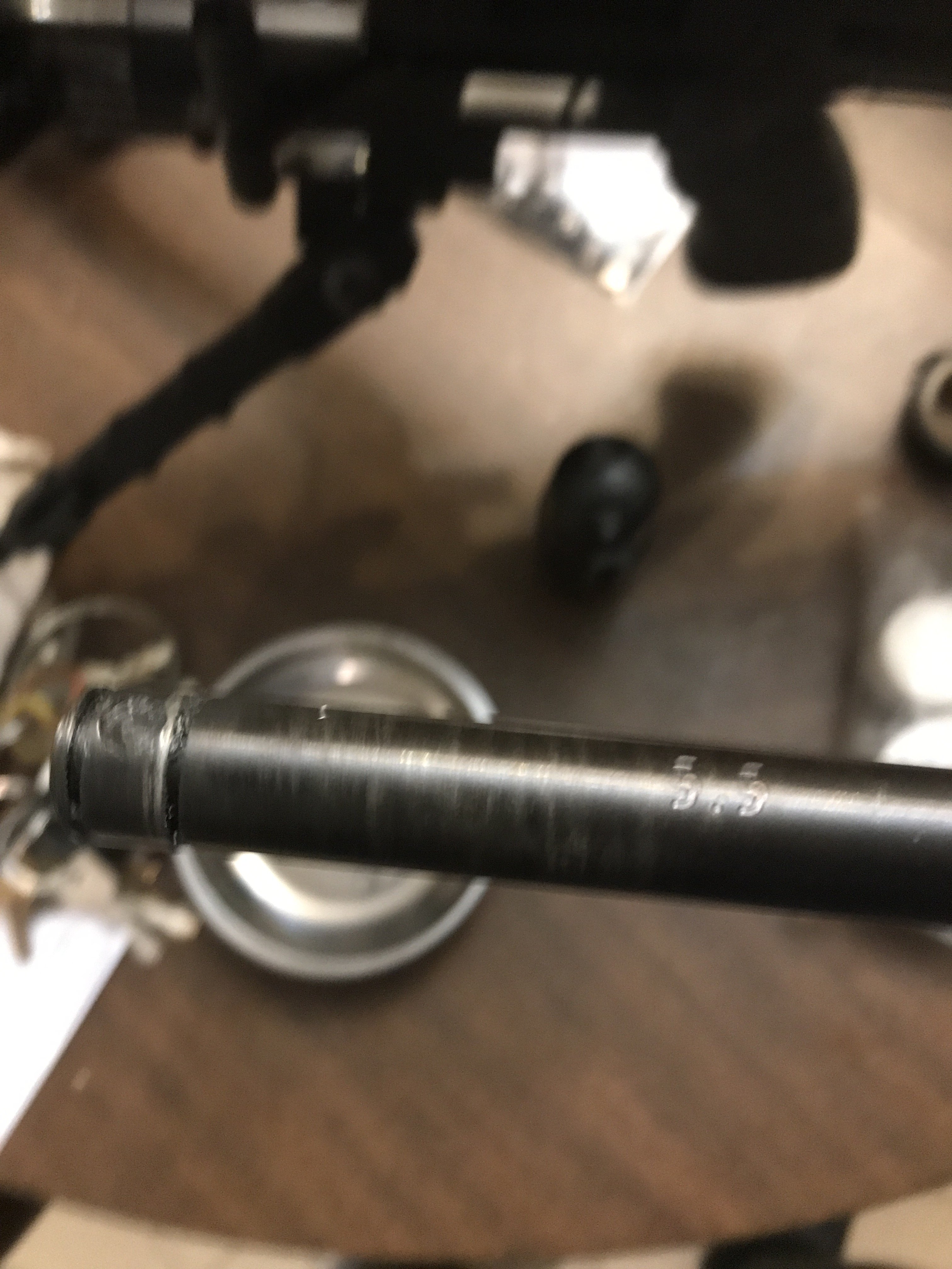

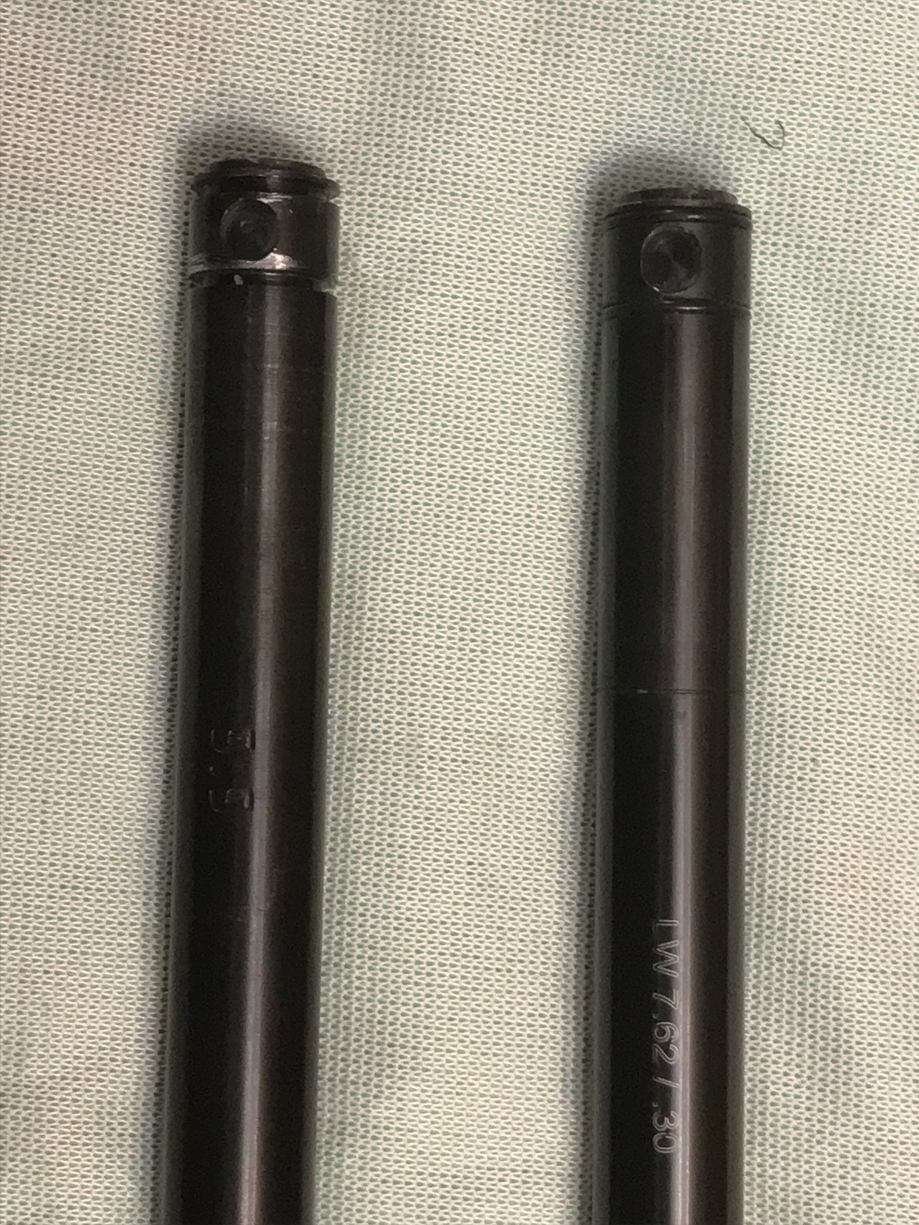

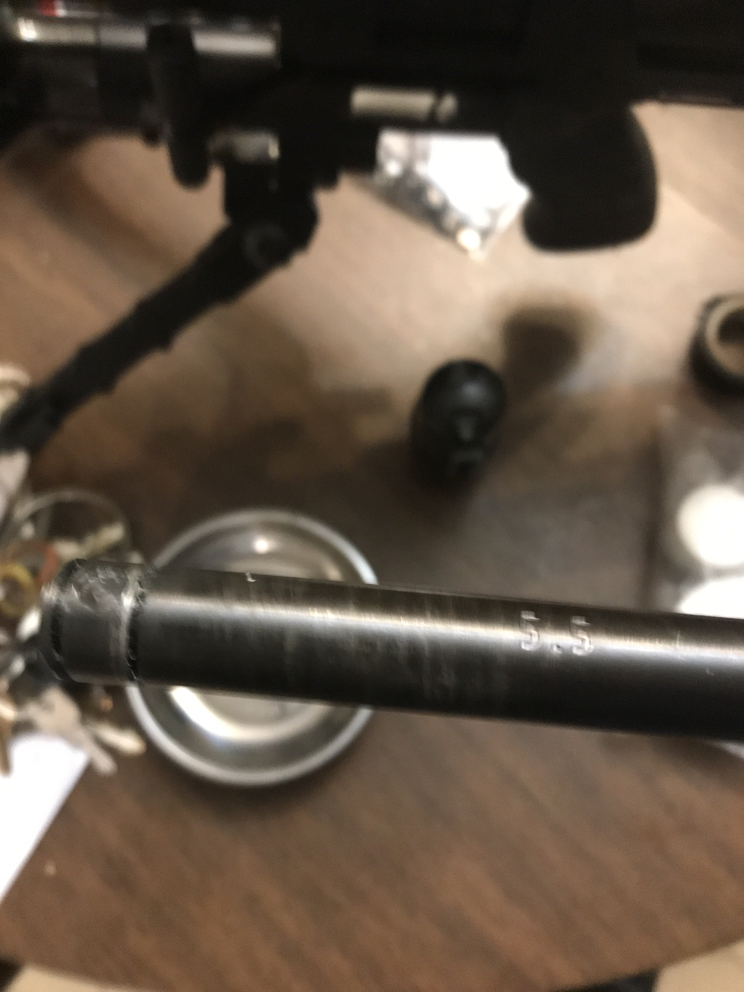

I got the barrel out with vice grips on the RTI tool and a lot of force, Scratch marks on the barrel by the two orings, A few metal shavings also very fine, I am not putting the barrel back in, Just way to tight..
Cleaned everything up and the 177 LW barrel snugged right in, I will see if I can post the pictures up tomorrow.

From what I can see I would check the TP hole and grub screw hole for any burrs. It only takes a couple thousandths between barrels to make one catch on something and one not. I would also take some calipers to both barrels and compare dimensions in a few key areas. That info in itself will give more credibility to the email you plan to send to Rok.

They did have a record of me just buying the Prophet PP II compact... I really need to proof read what I send , I did send more pictures of the barrel and told them I really do not want to sand it down with sand paper, Just not comfortable doing it. I could send the barrel back to them and let them take a look at it on my I would pay, They would be out nothing.

I just sent my 3ed Email to RTI , I informed them I would pay to ship the barrel back to them to take a look at it, I sent more pictures to show the marks on the barrel, I sure do not want to take sandpaper to the barrel, When I have to start fixing RTI problems it's when I stop buying their products.
