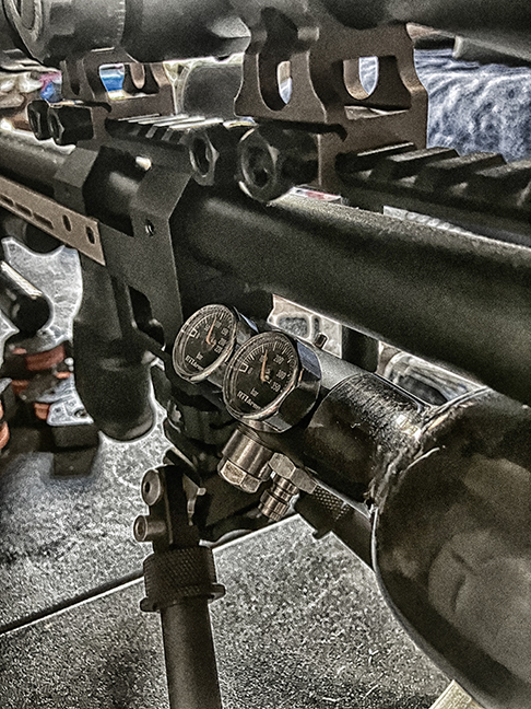

I degassed mine, rotated the bottle counterclockwise 45 degrees so that the gauges are more easily seen and so the fill port could be accessed easily while resting on the bipod.
Once rotated, I filled the gun and everything has been good from there on.View attachment 293589

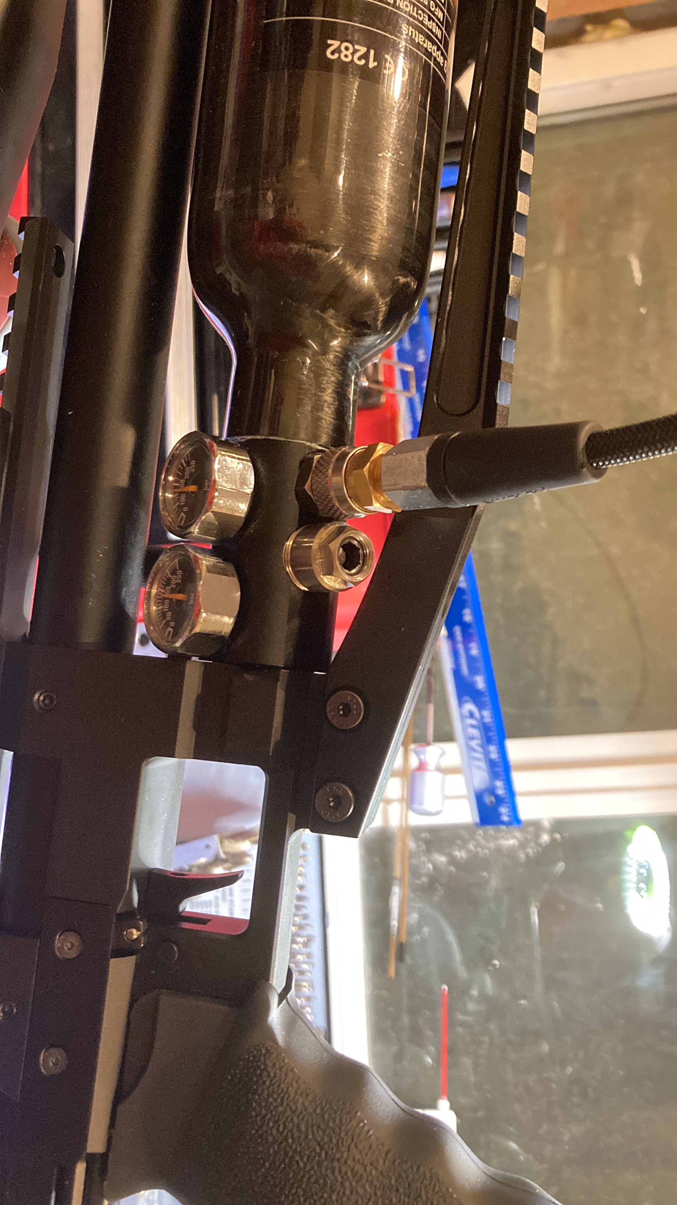

I. Did some thing very similar so I could us the Huma lower mount with any fill cord.
