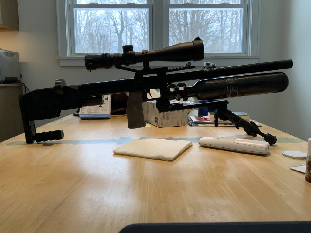

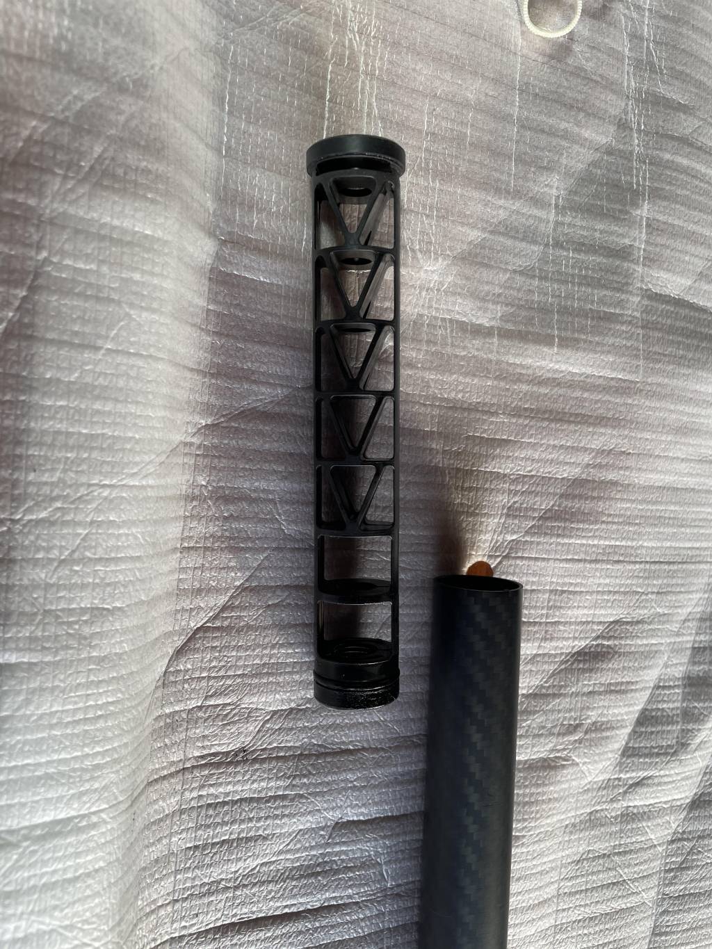

@harrymoreland, indeed you can. I have a 20” CZ barrel in my priest 2, and have added a one piece baffle in the shroud. Because I have a shorter shroud, I added a short piece of carbon tube as well, but with the longer performance shroud, it may fit without additional length. Gun measures around 30.5 inches now.
At least the earlier priests had a thinner material thickness with same outer diameter in the shroud. This means that there exists two different sizes of the "barrel end thingy" to match the respective inner diameters. Worth to know if your mixing barrels between priest and prophet.
