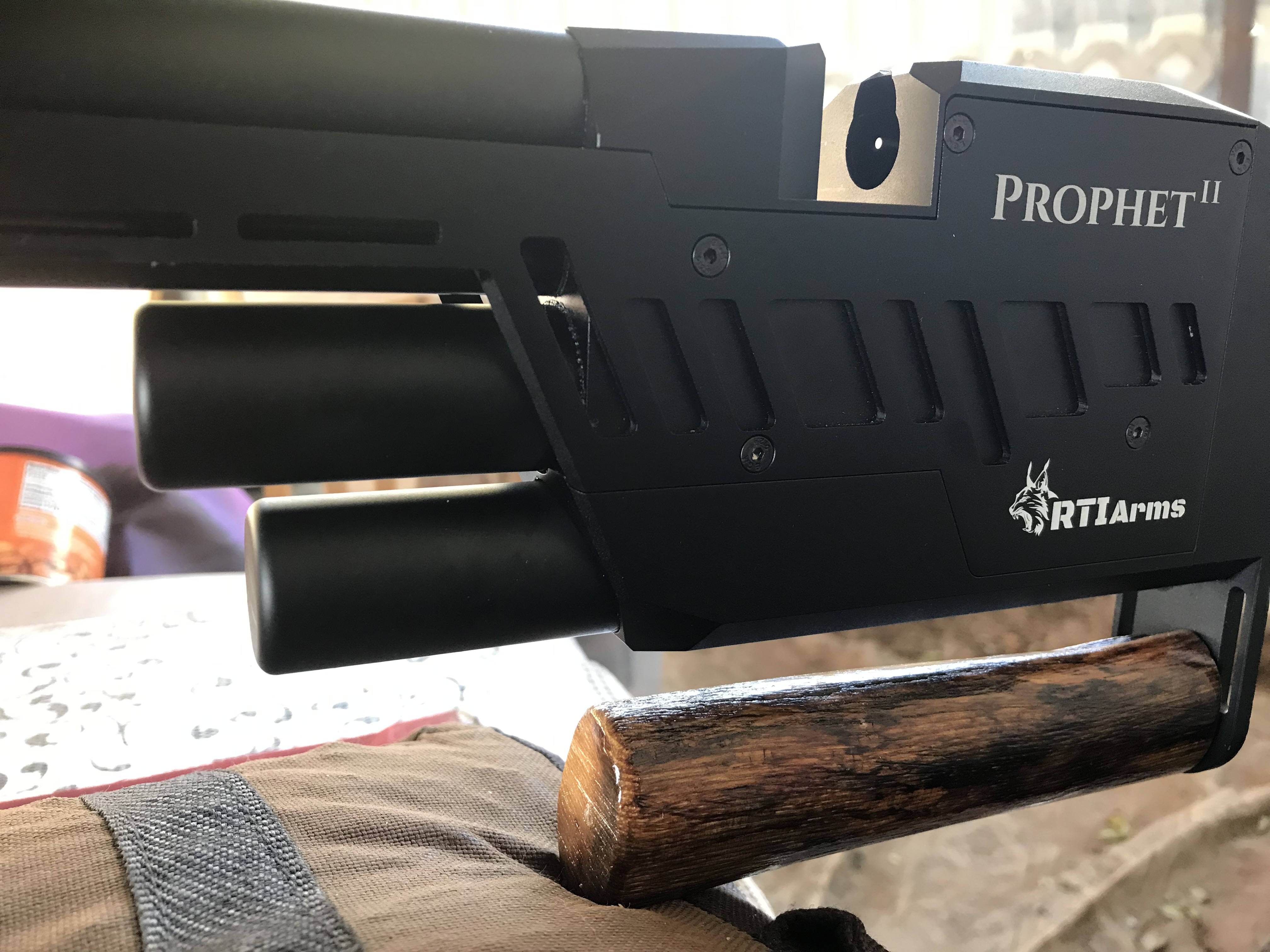

Speaking of fast shipping from RTIarms.shop... Wed. Nov. 30 I placed an order for everything needed to fully clothe the "Naked" Prophet II.
They had everything available and it is scheduled to arrive this Tuesday the 6th. Maybe start with the Butt plate & hammer spring and move forward.

Impressive shipping. From the EU to small town GA. in 6 days. Everything needed was packaged securely and arrived safely. Thank you RTI. It should not take long for the assembly. Bottle and Reg. went on in a few minutes. Barrel, shroud, rear plate, probe, scope rail, etc. are next. Fingers crossed it holds pressure without issue.

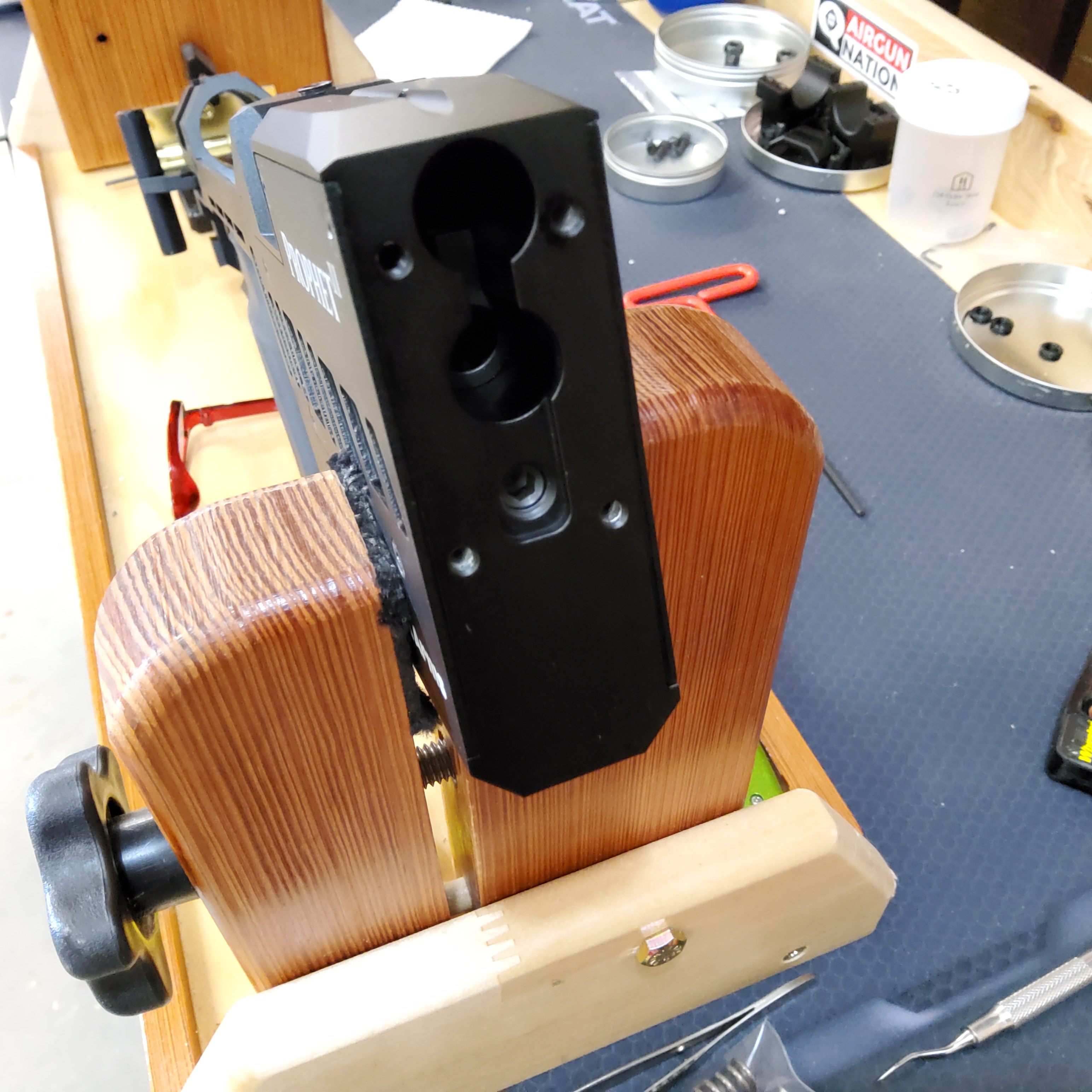

I have a similar issue with my PP1 compact.. it was originally a 25 and I have a 510mm 177 barrel I swap in... My reg will not go below 100b. Which still shoots 10gr pellets hot. the hammer spring adjustment screw has 2 threads sticking out the butt plate. I removed the aluminum spacer in the hammer and now at 100b I have a good range of adjustment in the 177.. I was able to get 880fps, it really tightened up the groups, uses less air and sounds much better.. When I swap in the 25 barrel I reinstall the spacer and up the reg..
I have a PP 1 that I had to modify the heavy hammer spring a bit to use for all calibers. The light or regular spring was turned down all the way to the bottom to barely get 810 fps with 18gr pellets at 180 bar on the .22 lr barrel. I could not even get the heavy spring flush to use even with a .30 caliber barrel in it and it was a bear to cock. I noticed that the heavy spring was longer than the regular spring so I cut it back to the same length and now it works great for all calibers.
