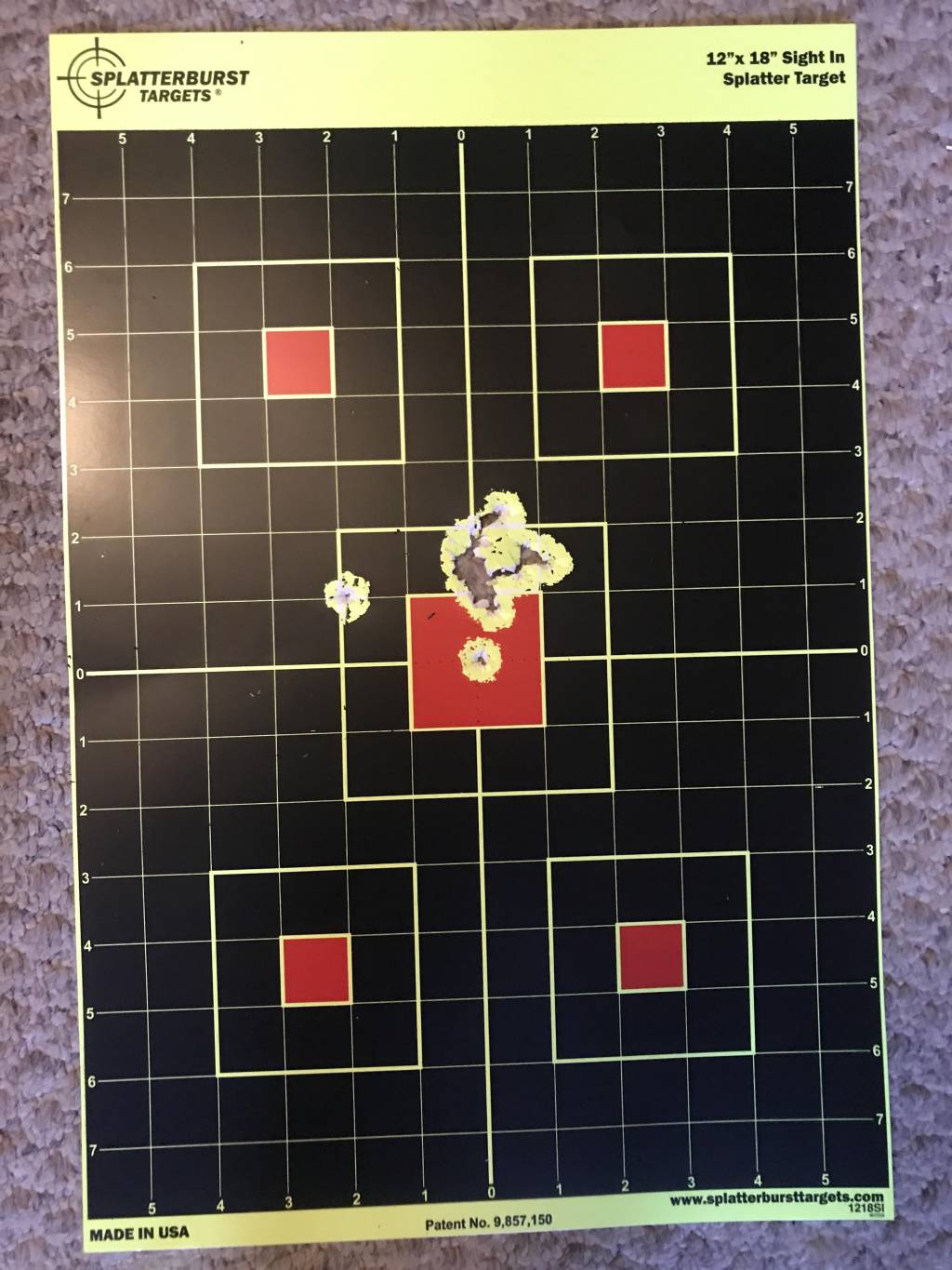

Dang, I keep hoping to find a hi power gun that I don't have to spend another grand on to make it dependable and accurate.
Perhaps I'm too hasty, if do, pardon me.
