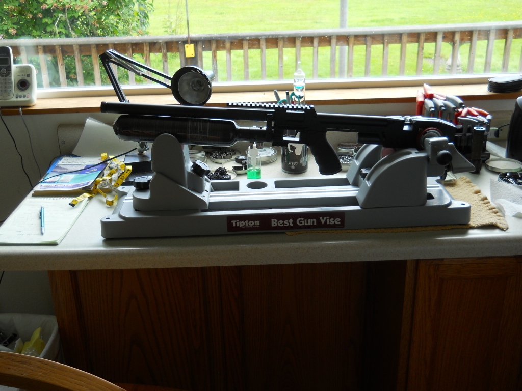

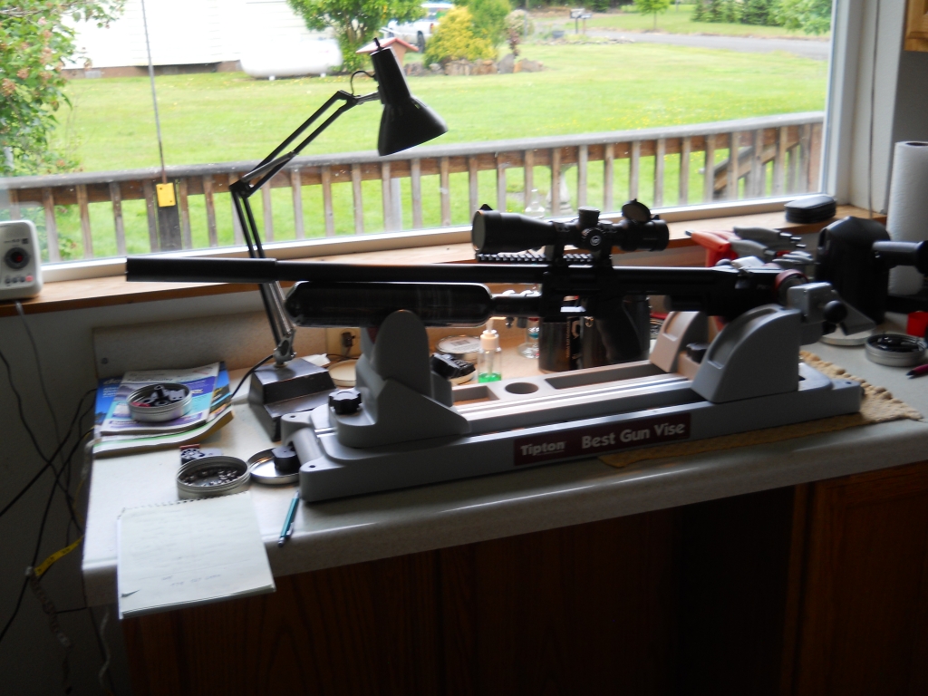

Well Vetmx...Didn't ask for your help. If everyone is hanging on my every word that's not desired nor is it purpose. This is not a REVIEW. It's my experience with the new rifle. It surely could have beem, "Jim I know what the problem is and here's how to fix it" rather than insensitive way you put it. I tried my own remedy. I put some graphite lube on the sides of the pellet casings and then rubbed it off with a clean cloth. I guess that minor lube got the .001" needed without moving the barrell.
After the thorough cleaning, and boy was it dirty, I am getting darn near hole in hole at 50. So who do you believe? A dealer distributor said it's better to break it in like a cast iron skillet and said don't clean it for a bit. That obviously was not good advice in this case. I am using splatter burst targets and it's so accurate that I am shooting at intersecting lines on the target rather than the larger red areas. It's raining so it might be hard to get out pesting unless I stay inside the barns

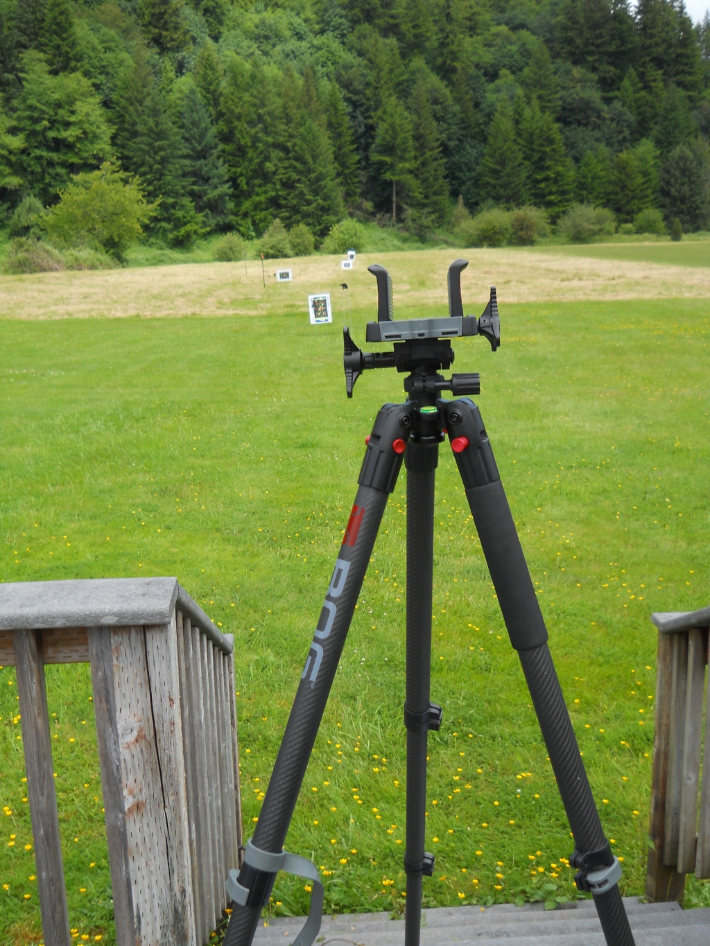

Today I field tested the Prophet. Sort of hid in a barn area with the Shockey Tripod. Was shooting everything from an English Sparrow to Collared Dove size. Ranges varied from 25 to 50 yds. The thing seems to shoot where I aim it. Went through two magazines and maybe only missed on 4 or 5 birds.The gun is working beautifully. The cocking lever is smooth, not Wildcat smooth, but is easy to manage. A not so obvious benefit is the magazine. Don't know how many times I have shot on an empty magazine of the round type. You can take it out and put it back in and the way it works the next cycle will have a pellet or if you are empty you just cant slide the bolt to lock. All the rest of the rifles I am shooting have the round magazines and when I take one out I am not sure when I put it back in if I have it in the right location to cycle a pellet next.
I shot and shot and shot. I have no idea how many shots you get on a fill, but the gauge didn't seem to go down very fast. A dealer I visited with said the shot count in .25 is supposed to be 90. I find that hard to believe but it seemed pretty air stingy. That #*1*+@?? stock arrangement. As i have said before the darn thing slips out of you shoulder. I am up for an after market fix for that. I would set the rifle on the tripod and start to line up on a target fussing with the scope and cheek weld and now I have to redo some part of all that as the plastic slipped out of my shoulder and is now in the crook of my elbow. If you had a bipod on it and were shooting off a bench it would be a useful design. Doesn't work worth a hoot for me.
I visited two permissions. I shot a lot at each and at the second one I left with targets still available. Learned about me and something I hadn't really considered. I became mentally fatigued. It was just getting to be an effort to hold a good sight picture, concetrate on trigger squeeze etc, I packed up an headed home. Texted the farmer and told him there were a lot of dead birds in and around his feed piles. Asked where I might dump them. He said you kill em I do the clean up. Gotta say a really nice benefit of pesting is getting to know and working with the farmers. Great folks in all 3 permissions.
