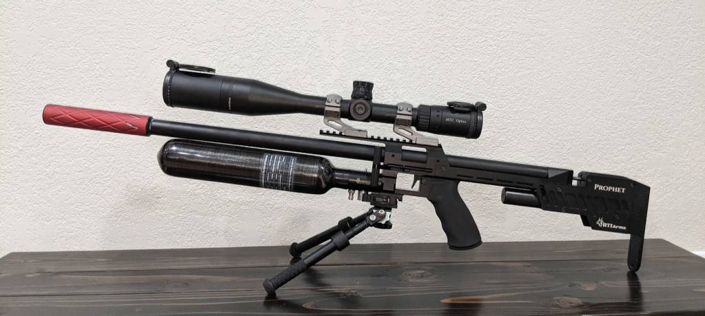

I didn't have much time to play with it today (still haven't shot it) but got a scope on there real late tonight.
Dug through the random stuff drawers and came up with these UTG offset mounts. Pretty sure they're meant to be used with the offset pointing the other direction but this works (right height, right eye relief, right tube diameter orings, etc) And, yeah, got some color clashing going on here with the gray mounts, red moderator, and black gun, but, we all mostly care about how it shoots so.....it'll do.
So...........the ventral pic rail only has four slots. I'm not a heavy bench shooter, but what little I've done has been with guns that have the ability to have the bipod further forward. I can see why guys attach those pic extensions to get that rail moved up, or even the bottle pic adaptor thingamabobs. If it was my gun, I'd be looking into some sort of extension for the pic rail, but, I'll shoot it as-is and see how it does. Just logical that the further forward those bipod feet end up, the greater stability offered by the set-up.

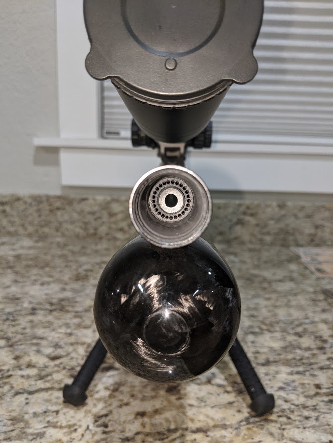

Pulled off the moderator to stick it back in that cool little case and the shroud end cap came too........okay, good opportunity to check out the inside.
Quite a few holes in there to allow airflow back into the shroud for sound dampening.
Also, looks like just a bit over two inches of dead space between the end of the shroud and the end of the barrel.

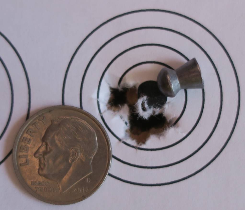

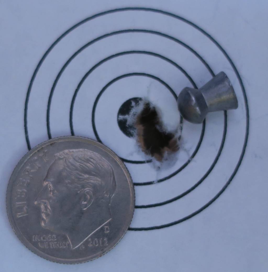

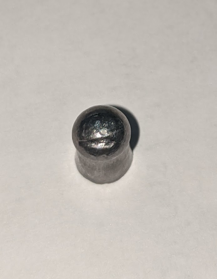

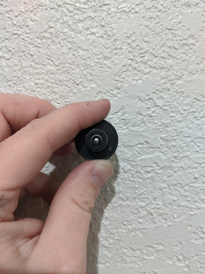

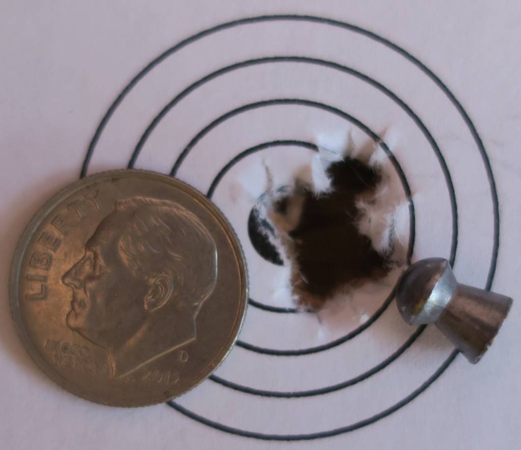

Went to put the endcap back on and did a double take on the size of the hole. Decided to grab this pic, a JSB 25.4gr Monster RD randomly grabbed from a nearly full tin and set inside the end cap.
I titled this file "FAITH." Man o man, those RTI guys have some serious confidence that everything is going to line up okay. That is a mighty small hole for what's going on here. VERY little wiggle room to keep that potentially 85fpe pellet from making a real ugly mess out of this aluminum endcap.
Also, check out the veritable DIVOT of missing lead from the head of this unfired, straight-from-the-tin pellet. No wonder we're chasing our tails trying to shoot tight groups at 100 yards.

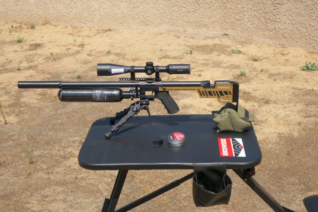

O.K., was able to shoot some groups this afternoon (25 yards). Weather was about 68 degF, sunny with a very light breeze. Shot off a bipod at the front, and bag at the rear. All shot with the magazine (do these guns even have single shot trays?) My little backyard shooting table setup is pictured below. Scope is a Hawke Vantage 6-24x44. Pellets were JSB Exact Jumbo Heavy Diabolo 18.13 gr, unsorted right out of the tin.
I shot from a full 300 Bar bottle charge down to just over 150 Bar. Chrono numbers (FX Pocket Chronograph) were obtained first. Based on these (and the fact that the gun seemed to calm down a bit towards the last couple of magazines shot), I think that I want to reduce the regulator pressure a bit.
A little about me: I have been shooting for a long time, but have never done any formal precision benchrest shooting before. The near total shooting I've been doing in the last 4 years is Cowboy Action Shooting - a very different discipline. I've been shooting air rifles 'regularly' for about the last 1.5 months or so, since my interest in them was recently re-kindled (D@mn you Steve Scialli). I probably don't have any habits yet (good or bad), nor any real form/consistency. So take my comments below with the fact that they are coming from a raw newbie.
Finally, this is a new-to-me used gun which I have had for about 24 hours, about which I know absolutely none of its history. I haven't even checked/cleaned the barrel yet.
With that overview, I find that the Prophet can shoot well (as far as I am concerned, knowing my current capabilities), but it was difficult for me to do so. I don't find it to be as easy to shoot or as forgiving off the bench as some other rifles I have. If you do all of your part it will reward you. If you don't... well I had some pretty messy groups which I'm not showing!

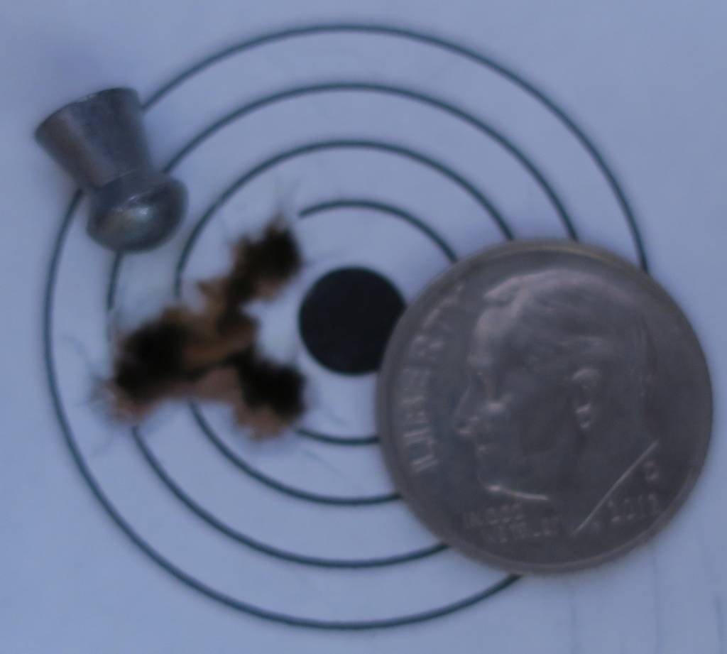

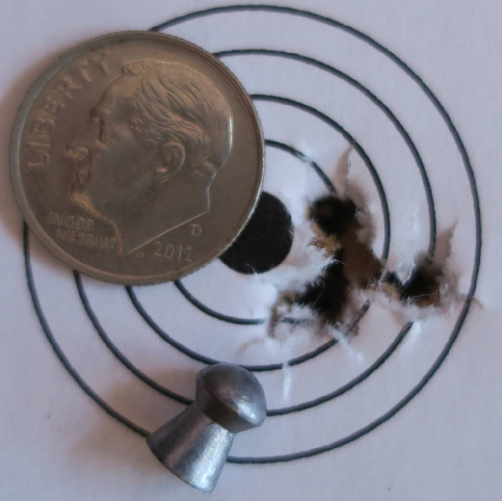

The best groups I was able to obtain (25 yards/5 shot groups) are below.
Nice little rifle. I won't use for benchrest as I have other tools, but with its weight distribution, overall light weight and good power should be good for squirrel control at the range!

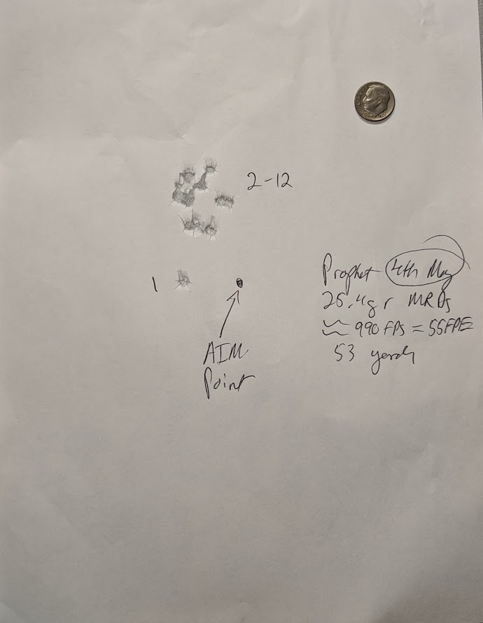

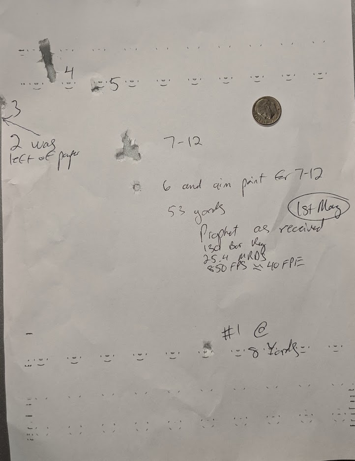

The shots from the first mag, on paper. Shots numbered. First 1 was at 8 yards to make sure I'd hit paper (and I still missed paper at 53 yards on shot #2). Everything else shot tonight was at 53 yards.
I was cranking on scope turrets to get things about centered in the piece of paper here, so a little busy. Once I started using shot #6 as my aim point, 7-12 grouped in there pretty nice. I was surprised to see them group so well, as the rear of the gun was just floating around and I wasn't very steady. After this first mag I put a bag under the rear of the rest and was much more stable.
at 40fpe with 25.4gr it was very quiet.

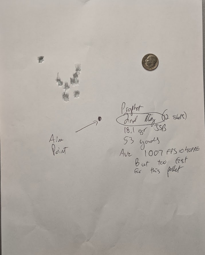

Okay, so it's is too slow for the 25.4s, let's try the JSB 18.1. Settings have still not been touched.
1012.6
1003.4
1010.2
1020
1014
1011.1
1003.9
error
1005.6
1004.3
error
Still about 40fpe with these 18.1s, but WAY too fast. The group doesn't look bad, but there were a couple of these that hit high and left (not on the paper). There was still enough light at this point to see that the pellets weren't hitting where the crosshairs were when the trigger broke. Group looks good, but I wasn't impressed with what I was seeing through the scope in regards to pellets hitting where they should have been. TOO FAST for 18.1s.
shots from second mag:

so now we're talking at about 55fpe
bottle pressure went from 250-210 bar, the biggest decrease in a single mag that I've seen yet-it didn't feel like it was blasting too much extra air, but I don't like that kind of efficiency and will usually trade off energy for more shots
shots from mag #4 (starting to get really dark and hard to see the aim point in the scope at 53 yards.....)
(12 from mag with 25.4 MRDs)
hmmm, accuracy isn't bad for a blind guy in the dark such as myself.....

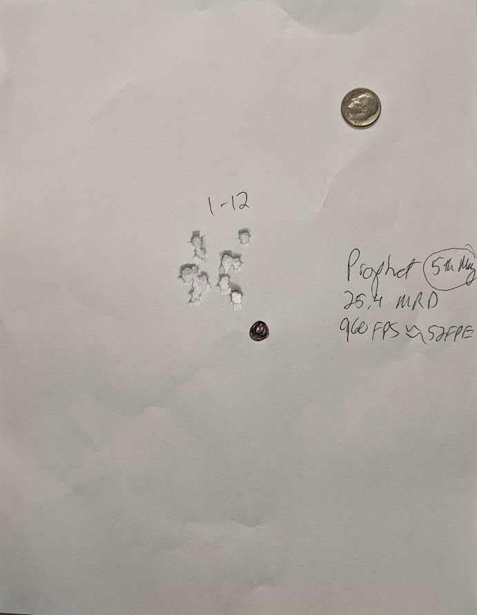

Mag # 5
I didn't like to see that bottle pressure drop so fast so I left the regulator at 160 bar, but backed out the hammer tension 1/2 revolution
Still shooting the MRDs here
I didn't record all of the individual shot's fps on this mag, but they were all in the 950-960fps range
Pressure for these 12 shots went from 210-190 bar
shots from mag #5
